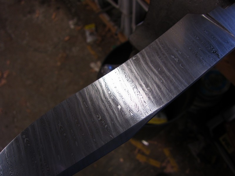

Phillip Patton Posted February 28, 2011 Author Share Posted February 28, 2011 wow! so so cool. beautiful - thanks for all the photos:) You're welcome. Thanks everyone for your comments! Here's what I've got done so far today: Hand sanded the blade to 400 grit: Here it is after etching for 10 minutes: Then I sand the blade with 800 grit paper: Then etch 10 more minutes and sand with 1000 grit paper: Quote Link to comment Share on other sites More sharing options...
Luke Shearer Posted March 1, 2011 Share Posted March 1, 2011 Ah, wow ,nice chatoyance. Nice welding too. Quote Link to comment Share on other sites More sharing options...

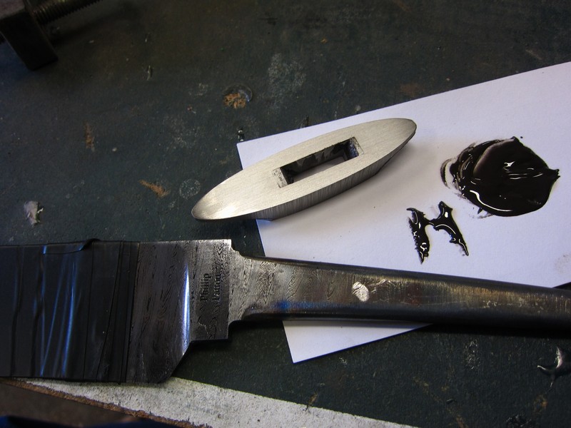

Phillip Patton Posted March 1, 2011 Author Share Posted March 1, 2011 Ok, I etched the blade a total of three times for 10 minutes each. After the third etch, I rubbed the blade with the used 1000 grit paper from before, and then buffed it very carefully with green compound. It's easy to wash out the grind lines with the buffer. Also, the buffing compound tends to stick to a cold blade, so I warmed it (the blade) up on my wood stove first. It turned out pretty well. The buffer really brings out the chatoyance: After cleaning the compound off with Goo Gone, I lightly oil the blade and then wrap with electricians tape: Now for fitting the guard. I'm using 416 for this one: I grind it clean and flat on the disc sander, then coat one side with layout dye, then lay out the holes that will start the slot: Holes drilled: Webbing removed with a round file: Squaring up the slot: Just about there: Close enough: Now I peen the edges of the slot. This guarantees a tight, gap free fit. Quote Link to comment Share on other sites More sharing options...

Phillip Patton Posted March 1, 2011 Author Share Posted March 1, 2011 Now I grind the "face" of the guard clean, sand it to 240 grit, then finish it with a Scotchbrite belt: Now I grind the corners of the tang round, and soften it with the torch so I can drill through it later: After it cools, I clean the tang with acetone, and mix up some J-B Kwik: After cleaning the excess off: After all that, I decided I wasn't happy with the fit of the guard, (actually, there was a ding on one of the edges of the slot) so I pulled it off before the J-B Weld could set up. I'll clean everything up and fix it after lunch. Quote Link to comment Share on other sites More sharing options...
Phillip Patton Posted March 1, 2011 Author Share Posted March 1, 2011 Well, I got the guard re-fitted. It's now as close to perfect as I can get it. If it looks like there's gaps, it's just the damascus pattern on the ricasso. After letting the J-B Weld harden for a half hour or so, it's time to take the guard clamping jig off and start fitting the handle. First I cut the end of the block to the correct angle. The surface exposed by cutting had some voids. I hope they don't get bigger.... Then I drew the pattern of the handle onto the block of ironwood: Then drew the outline of the tang in the correct location: Then transfer the lines to the end and draw a centerline. Then locate the three holes that will be drilled to make the slot: Mark the holes with a punch: Then drill them: Quote Link to comment Share on other sites More sharing options...
