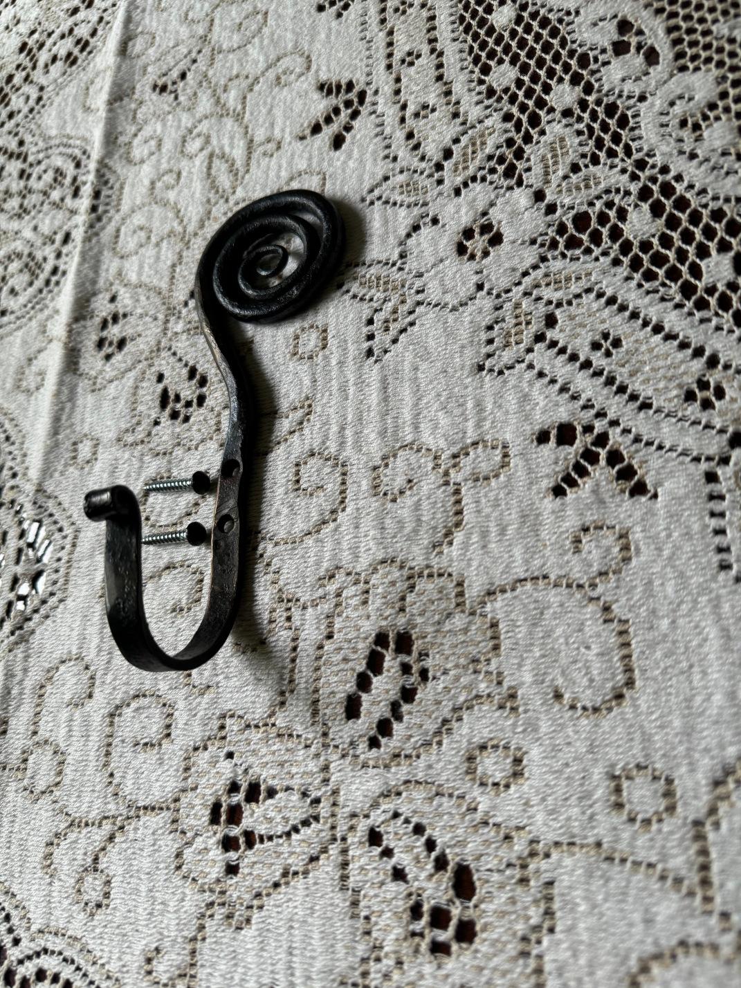

  4. Meh. The hook is just "OK." I ventured into a chiselled design and, yet again, made it too long. However, there is always tomorrow. The sword is something I made in 2018 out of 1085. - Paul
  5. Just so. I did a lot of trial and error on the screw holes and came up with the same solution. I had to "sacrifice" a good centre punch to make the rounded one. The slight bulge is indeed eye-catching. I always learn by trial and error. My wife calls the ones with the long shank to the hook "giraffe hooks." I think she is on to something. :-) A couple of days ago, I acquired two old car coil springs. I annealed a section about 10 inches long overnight. Today, I'm going to make it into a punch to replace the one I made into a rounded one. Then quench and temper it. - Paul
  6. Yesterday, I took your advice and made a stubbier hook, and I think it looks better. Is this close to what you suggested?

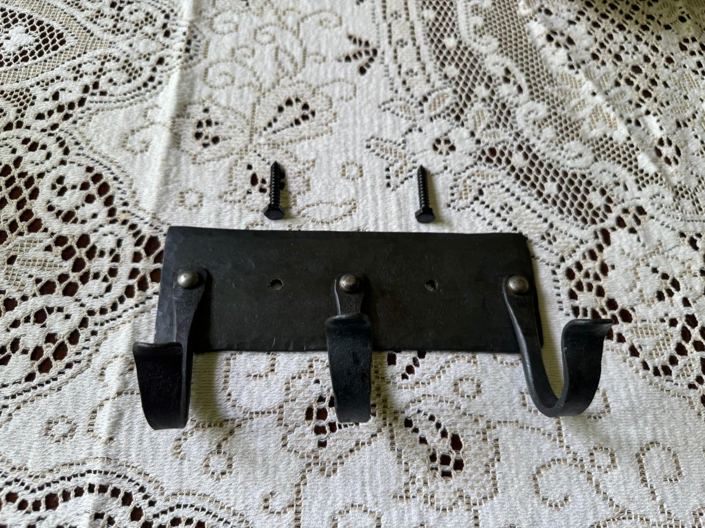

  8. A neighbour gave me some "steel" he salvaged from an old table saw. I was suspicious of the metal; I thought it was cast. I cut a piece off and made it into a back plate for a three-item coat hook. It's a joy to work hot, but when I tried to rivet it - CRACK! Looking at the coarse grain, I see why. I took a piece of mild steel and finished the project, and it's OK. The question I have for the gurus is, what do I do with this table saw mystery metal? I think it's cast iron, but I don't know how to tell. Whatever it is, it works well when hot, drills nicely, etc. Is the best guess, looking at the photos, that it is cast iron? I have no idea how old it is, but I'm pretty sure it's not from the 21st century. - Paul

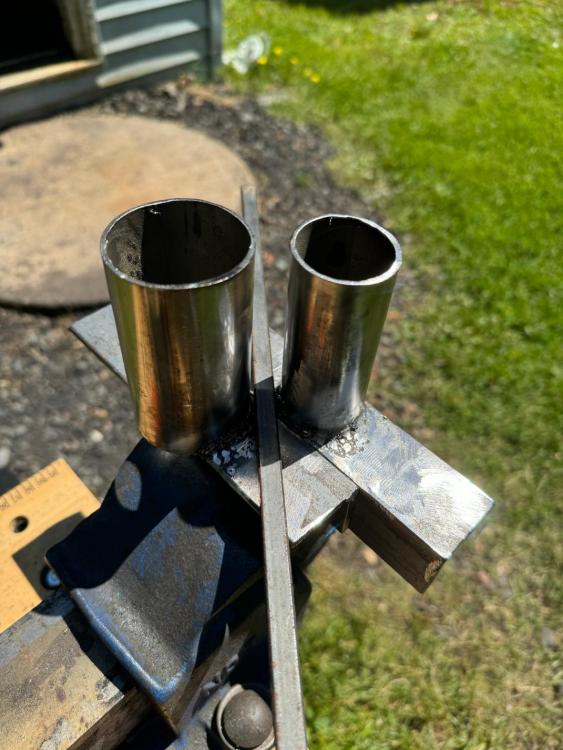

  11. Thanks for the idea, JHCC. I did just that yesterday after reading your suggestion. It might have been OK as it was, but Murphy's Law suggests it would have broken off when I needed it the most. I appreciate the feedback from those with the experience and wisdom I lack! :-) This is a bit "top-heavy" looking, but it's my first attempt at scrolling. I think the next one will be better. Practice makes perfect (or at least better than the last time.) - Paul
  12. Beautiful work, JHCC. I was lucky enough to visit the Azores 12 years ago, and I bought those style tiles for my amateur radio call sign VE1DX. Now I have an idea how to display them. I made a "universal" bending jig today. Unfortunately, all I could find was tubing, not thick-walled pipe. It'll do for small things, but I need something stronger long-term. - Paul
