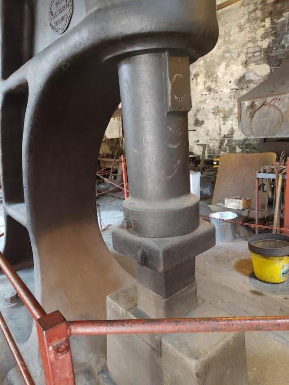

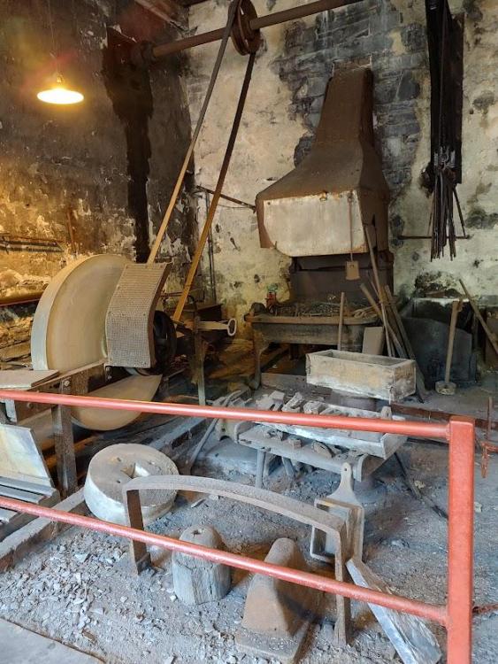

  2. I had the pleasure of spending a few hours at the Welsh national slate museum this weekend. I didn't expect to see such a fantastic forge there, as well as a remarkable foundry (no longer in use), wood yard, and all the other crafts needed for a fully functional slate quarry & factory to be self sufficient over 100 years ago. This included a shop to repair their own small gauge trains. I only got a few pics, but thought a few of you here may be interested. I've put the main pic up there as a reference; The large rectangular tower with the red tank is the water wheel - this drives a jack shaft that powers everything in the entire complex. the shaft runs the entire length of the metal shops, foundry and forge (all contained in the long, low, run of building with many chimneys) and via a bevel gear, runs along the wood shops, and repair shops along in the buildings next to the waterwheel. Phenomenal. you can see the water wheel through the port at the top of the pic; Foundry; The bevel gear; One of several power hammers, all run off the jack shaft; 4 forges, and many, many post vices. Hope you all like the pics.

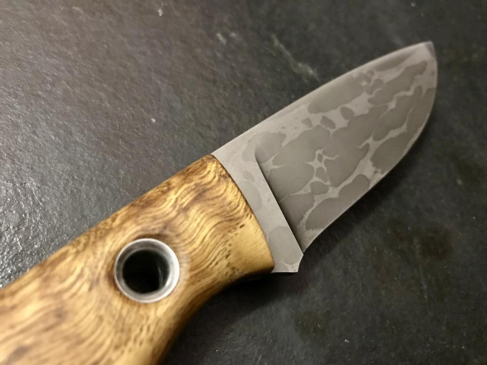

  20. Full tang bushcraft blade, ball bearing canister damascus (6mm 52100 bearings & 1095 powder), curly oak handle, 8mm flared stainless tube pins. 3.5" blade, 8.0" overall. Weight; 137g. Super happy with this, the even and sharp bevels in particular. No hydraulic press, no power hammer.
