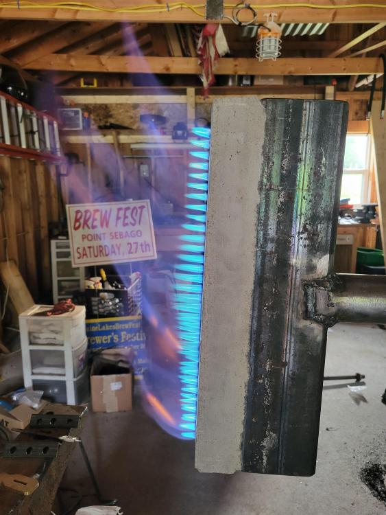

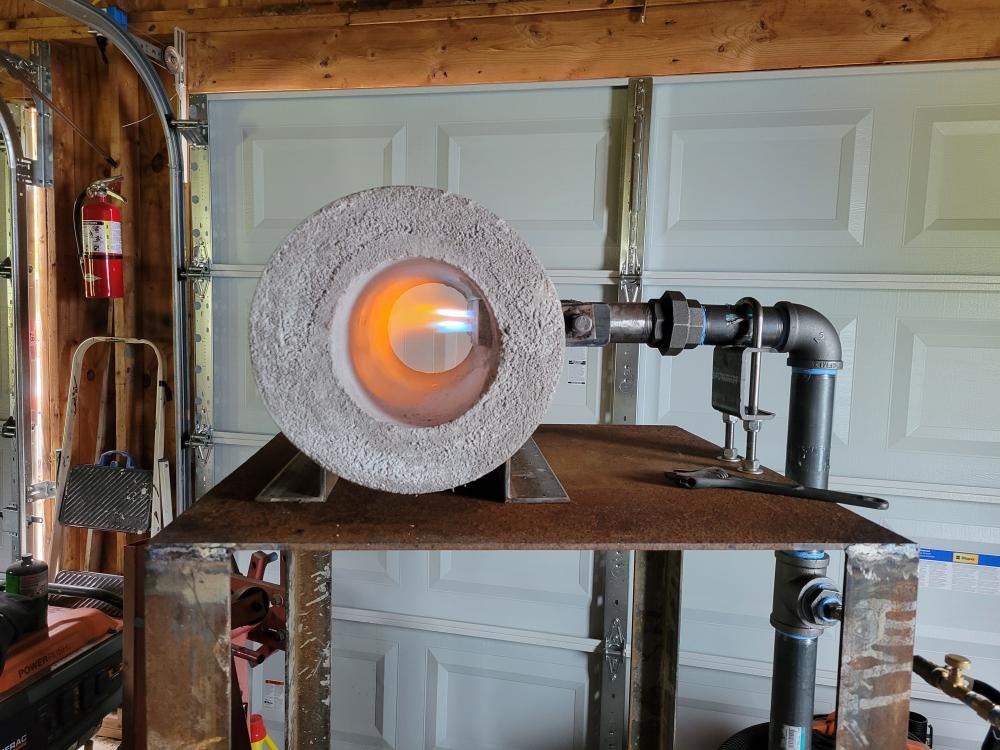

I played with it a bit, only fired it the one time so far, definitely not dialed in, but saw in excess of 1800°F with no doors on. I have it coated with ITC 100 now and curing, so next weekend I'll get it dialed in. It had pretty even flame and it ran great at 1psi. Looking forward to breaking it in!

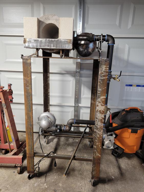

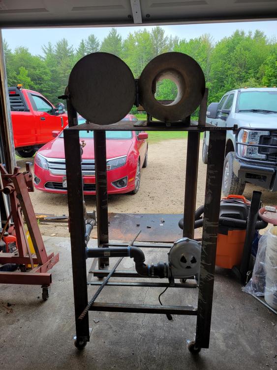

Welded up a hinge for the rear door, and lined it with ceramic wool then Castolite, it's curing. I think for the front I'll weld on a piece of angle iron and use soft fire brick for the door. It's coming along!

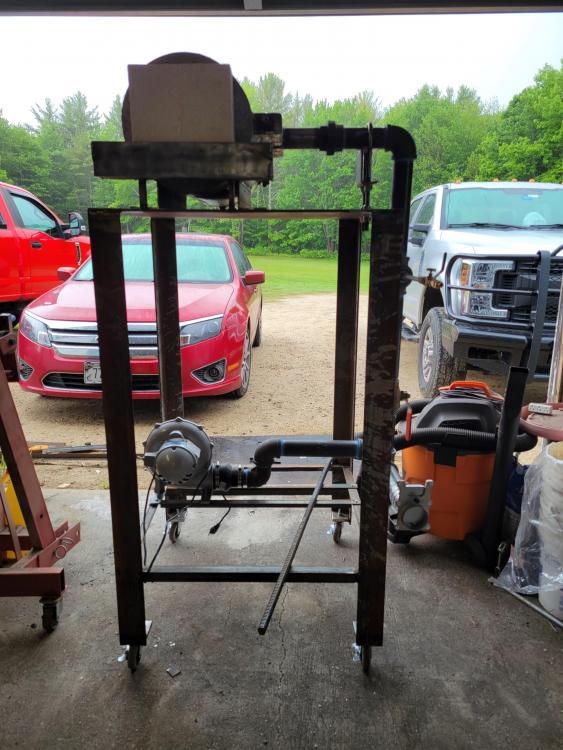

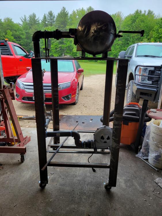

Press is finished!
*I am not a pro* I *JUST* rebuilt my forge press, including a couple new hoses due to repositioned tank and pump/motor. All I did was double-check all connections were tight, filled the tank, turned it on and let it run for a minute until the sound was even/consistent. Then I moved the ram up and down full length of it, probably 3-4 times, letting it rest for a few seconds at the end of the run. Topped off the tank, 90% full. It's working great.

Truthfully I didn't want to play with it too much , I just wanted to make sure it will run, I have too much air, so I'm debating adding a "T" with another gate to bleed off air so I don't burn out the blower. But I wanted to make sure it will work before installing it into the forge. This weekend I will be welding up the stand for the forge and firing it up for the first time. Ended up not getting as much of an angle as I wanted for the burner the way it set, but I believe it will work as is.

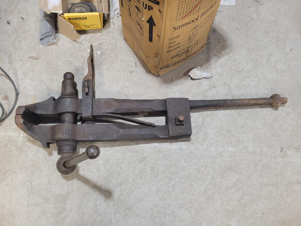

That's a brilliant idea Charles... I may very well do that after I get an initial stand setup and mounted! Thomas, I posted both because people refer to them as either/both Post/Leg Vise. And as far as another thread, I spent quite a bit of time looking through them, and found very few pictures. And I've found the mods to be touchy about people digging up old posts, so instead of doing that I figured I would make my own. I *DO* like the idea of having it attacked to a water barrel, but I don't really need that much water in my garage, lol, maybe if I had more space!

My leading "plan" (if you can call it that is this: I have a 3/8" plate that is 24"x24" to be used as the base, and I'd take an old I-Beam I have, and mount it vertically on the back 1/3rd of the plate with a smaller plate on top to mount the vise too, then weld a smaller plate to the base plate with a hole in it for the post leg. This should give me enough space on it to be able to stand on it for twisting/wrenching on the work, while a large enough base to also be relatively stable. Also thinking about welding up a couple fixed casters to the back so I can tilt it backwards and move it around in the garage. They would be angled so they only roll when you tilt the whole contraption. (In red.) I also have a lot of big angle Iron I could use if needed to add to the structural integrity. Please forgive my MS Paint artistry, lol

Finally found one in good condition, it has 5" jaws and is a big sucker, in excellent condition! I'm honestly lost when it comes to mounting it tho, I don't want to mount it on my workbench, it's too far from the forge and press, that said, it's a tossup on which I want more..... stability or portability. If you have pics of your setup, please share! Wood, metal, and/ or concrete all at my disposal.

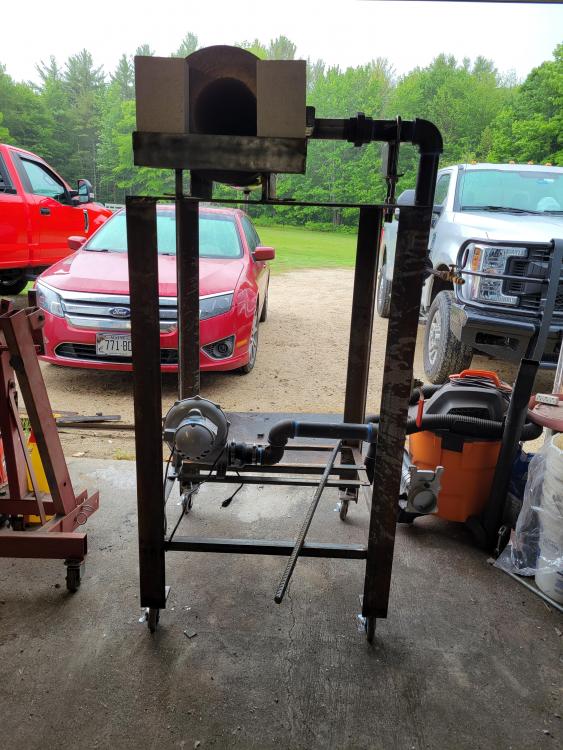

Longest I've seen is 14", but they had 3 rows of holes. I'm hoping the smaller holes will allow enough pressure to build to fill the whole chamber and distribute it evenly. It's an experiment, for sure! lol

Yeah, I suppose I should have spent an extra minute getting the model square.... I was more demonstrating where they get placed versus how deep, so my bad on that, I would have the burner face flush with the inner casting as well. I do have the burner cast. Of course, this is all experimental, taken from firsthand experience; advice; and research all discombobulated into what my brain filters into a myriad of confusing information, lol The burner is long, but skinny. I'm hoping the increased air flow from my blower will compensate for the distance the air/gas mixture needs to travel. I have a 3"/272cfm Forge blower, and a long 2" pipe with baffle to mix the gas mixture. The way I look at it is even if I need to run it at 4psi it's still running on 1/3 less pressure than my (venturi-style) small forge does.

So I finally have a burner cast, and the rest of the supplies for the forge are finally in..... took a month to get a bag of Castolite, lol Anywho, the last thing I can't decide on is the orientation of the burner. I have seen these 3 in 99% of the forges out there. (A, B, or C) B seems to be the best option, as it is the least likely to blow directly on your work, however it would be the hardest to cut and cast into the forge body. NOT LOOKING for debate as to the size of the forge. This is strictly about the orientation of the burner.

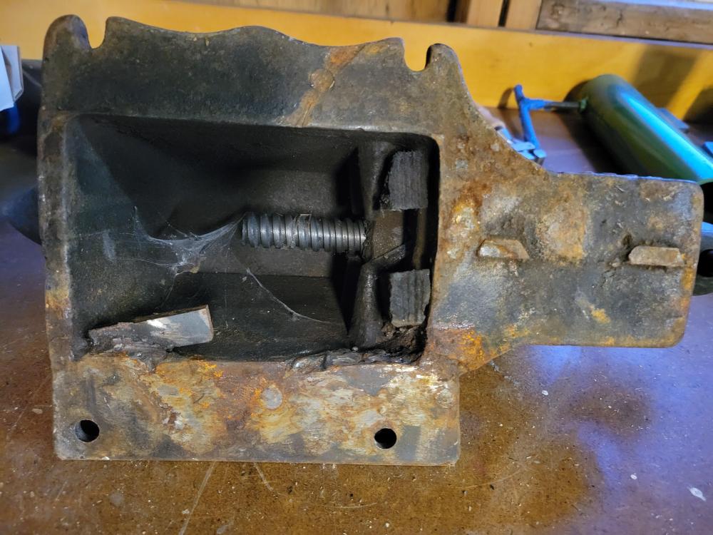

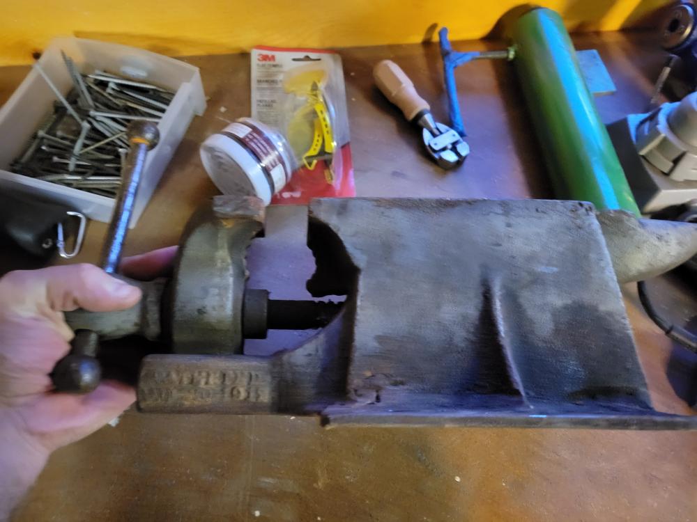

Mini-Anvil Vice

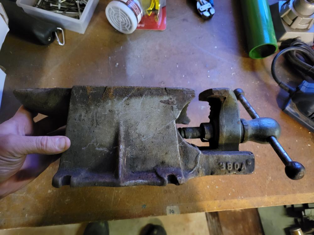

https://patents.google.com/patent/US1036155A/en
Mini-Anvil Vice
I have not If I get a chance to clean it up I'll check the patent number on it, but it looks to be the same as the one in this video.

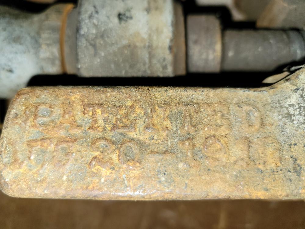

Picked up a Hay Budden
It has been, good eye Goods. The last 3" or so was repaired with hard welding rod. But it was part of a package deal, and although I haven't done much to it it seems to rebound very well.

Mini-Anvil Vice
So don't blast it with the 10lb? Lol I saw that, I just thought it was neat and figured I'd share. You can actually see where someone DID hit it with something big and did a poor job fixing it. I have some hard welding rod and was thinking about cleaning it up a bit. It's a neat piece.
I'm pretty exited, no modifications planned except securing it to a log well and wrapping a chain.... she's loud, lol
