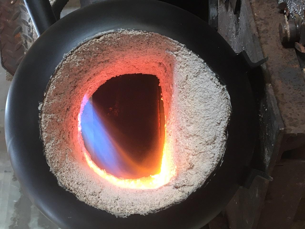

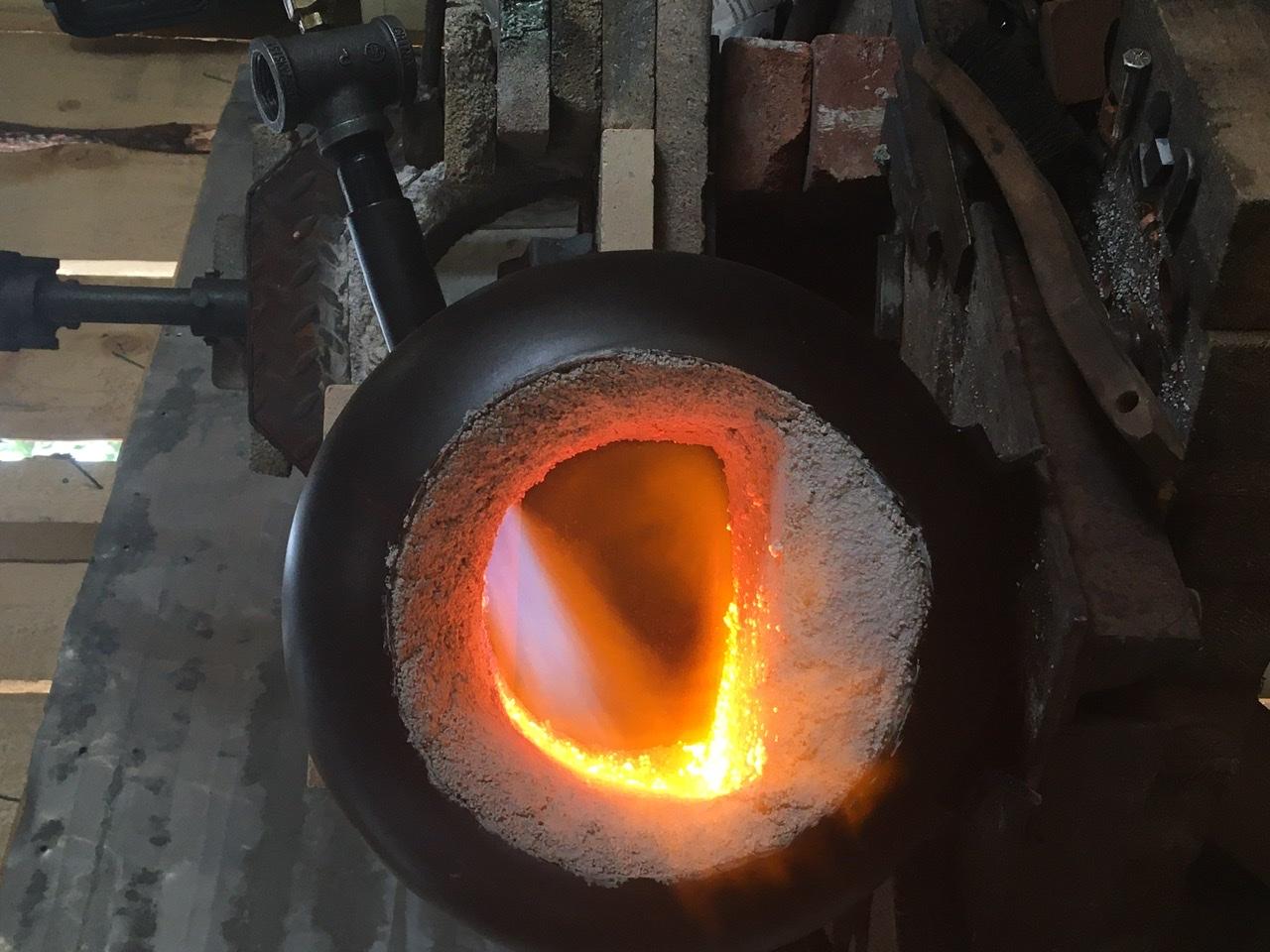

  17. Ahhhh and there we have it! I have infact been completely mixed up this entire time!! uuuugh.... well now I know. Thanks Thomas! This is a game changer for me.
  18. Well.. Im stumped... Im starting to think that I have just been getting lucky with tuning and dont actually get what I thought I was starting to sort of barely get... I forged out a quick blacksmiths knife on monday just to finish off the drying of the Kastolite and decided to tune the burner today because this one is causing a lot of scale as is. So yall seen the pics I first posted. Well I started filing back the .035 tip a little (like 1/32 - 1/16) at a time... no visible change In the flame! DISCLAIMER!! OBVIOUSLY DO NOT TRY THIS!!! So I got curious and I unscrewed the fitting holding the tip. Yes I completely understand the stupidity in this. Anyway, I pulled the tip back... and back... and back! It was just out of the T before it stopped inducing enough O2 to burn. Thats obviously the millisecond my hand on the ball valve cut the propane supply. This was all around forging psi. I dont have a gauge sorry but id guess around 10 psi. Obviously my hands were to busy to snap pics... but there was no real change in the flame. This baffles me because Ive read all these posts on tuning and lots of times it seems that when people trim to far it just wont burn! Thats not the case here. What in the world is going on here?!? So I started over with an .030 tip just to see. It was far more stable a flame at the extreme low psi, like 1/4 turn from off on my 30psi regulator, but it induces more air I would expect. I tried it up to full pressure and worked fine with no trimming. Heres photos of almost off, about 10-15 psi (middle of regulator) and full blast: But, as I dont want more oxygen and will never run that low of psi I will put the .035 tip back in I think. Im stumped as to why this thing burns so easily but seems not to change when changes are made!?
