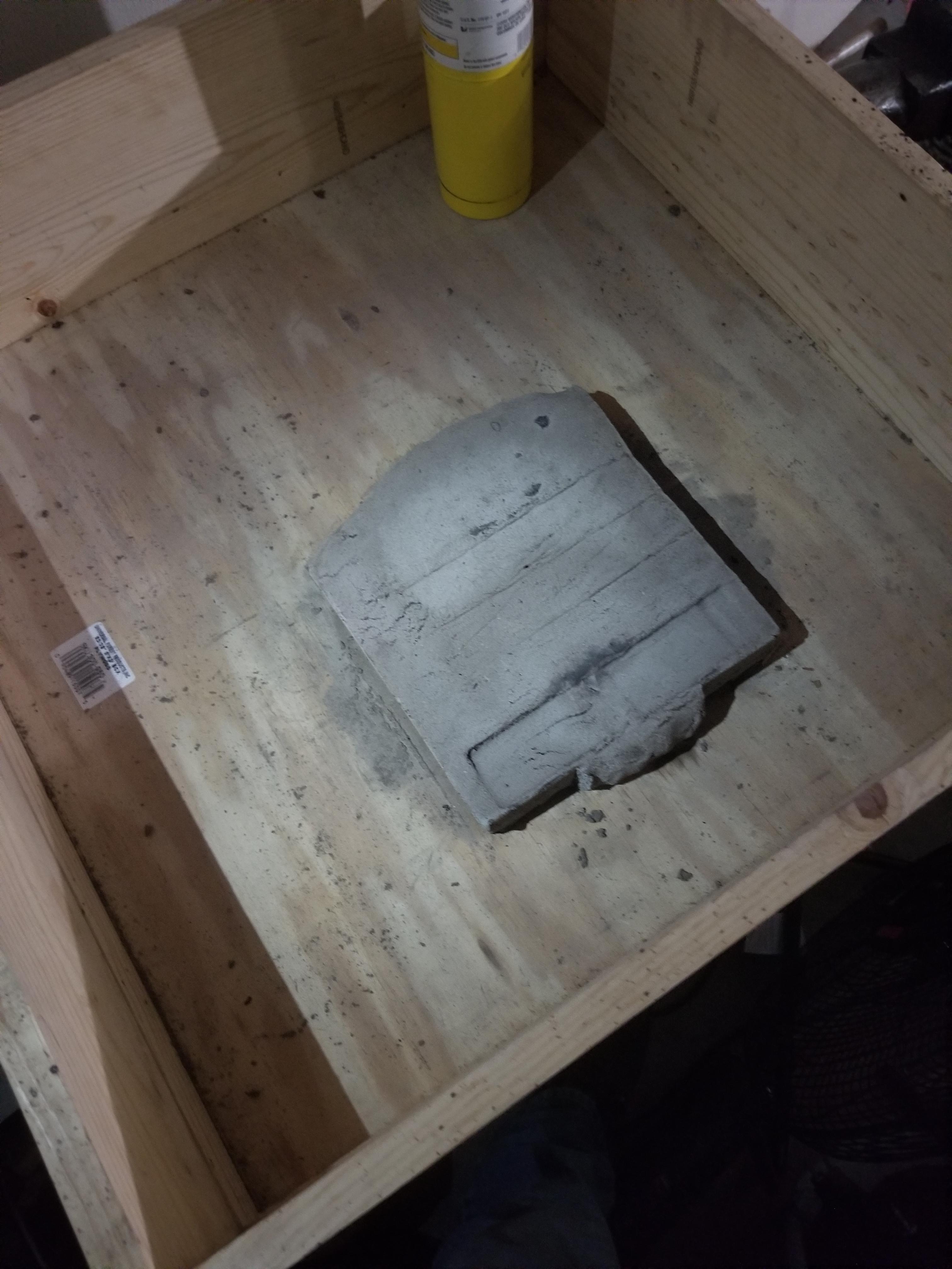

Well, I dropped the floor and put the tue up higher, flipped my tue brick upside down and gave an inch gap to the bottom. I have the adobe brick (which cracked this run) at the bottom, then 2 layers of hard firebrick for about 4" between the fire and wood. I was also given a bag of bituminous coal. So tonight, I ran roughly 80/20 charcoal/coal. It worked great! Having the gap beneath the tuyere really did make a difference as well- instead of just having a hot pocket right next to the outlet, I got a hot line across the trench. In all of my pictures my fuel is very low, I was playing with the coal/charcoal mix. When I went to test heat some steel I built it up a fair bit higher. Step at a time!

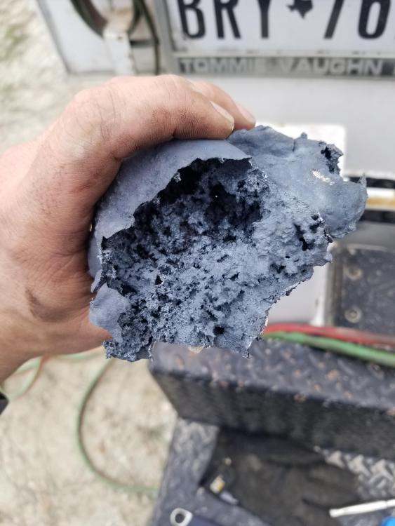

It isn't the shop but I figured someone may appreciate it. Lanced the moldboard pivot pins on a 12M3 grader. Bronze adhered to the pins, locked them up. The "adult sparkler" burns at roughly 10,000°F and will blow through a 4140 pin like it's putty. Once 3/4 through the pin, let cool and start beating with a 20lb sledge. Shin-height side-to-side isn't quite analogous to striking... SORE... -

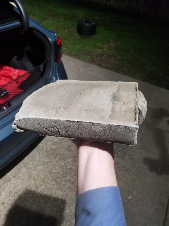

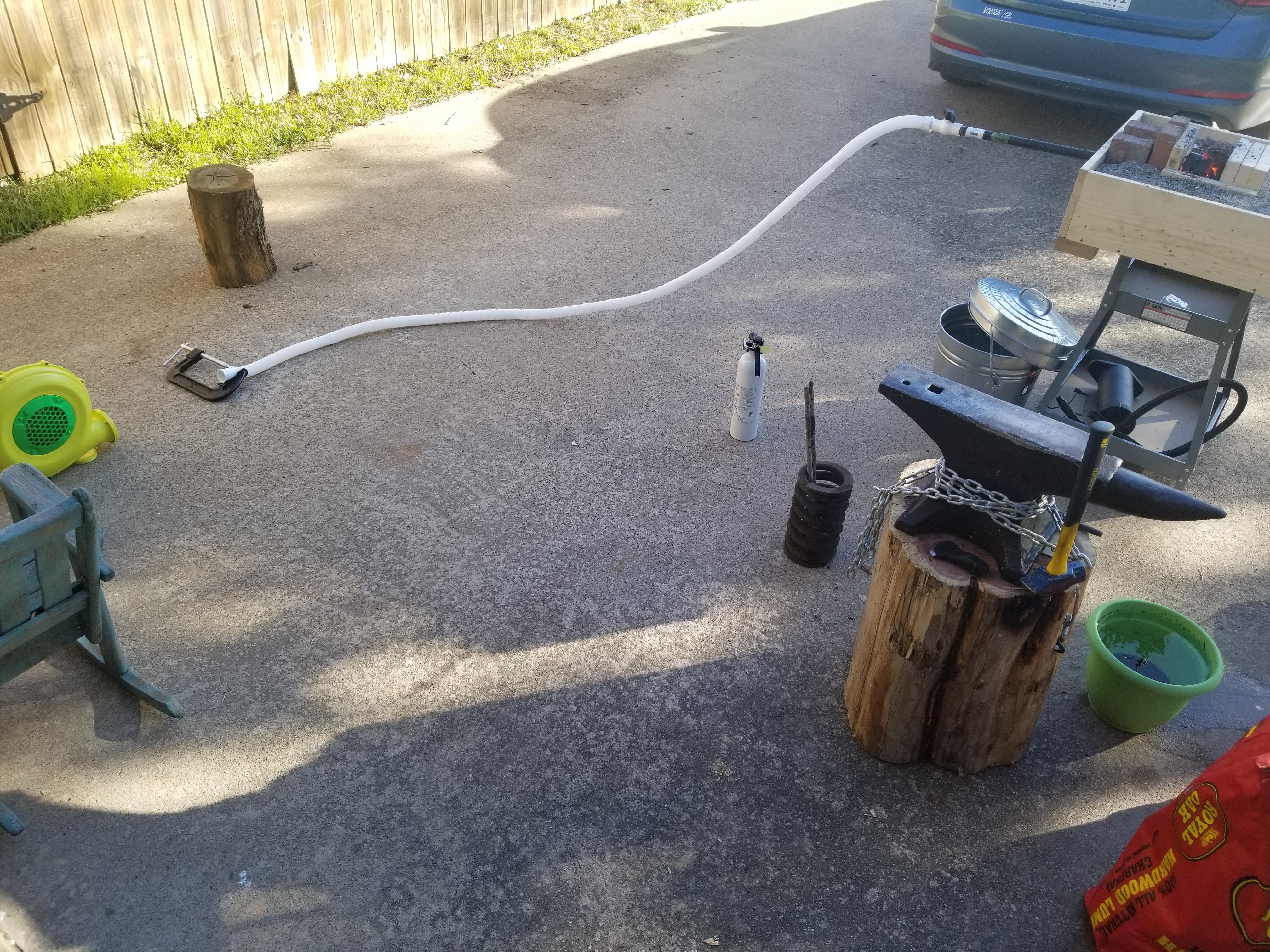

I only missed, what, twice? They all turned out pretty good looking to my eye, though one of the punches and one of the hot-cuts had particularly good features. I was out of town all week, and my wife was excited when I told her LBS asked if I might be willing to strike for a while, and if I could. I don't know if it's spousal support, or if she just didn't want me back in the house yet! Very much a good afternoon by my reckoning. ------- In the morning, I confirmed my adobe brick held up through the week of drying, then I rigged up a system for the bouncy-house blower my Dad decided to send me. Hopefully I'll get to fire it up tomorrow if the wind doesn't get feisty -
