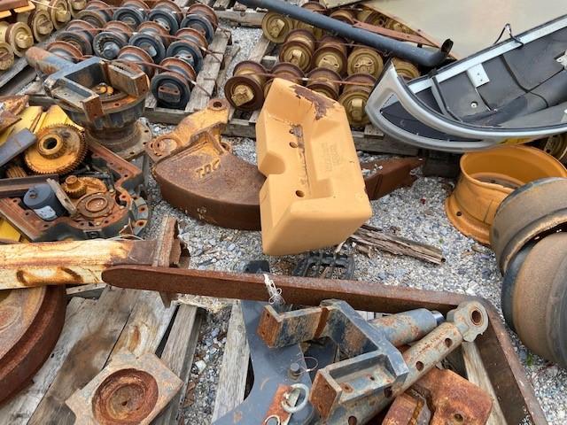

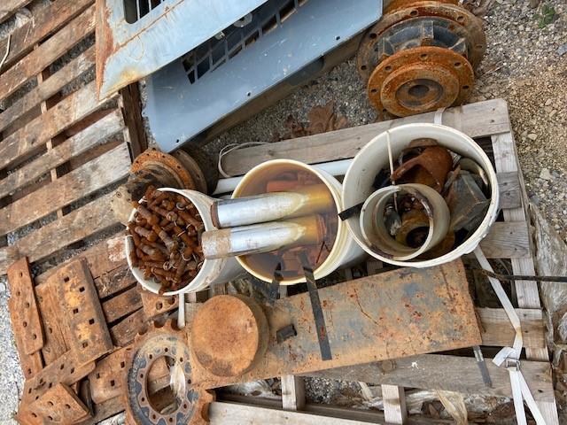

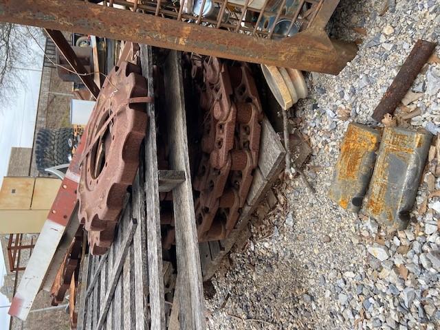

  8. Thanks for your reply Chris. I think you are correct about keeping them separate , I have plenty of room in my shop so why not have both. A friend of mine told me that I could come did through his heavy equipment scrap pile to see if I can find anything useful for making things in my shop, Here are the pictures he sent me.... (i'm probably gonna need the gooseneck)
