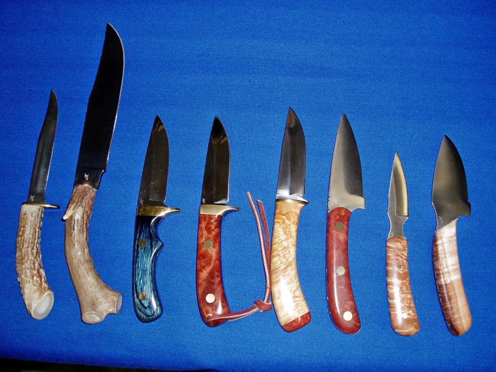

  1. Thanks for the welcome and the nice words. There is enough metallurgical info out there these days to choke a horse now that everybody and the ship's cook is making knives, ha. Most of it is advanced calculus to me, I'm still working on algebra 1 where metal science is concerned. So far I've followed mostly an old book of Wayne Goddard's, hence the edge quench thing. Actually, I'm still just working on having my knives not looking like they were made by a fourth grader, ha. Most I've given away to my sons and grandsons. Have never attempted to sell one and don't intend to. As for the handles, Slag, I have a big box of scale material, but if my feeble memory serves, from left to right the first two are leftovers from deer hunts here in Oklahoma with brass guards shaped to follow the front contours of the piece of antler (#2 also uses an antler tine for part of the guard function), the third is Dymondwood (sp?) stuff from Jantz, I think the fourth is Amboyna burl, the fifth is natural box elder burl with a camphor cap, the sixth is camphor, seventh is stained box elder burl, and the fat skinner on the right end is from a chunk of Koa left over from when I lived in Hawaii years ago and built a couple of guitars from Koa. I'm not gonna run out of handle material for a while, I like to collect and stash bits and pieces of exotic woods, most of which has been stabilized. I use a home built 2x72 belt grinder with a 10" contact wheel which does fine, but I haven't yet figured out how to make it track well with the platen I built for it. Still working on that. I do want a small forge one of these days, though. I can make most tools, but it's beginning to look like I might need to sell my truck to buy a good anvil.
