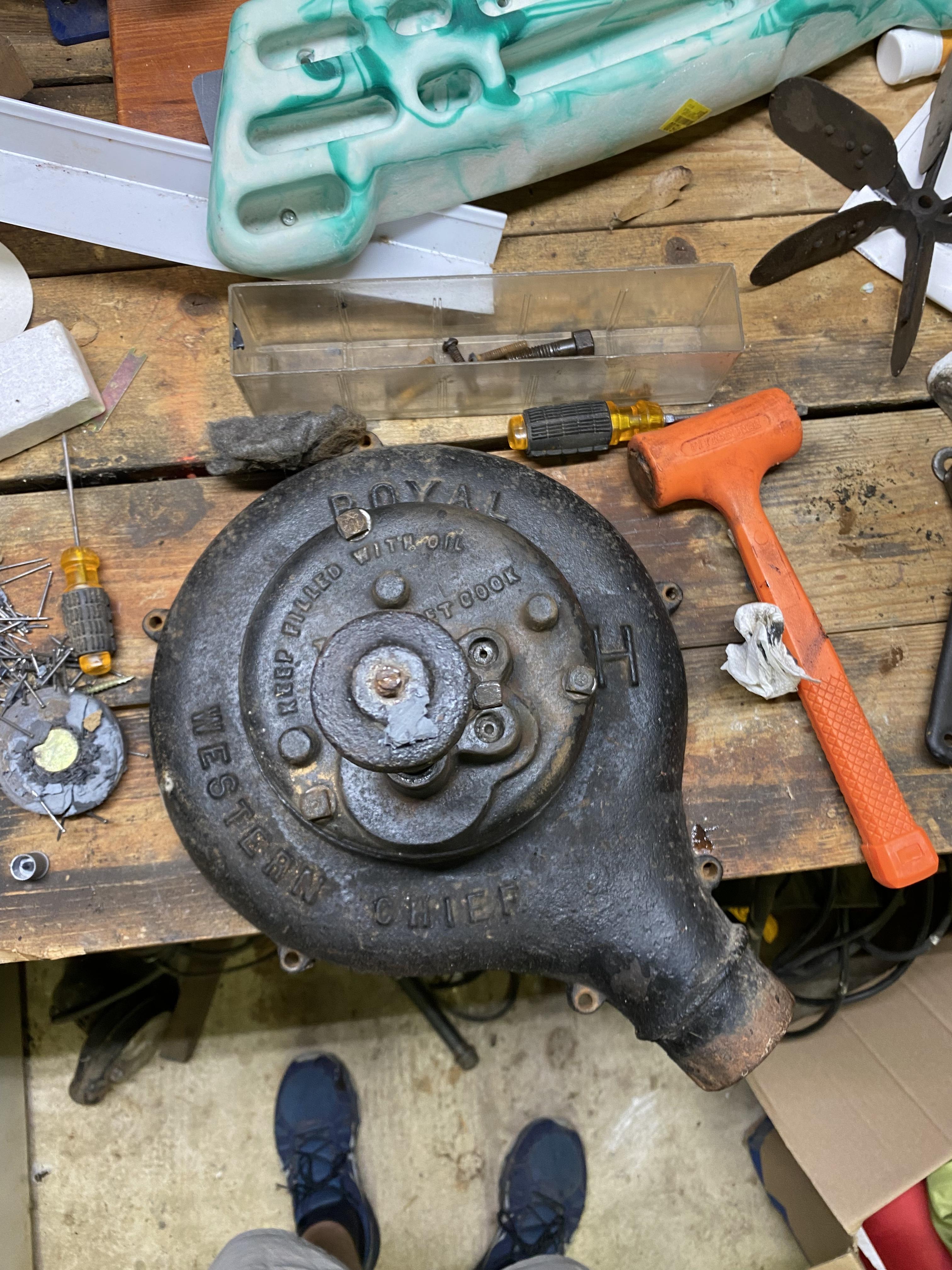

  1. Thanks for the input everyone, got the mud dauber nests cleaned out, the rust brushed off, and a fresh tank of gear oil along with a fresh coat of oil on the outside. The blower works like a champ, the only thing left is to forge a new handle as this one was missing one. Ill post pics soon.
  2. Now that im working on a new solid fuel forge I decided to pull out the old crank blower thats been sitting in a corner of my shop. At first It seemed locked up, but after dissasembly I realized the gearbox was solid mud-dauber nest. After cleaning, scrubbing, and re-oiling the gears, redoing the gasket on the gear box, and partly reassembling it seems to work like a charm. Two questions, A. How much is a blower like this worth? Its a Royal Western Chief with a stand (ill get a pic if it later). B. What kind of oil do yall use in these? Will higher viscosity gear oil like I run in my mill work? Or do I need something thinner? Any tips or tricks greatly appreciated!
  3. When I had to repair my bent handle, i removed the screw from the vise and heated the handle in the forge. Im sure cutting the old one off and welding a new end and forging it to a ball wouldnt be super hard.
