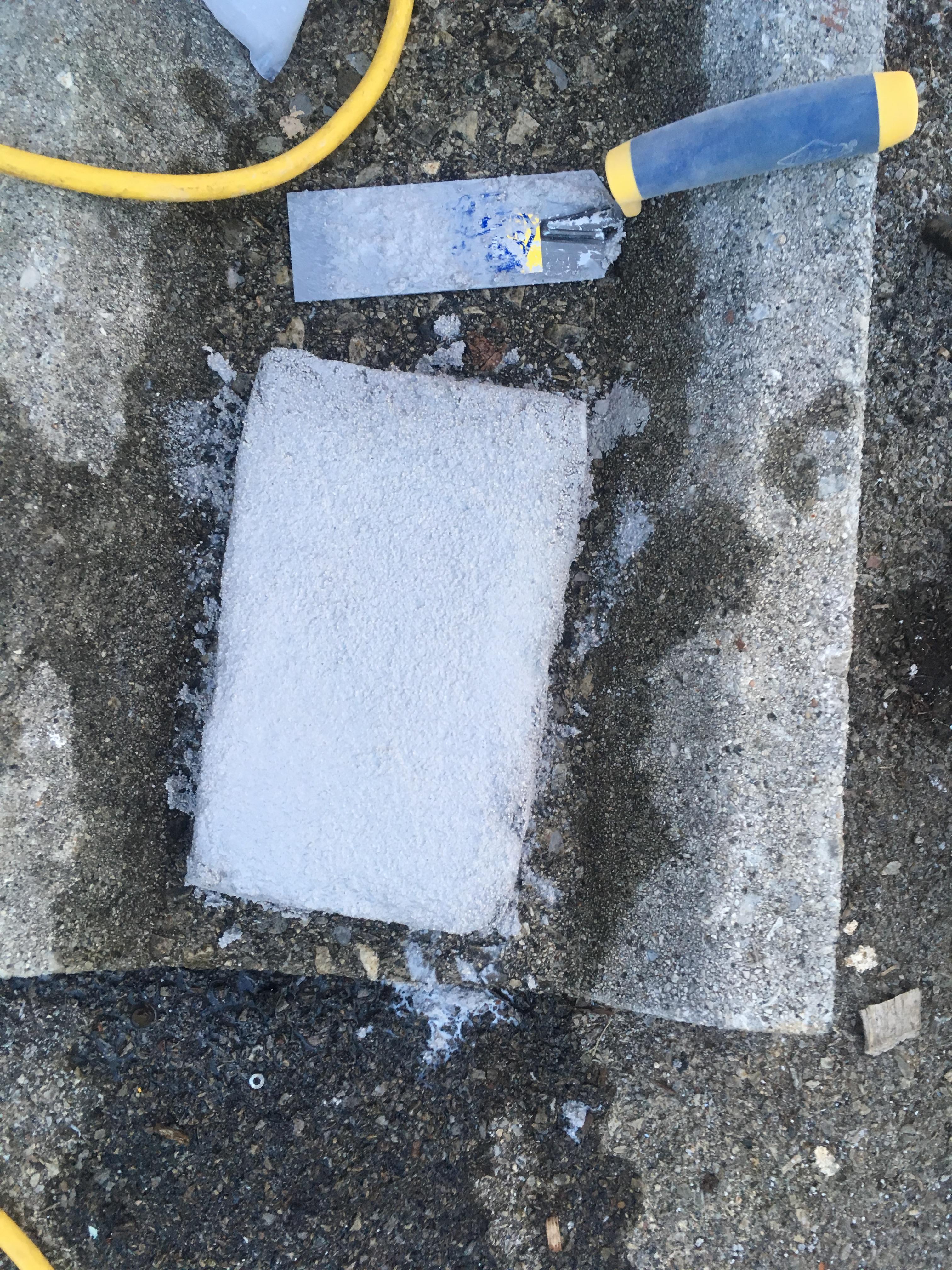

Between going to plant sales, building fence, planting the mornings purchases, fabricating a gate, tilling new planting space and on and on..... I found time to cast the shell. I leave tomorrow morning so I’ve got it all set up to spray it down tomorrow and head out for work. I also tried making a brick out of extra wool and Kast o lite.
