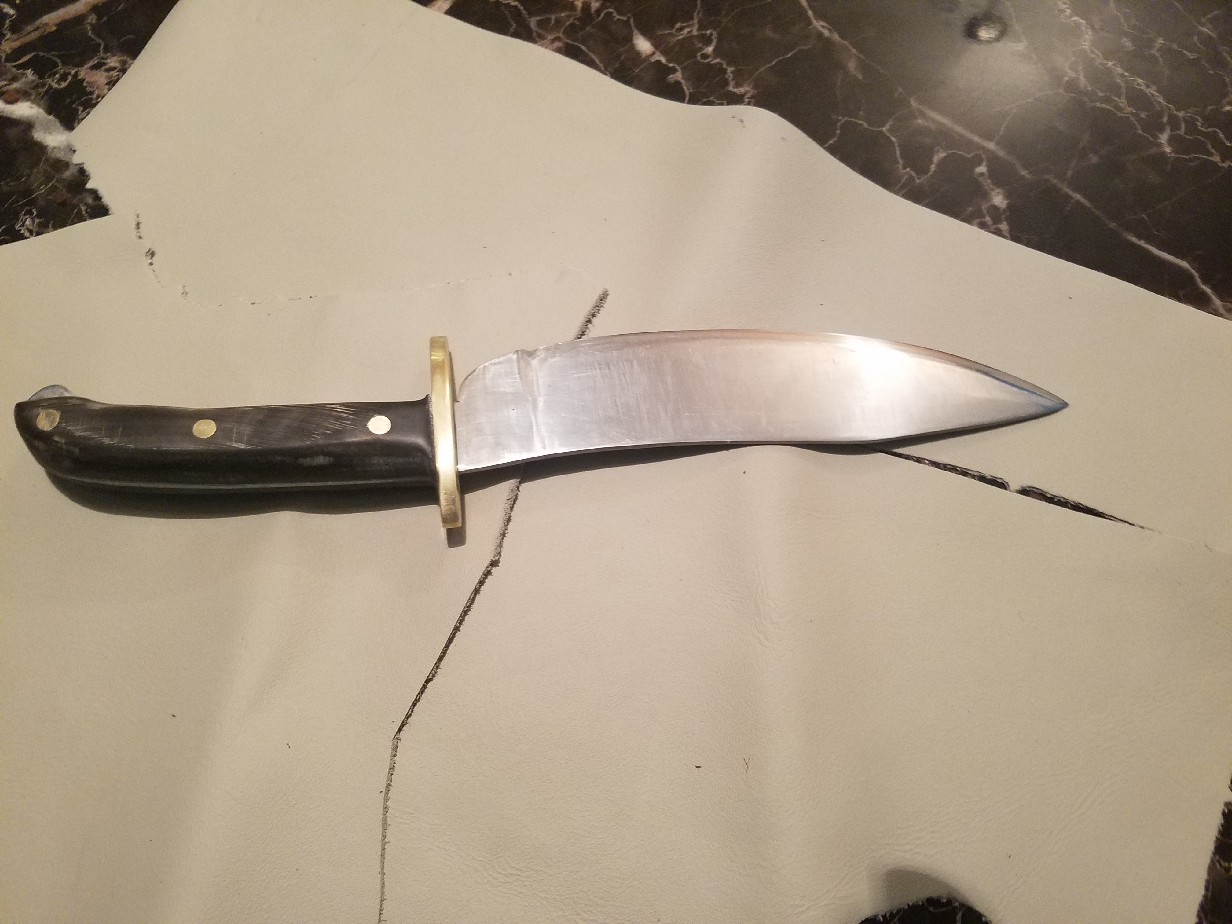

  19. Thanks, I'll go get the gauntlet of grits from 60/80 up, and try to see what I can make happen!

  21. ^When doing it by hand, does the blade get clean and polished with each grit of paper as you go up? and is it better to sand wet or dry? A lot of these I've just been going through trial and error with. I have 220-2500 I can use to hand sand, but not sure what it should look like at each stage before moving up in grit.

  23. Hey all, forgive the many posts of knives of subpar quality, but with each post, following the comments I get here, I feel I am better able to grow in my quest to become an at least decent bladesmith lol. That being said, without further a do, I present to you knife number 5 (gonna give it to my dad for christmas) Blade is 1080 steel, guard and pins are brass, and I uses buffalo horn for the scales. As always, criticism and comments welcome and appreciated!!
