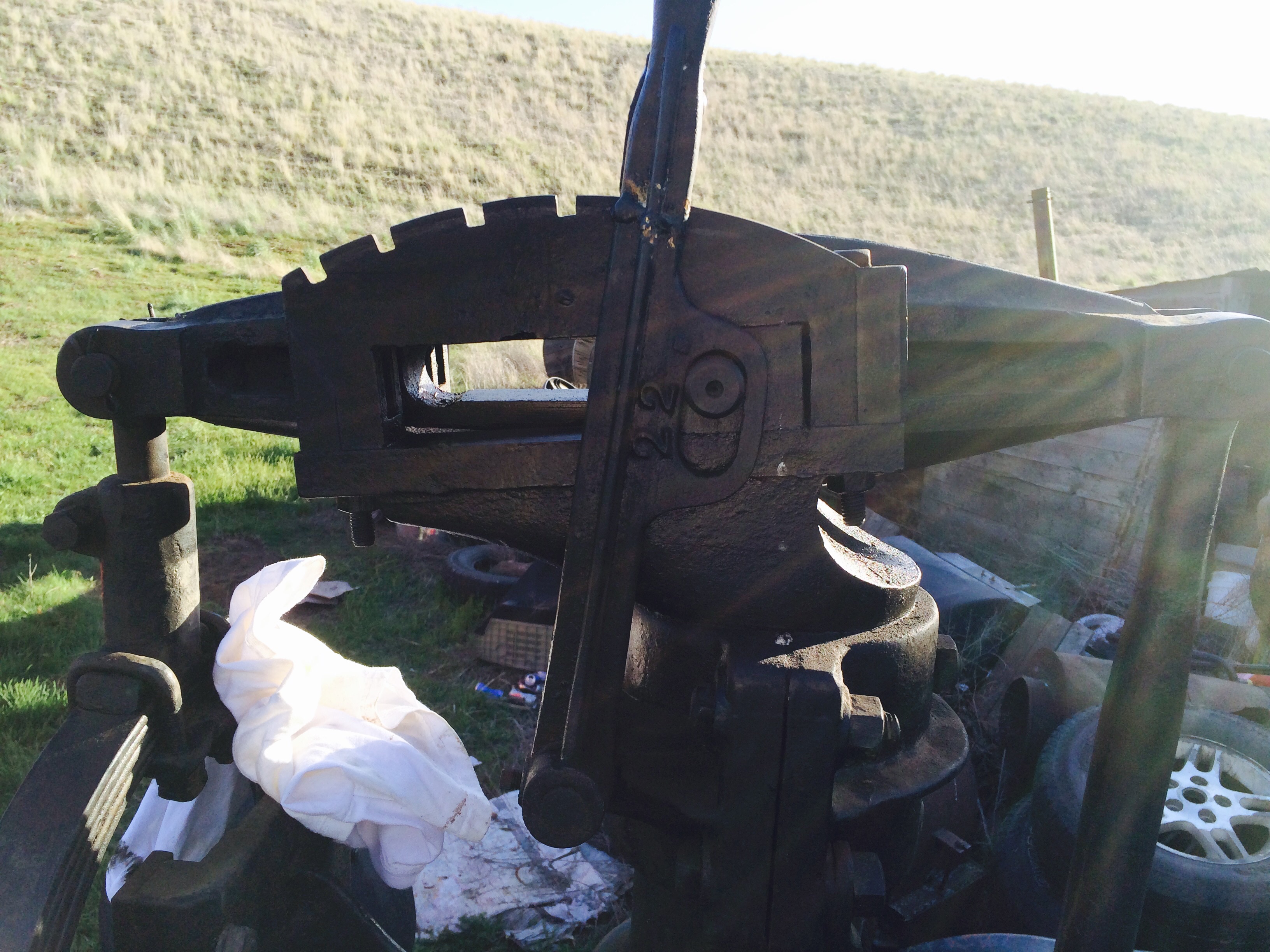

  18. Thanks guys but this one has to stay put for awhile. Weighed the empty trailer last night and this hammer+ motor and 1" base plate comes in at almost 2200lbs 350% on shipping would be a killer! Chris
  19. True maybe I'll paint it a better bright color ???? chris
  20. The horrible yellow on the switch box will be corrected as well. It looks really bad with the all black or rust theme going on. Chris
  21. So small update but no video yet. Figured out wiring! I swear the previous owner told me it was wired as 220v turns out nope 110v so in the vein of if it ain't broke don't fix it I ran with 110v and the old Westinghouse 3hp motor purrs away. I hard wired the 12 ft lead the hammer came with and added a vintage switch on the machine so I am not using the breaker as a on off switch. Chris
