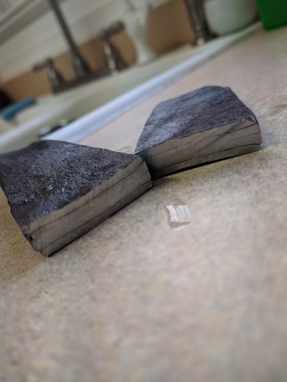

  8. Thanks guys. I got a question though. The 1084 I have is .25" and doesn't want to stick to the 15n20 which is .065". I'm pretty sure Im getting up to welding temp. But they just don't want to be together on the first weld. After I get it together and fold it, it's fine and I can do it just fine. I do grind the mill scale off perpendicular to the bar before stacking too. I guess my question is: should I get some 1084 that's a bit smaller like .125" so that there's a better chance of the metals the same temp all the way through?

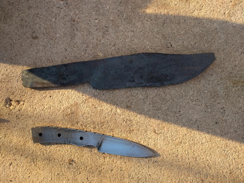

  9. This is my first patternwelded blade and my third time doing any kind of forge welding. Made it a paring knife present for my dad. 48 layers of 1084 and 15n20 with curly maple and cocobolo wood and a little bit of brass.

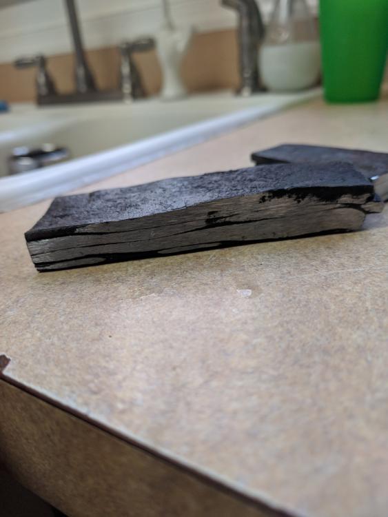

  13. Well heres the first try at forge welding. I stacked four ~4-5 inch by 1 inch pieces of metal and wired them together at two places. I made a cocoon of fire brick around the pot to make it hotter with less air. Pulled it out to flux at red and put it back in until I saw the borax bubbling. Gave it about 3-4 strikes with hammer, refluxed, put it back and hit the same spot to make sure it held. I did that for about have the billet then took the remaining wire off and switched sides. I think it went fine until I tried hitting the side and delaminated one of the top pieces. Tried to reweld that but it kept coming off. Im probably gonna have to make another pair of tongs with taller jaws so I can hold the billet more securely. Please tell me what you think I did wrong.
