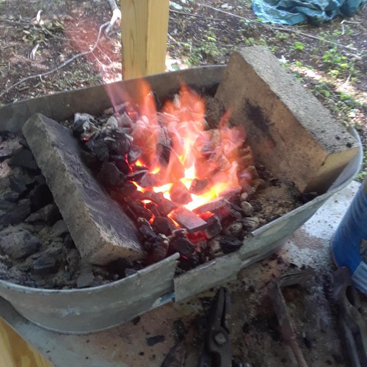

  8. Still using charcoal, increased diameter of "bowl" , works well, used a propane torch while hand cranking , blower lights really good. My next and final test will be coal.

  12. Cut up charcoal, and worked much better, was able to get good temps
  13. Yes I should of ...but would that have allowed the sweet spot to move taller in height? Airflow into is like 3/4 or inch. The bowl wasn't wide enough to fit tomahawk head into as well, have some more charcoal to use up then will switch to coal, still have to make a rake water can, poker etc
  14. Need to improve couldn't get "fireball" tall enough, guess with sideblast I have to think horizontal not vertical, wasn't quite at welding temps, manage to partially weld a tomahawk.

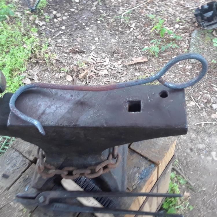

  16. Forged out a spatula today. Used sideblast forge with charcoal, also forge welded a tomahawk, but didnt weld 100 percent, really ugly not worthy of posting.lol
  17. Took these at a blacksmith event back in February in Virginia, setup was from pa hope it helps some
  18. Forged railroad lantern hanger several weeks ago, forged the light house bird feeder hanger for the mrs today, she let me forge on Easter... question...I could only heat and bend the bird feeder once so I couldn't really transition the curve to a gentle radius. Due to size of forge, how could of I done so. Ps Happy Easter to all , and let's pray for this country.
