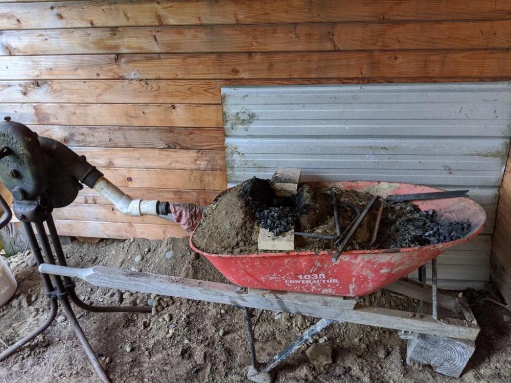

  1. Ok, going to be gentler on the air pressure, and see about working a deeper fire. It does feel very pancake-like in my current incarnation. Time to track down the firebricks I have somewhere around here...
  2. I'm a lightweight hobbyist who has mainly burned coal in the past. I'm now getting a chance to do more serious work, and wound up with a lift of coke that I've just started working with. This week I decided it was time to get in some forge welding practice, and I'm impressed by the heat I'm getting (except for the sunburn...I've moved my anvil further from the fire now). I've been setting flux-less faggot welds in it - my welding is still xxxx-poor, so this was unexpected. But the fire often feels really mushy - I'm pulling clinker out at an astounding rate, much more than I ever noticed with coal. So questions: Is it this particular coke making so much clinker? It it because in the coal I have a nice little cave and I don't disturb the fire as much when welding? It it because I'm not managing my coke properly when I stuff my bars in it? Thanks!
  3. Ok, shallower pot, ~5 degree tuyere tilt. Definitely moved the heat further into the pot - a real improvement even for general work. I managed to get a simple faggot weld to hold, so that's an improvement. But it was a heck of an effort on the bellows getting to and keeping the heat up at welding temperatures - it was very difficult to keep it up at a bright lemon yellow, and for the second heat it seems to take just as painfully long to get it up there again - the fire basically collapses and it's as if the blast has to burn its way past a pile more charcoal before forming the hot spot, each time. Is that normal? Or am I too impatient and working too low in this fire? Still no pintle weld. Running out of excuses to hang the gate, so I think my next fire will bend a couple of simple ones to make do. Paul
  4. Ok, minor re-shape this morning, tuyere pointing down ~5 degrees, shallower pot. Give my clay patches a few hours to set up and I'll start slow and see where it goes! Thanks for the pointers - I'll report back.
  5. Pnut - down as in blowing the air downwards towards bottom of the pot? That's counter-intuitive, but I'll give it a shot! Paul
  6. Hi all. I've recently set up my little smithy, and the forge is a side-draft JBOD style. Ihave decent clay, so built up a firepot. Though I can weld in coal and propane (often enough, but I can't call it second nature yet), my only choice of fuel here and now is lump (not briquettes) charcoal. I've also never welded in a side-draft forge. I get plenty of heat - after my attempts today, it appears I've fired the clay around half the firepot - it's ceramic pottery in there. But in that section of the fire there's so much oxygen that my piece just burns up. Higher up in the fire, I get to orange heat, almost yellow, but not to clear white. I do, however, not burn up my material. I've tried at 3 different levels in the fire today, each one split higher than before. I found no joy. I have no pintles for garden gate. How do I move my white heat further up the fire? Any other advice? Thanks, Paul

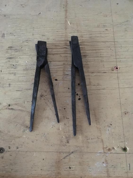

  11. I did some finishing work on the dividers I started on the weekend. I'm impressed at how much the cold work frees up the action to work better - it makes sense, given how much material around the hinge gets filed away. These are good enough for me to use in the shop. I've got another pair set up to finish tomorrow evening, which I think will be a bit better than this one. I've also noticed that I have nowhere near the assortment of files I need to do this properly. Anyone have a decent "set" they can recommend for basic bench work? Flux.

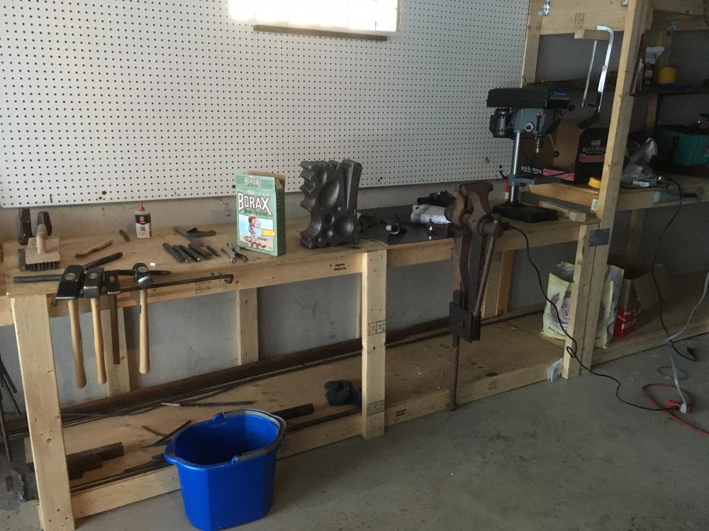

  14. Only a few hours in the shop today. Dropped the workbench 5 inches - it was sized to the previous owner, who has a good 12" on me. That let me move the leg vice there comfortably, which is so much more solid than my previous 4x4 tubing stand. Hacked out a couple more pair of calliper blanks to give me some filing to do the next few evenings. I only just now noticed that I crossed up the pair - that will take another heat to sort out before I can start the finishing.
