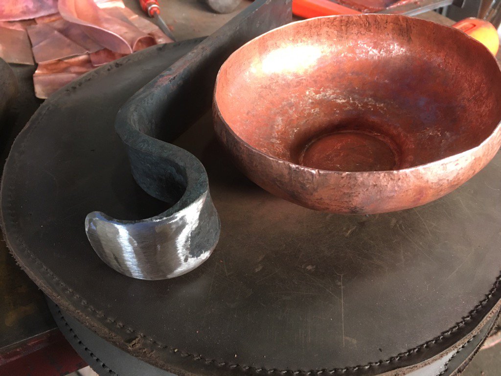

Today was mostly copper - did a workshop with Sandra Dunn here in Kitchener. There was a little bit of obligatory smithing, see if you can spot it. Raised the bowl (I call it Cain), and had to make a stake I could planish it against. A little joiner exercise - I got to play with patina colors a bit. Sandra's a great teacher - 7 of us in the workshop, and we all got piles of well-targeted, well-leveled direction. Flux. Nice, Joe. I love a practical knife. Flux. -
