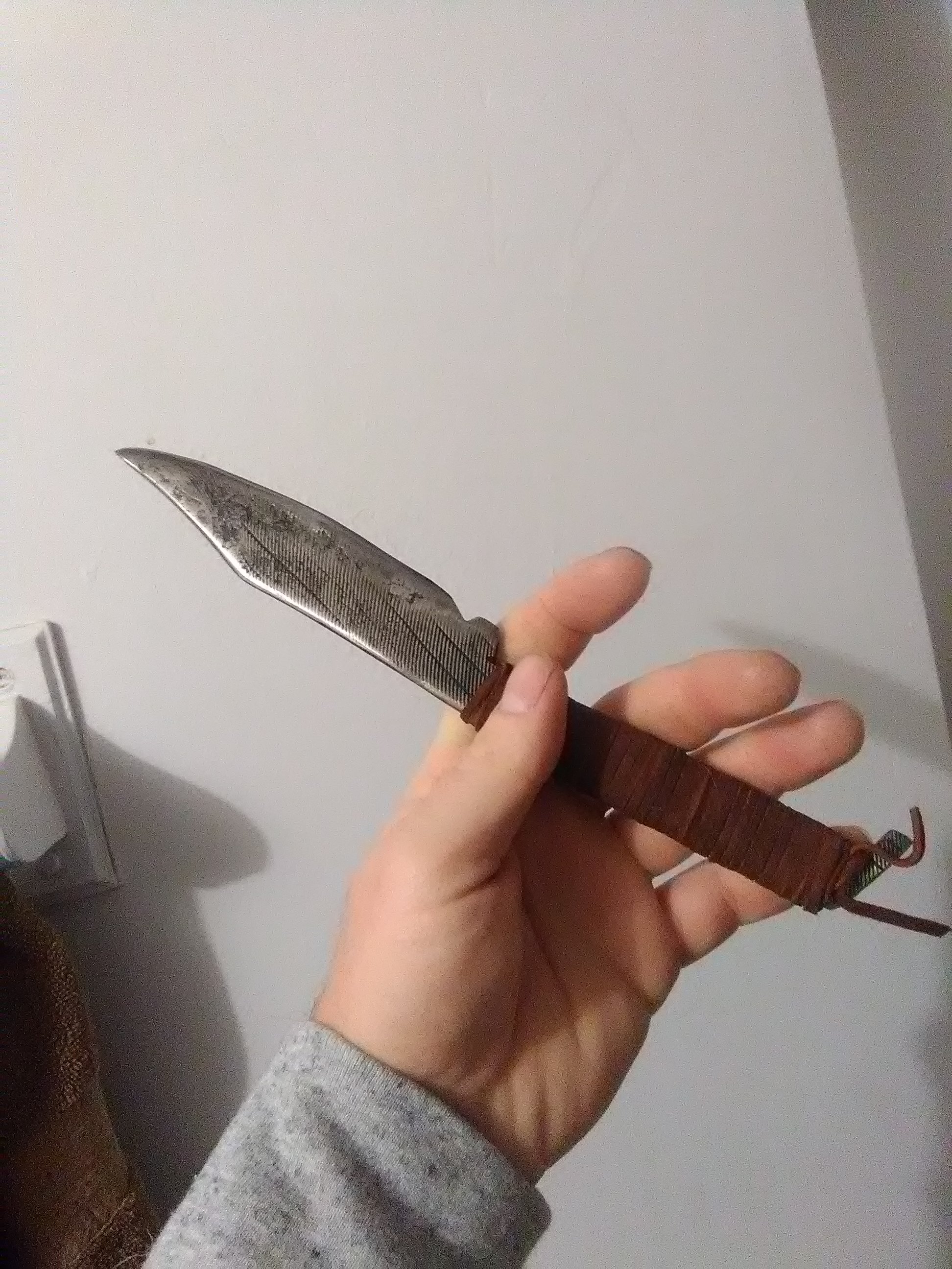

  5. This started out as a half round file... I don't know if it was hard to get it into shape because it started out as a semicircular shaped object, or if it is simply that small, thin knives are more challenging than the big choppers I've been making... But this thing's size is no tell of how hard of a time it gave me, nor the sense of accomplishment it gives me as a baby knife maker to be able to say that I hand forged my latest edc knife (which fits better in pocket than a thick bodied pen). And look at the snakeskin pattern the half round file gave it! I figured it would be an uggo when I first started hammering it into a square rod... but it ain't bad compared to some of my others.

  20. Hey all, I posted these in my intro post, sorry if you saw them already. These are all made from old files (w2 tool steel so far as I can tell). They're a bit rough, but currently my finishing equipment is limited to just an angle grinder. Leather lace grips are also simple, but they work well and required no additional purchases on my part. This was my first... The inspiration was from studying HEMA knife fighting techniques; so the edge I isn't the sharpest, but it has a strong stabbing point and a slight back curve that facilitates trapping and controlling your opponent's limbs. duplicate post removed as SPAM
