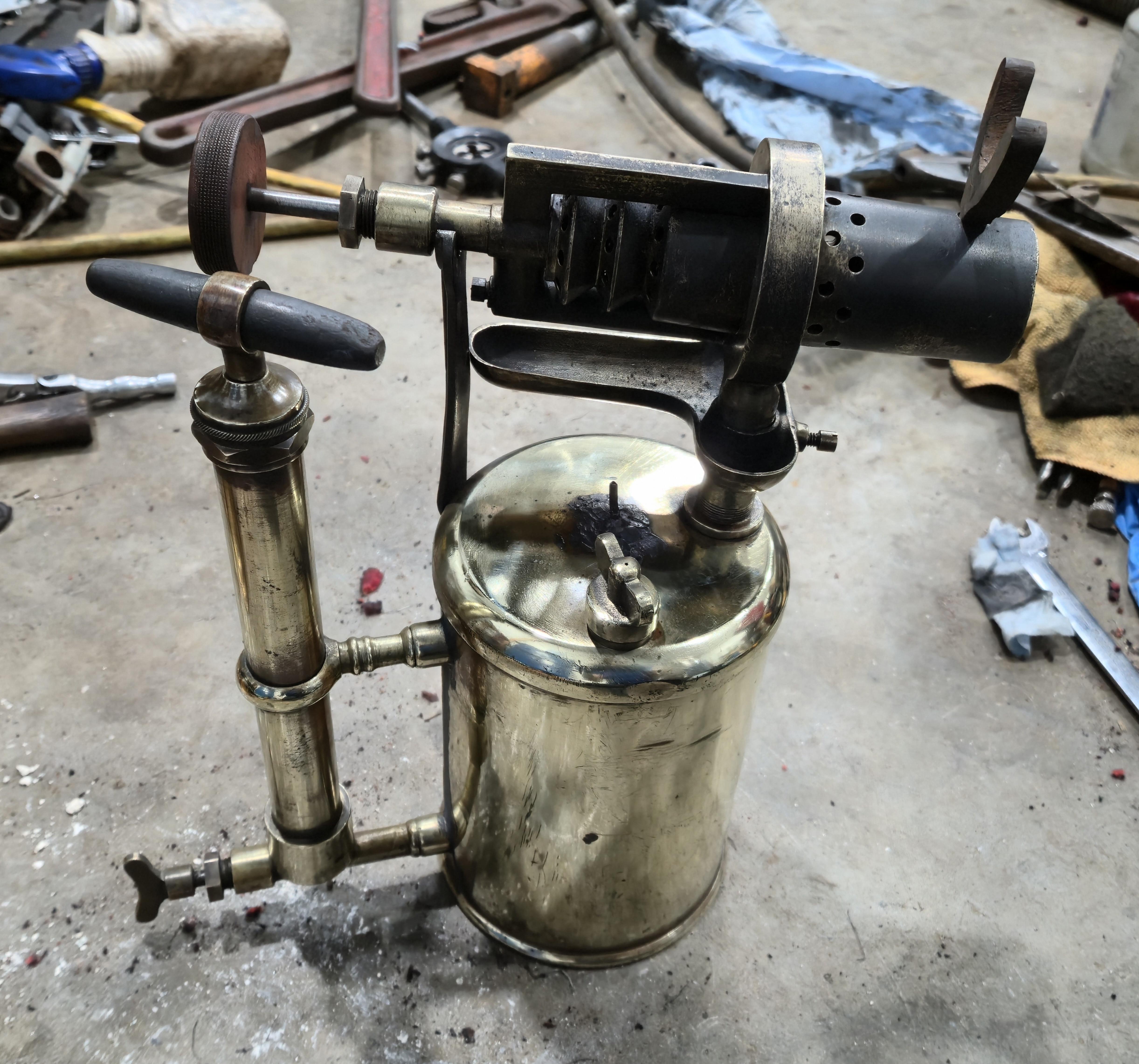

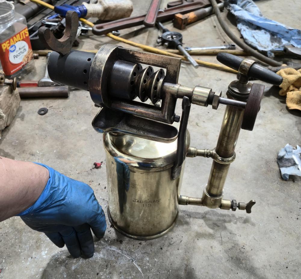

I feel you are so right.. funny how things work.. Here is the torch in all her glory.. She is a big one and puts out a lot of Btu's. These types of torches can be used with gasoline and kerosene. Kero offers a little more btus. 20260122_183139.mp4 -

jlpservicesinc replied to jlpservicesinc's topic in Building, Designing a Shop

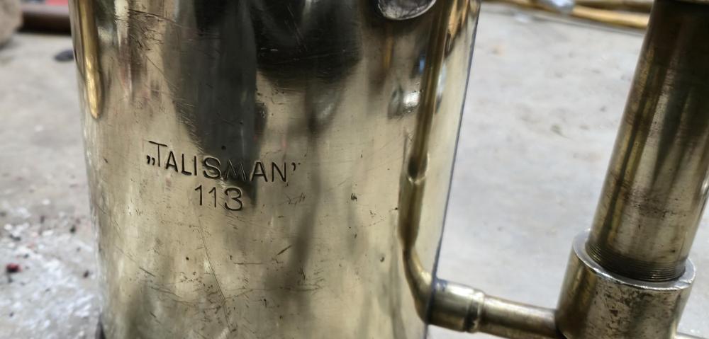

Sorry Frosty won't be here to see this one!!!! Picked up a new gasoline torch.. Have never seen this brand.. Took it all apart and cleaned it. Made a new piston leather and she is ready for her first run. She is a biggin.. any information on the maker would be appreciated. -

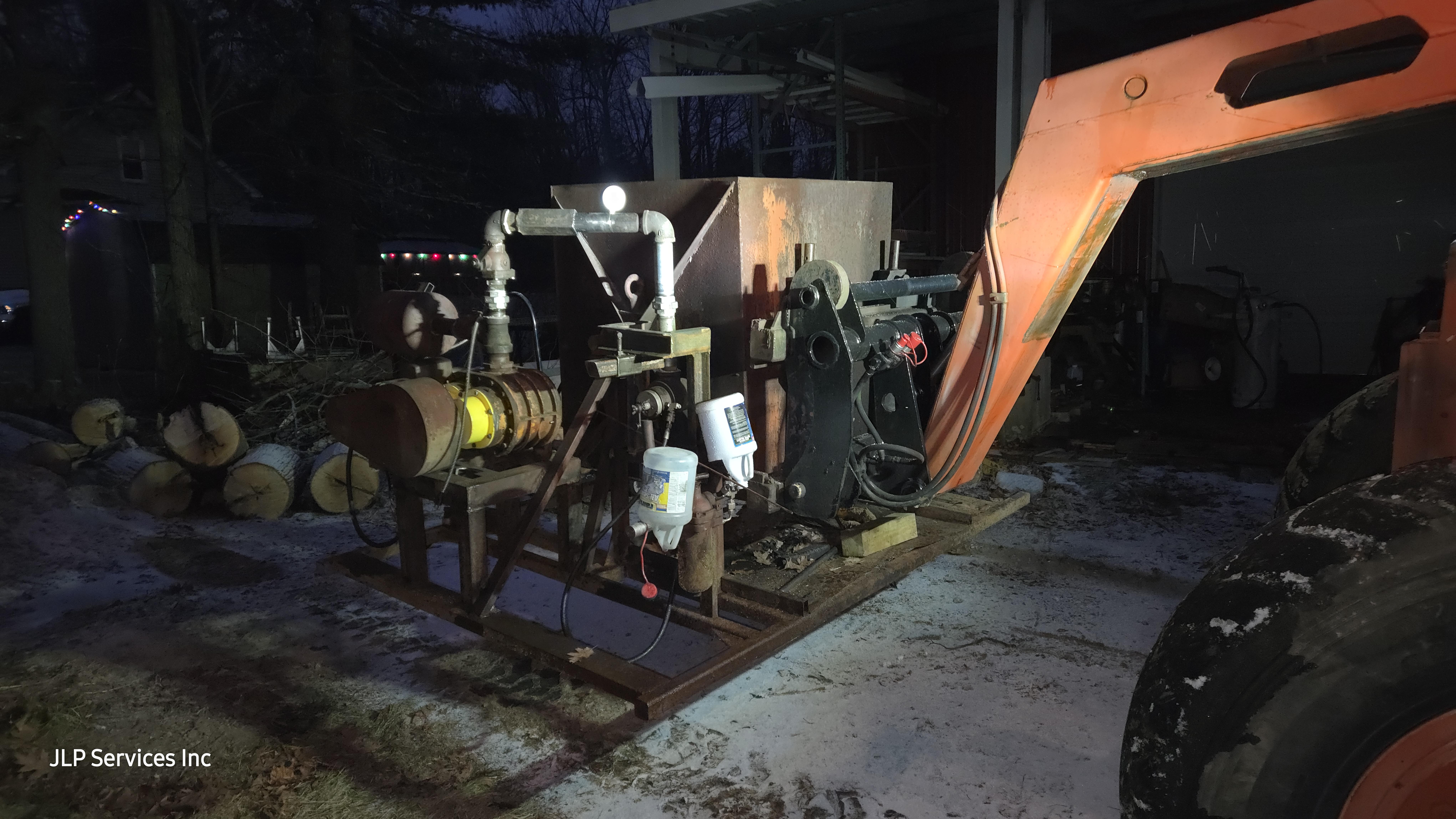

Frosty the inside is round, though the body of it is square. Should I find a 220gallon propane tank and line that one? Or should I fill the corners with soft bricks then fill it with refractory? I know I'll have to line it with spikes to hold the refractory. I'm ok getting rid of the metal lip on top.. With the heat it just distorts anyhow, Have you seen Windy Hill Foundries videos? I fired it up again today to burn off more moisture before putting it away for the winter.. I fired it for 30min. The pressure tank with about 25lbs air in it keeps the 2psi #2 fuel oil feeding really nicely.. Very steady. I still have a lot to learn.. I did try to adjust the air/fuel and this lead to the burn going out.. I have not figured out the ratio.. It does seem that the oil feed likes to be about 12-16 on the burner and about 50% on air feed. this is with about 16Oz air and 2lbs fuel pressure. I have been using my old gasoline torch to light the furnace off but really thinking about setting up a transformer with long electrodes.. The burner does not like to be pushed all the way into the burner port.. It needs some clearance to venturi some air in.. -

The original lid was missing.. In reality I'm not sure it ever had a proper lid.. I think it might have had a piece of plate to cover the opening. I'm pretty sure this was used to separate steel from alum.. In other words they would stuff a transmission in it melt off the alum and dump the steel parts on the back side. Sounds good, thanks. -

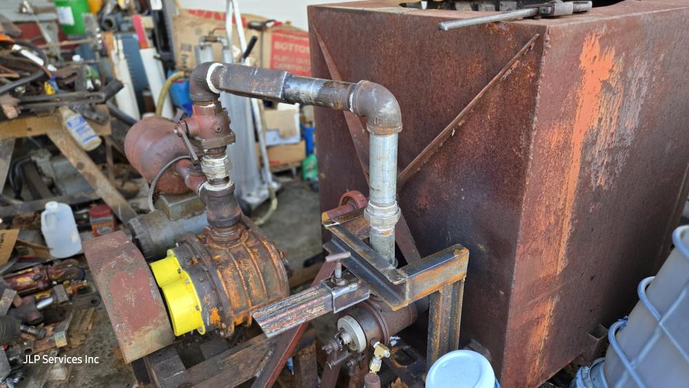

So, today I was able to fire the furnace.. I started it under the front apron/shed roof and the next thing it was raining. All the snow started melting. I was running it on #2 fuel oil.. I was surprised how easily it started once I was able to find the correct air flow. This was running on 2psi of fuel flow at the nozzle. I was feeding 25psi to the oil filter and using a metering valve to bring it down to 2. 20251223_165539.mp4 I was able to grind out inside to smooth out the rough spots like planned. after the burn I decided to clean up the air gauge and oil feed rate.. was tough to read while it was firing. I need to install and air control rod.. This is the last piece of the puzzle this year. -

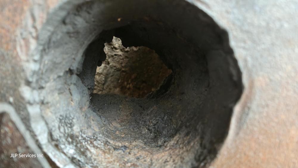

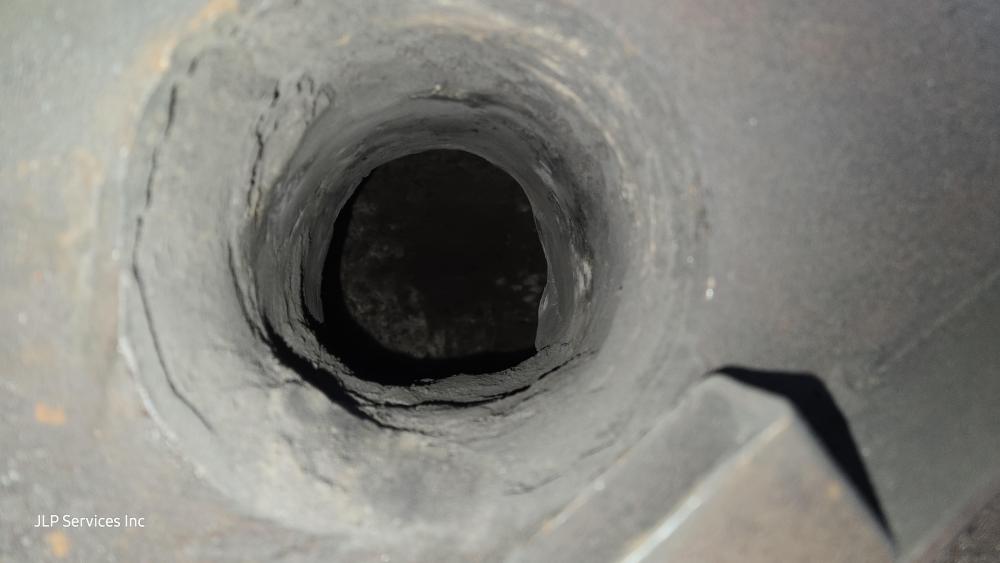

Bull, the book looks like a good read. All thats left is to clear the throat of the burner where the bricks lean in, put the tilt motor on and do a test firing. I lined the bottom with sand.. The top will need to have a cover made with a vent hole to keep the heat in and give it a longer duration in the furnace itself. I need to move onto other projects so nearly all the work was to move it in a direction of preservation. I'll make a cover for it next spring/summer.. For the time being I'll move it out to the back 40, flip the furnace upside down to keep water out/ from freezing. I'll reach out to Windy Hill foundry and see what he's using for refractory and go from there.. I do know at some point I'll have to drill holes thru the body to install rods to secure the refractory in.. Currently it looks like they put a lip of 1/4" steel on top to keep all the bricks and such from falling out when tilted. -

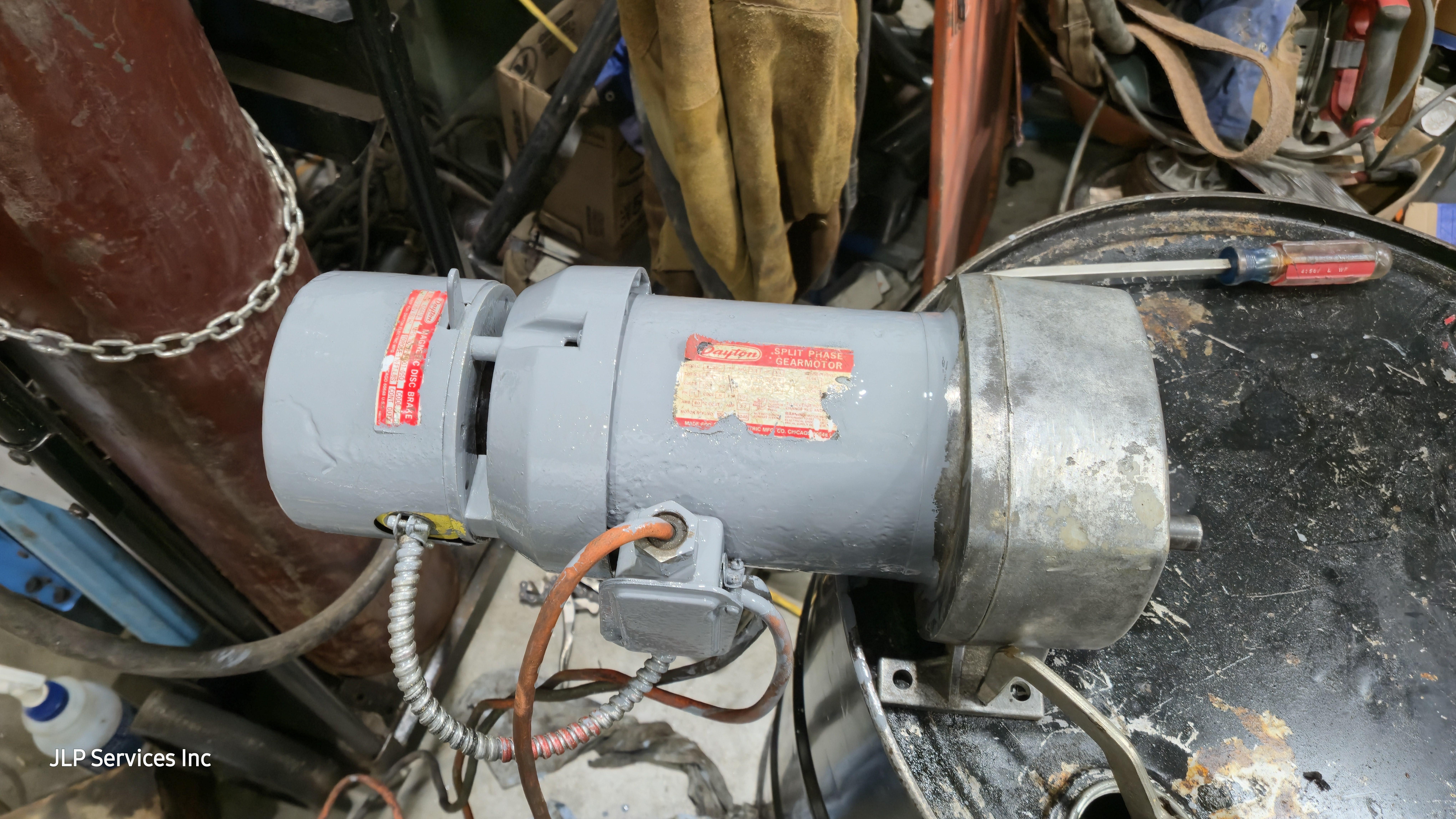

Motor gear box cleaned and reassembled. Painted. Some protection for the loose wires that were sticking out and now should be good for a few more years of service. Taking care of things ,takes care of you. These old equipment are worth it. -

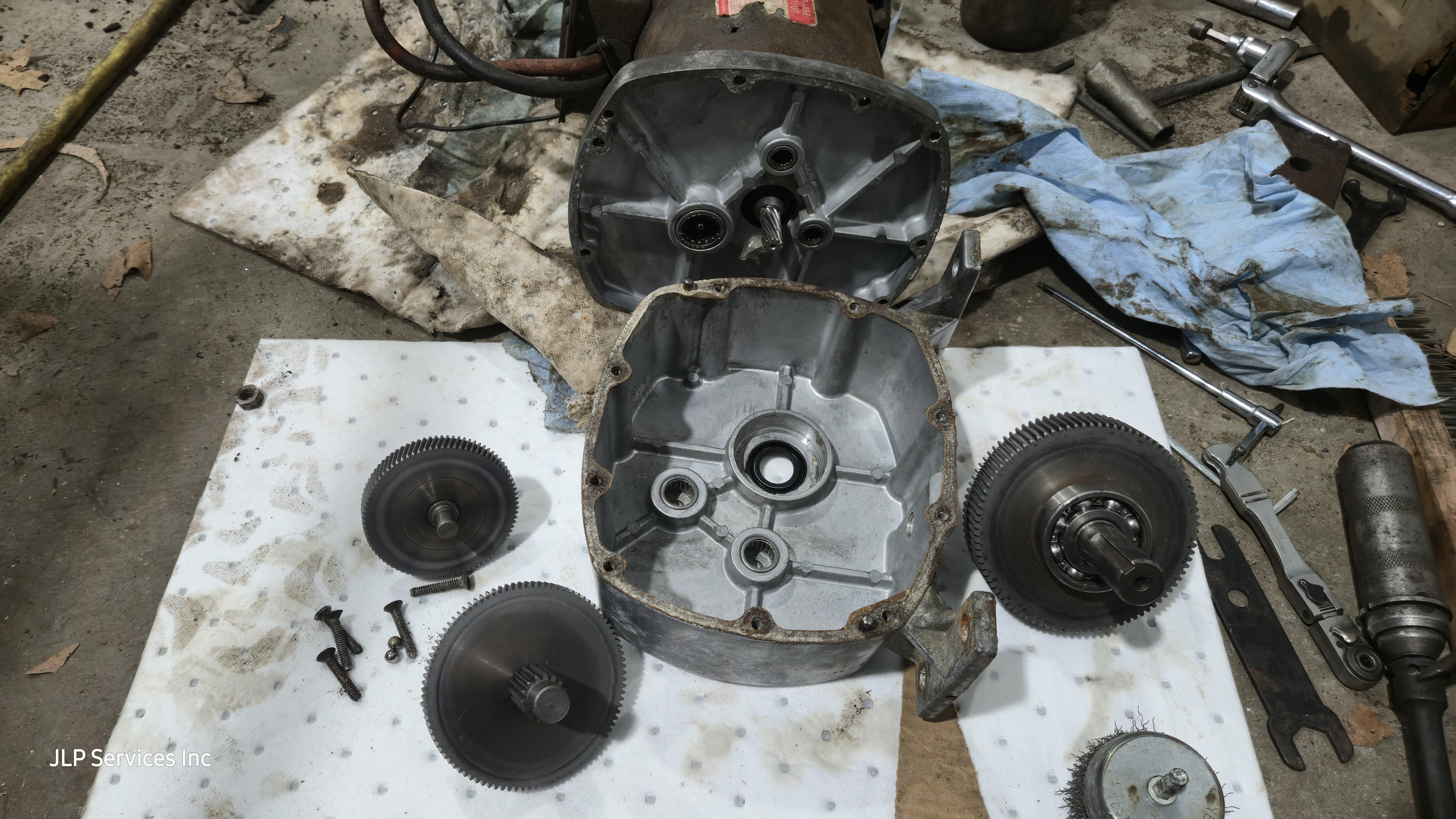

Since i have dug in deep I figured I might as well dig into the gear tilt motor.. The inside is like brand new. I can only guess that the assembly is in such shabby looking condition due to being outside on the ground for a lot of years. The casing had a tiny hole in the top from corrosion so clean it and filled it with epoxy. The output shaft ball bearing is pretty noisy but it spins freely and it's such a low rpm deal I'll leave it for now. The oil seal was in good shape. I cleaned all the bearings and packed them with grease for assembly and I'll fill the case with Redline heavy weight shock proof. I have cleaned the brake on the end and painted the assembly the same safety yellow as the blower cover. The motor outside casing had a rust hole in the top so clean the rust and filled this with epoxy as well. I priced out new gear motor and brake assembly and it's near 2000.00. For fyi the blower is a 7" case with 5" gears and a 3" output/intake.. -

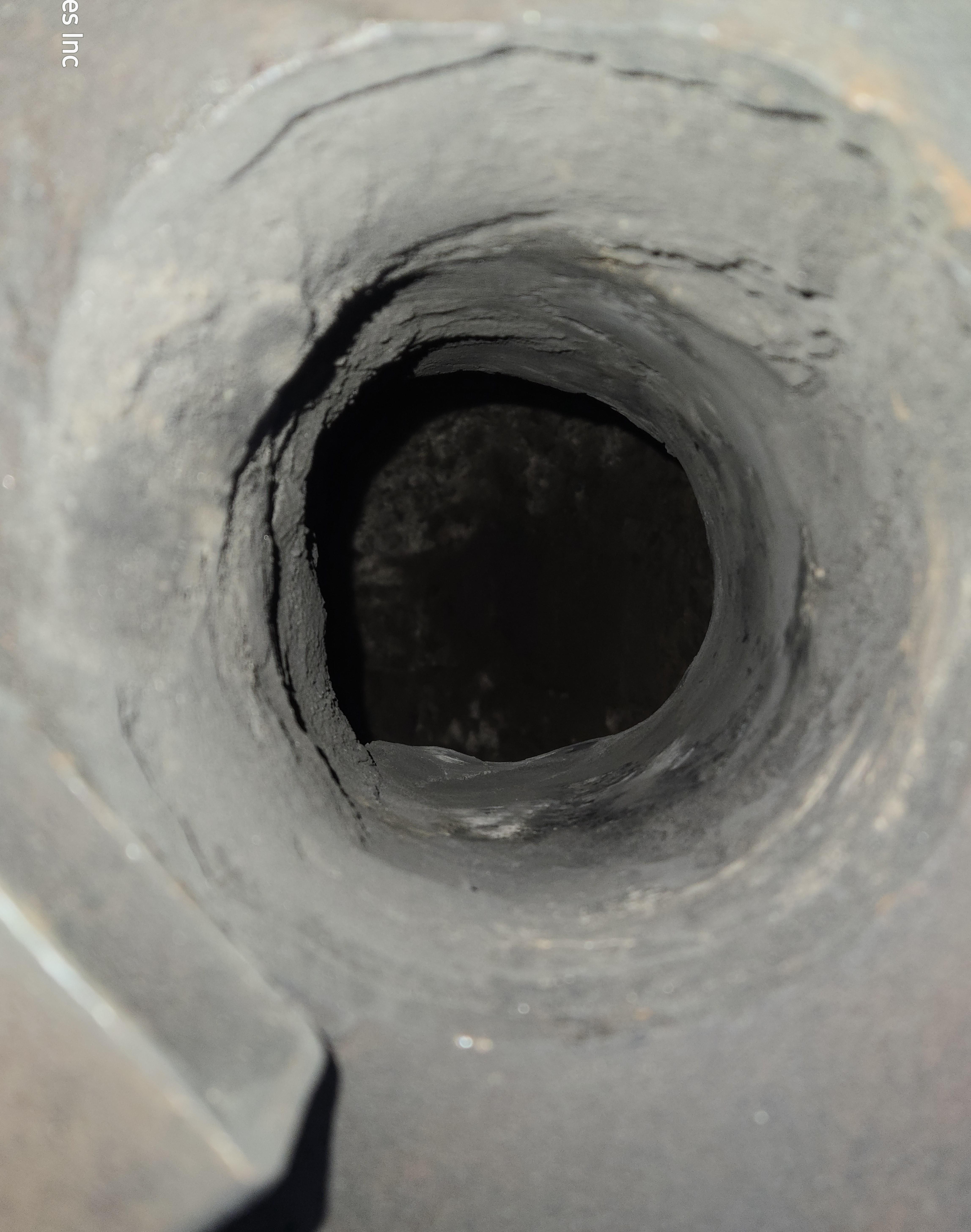

Bull, staging is what I was referencing as camping on the side of your climb. Spending the night.. Sometimes it can be a cache of stuff put there to move on more.. Frosty. Ah the good ol days.. There was certainly something about it being more raw and interesting. On that.. Over the last few days I figured out the last part of the puzzle on the furnace. That is a telesccoping air pipe section so I can move the burner without detaching all the plumbing. As for weather.. I all I have to do is play in it.. Snow adds challenges that don't happen any other time of the year.. Iceburg running, swimming under the ice, as Bull pointed out ice climbing.. Lotta good times on the ice. Different kind of skill building.. 20251217_185512.mp4 -
