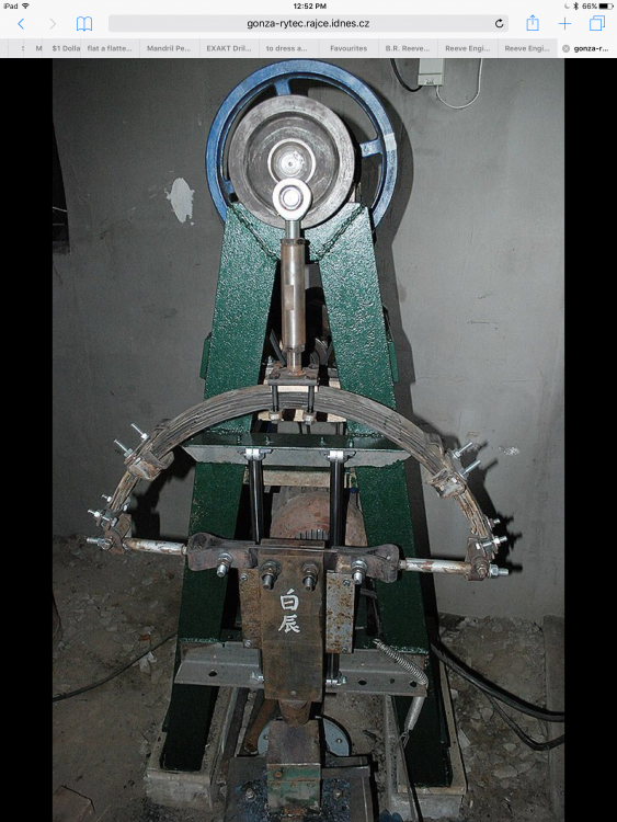

  13. What is the name for this type of mechanical arrangement power hammer? Eccentric wheel at top driving a horse shoe leaf Spring and tup linked in between.
