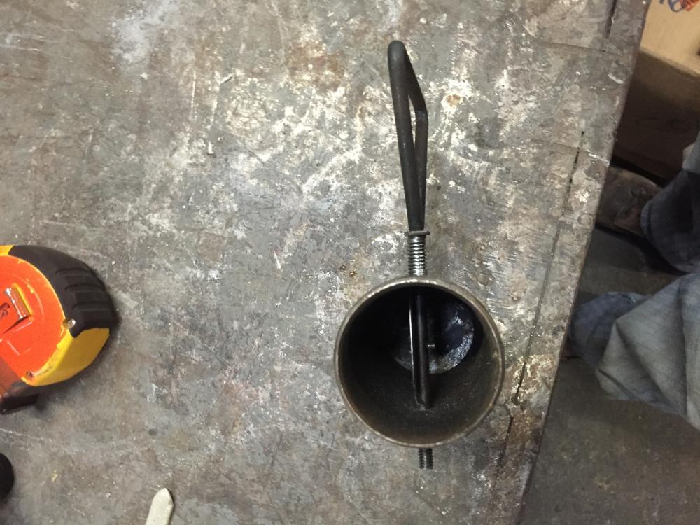

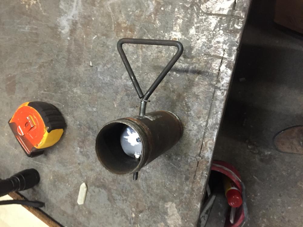

    Mikey98118: I am nobody's expert on ribbon burners but they seem very forgiving. After asking around a bit for specs on forge volume vs burner port area vs mixing volume and not getting much (I'm sure it's out there) I just winged it and I lucked out. I'm very pleased. I had a Pine Ridge ribbon burner that's 4 1/2" x 6 1/2" that's not supposed to be used for smaller volumes than .75 sq ft. I basically made one about 2/5 that size. 11 crayon size orifices in a 2" x 6" face. A baffle at the gas-air mix inlet is just a piece of flat stock about 1/2 as long as the burner centered with a notch in one long edge. A needle valve on the gas and a homemade butterfly on the air and I am very tunable. I say go for it.

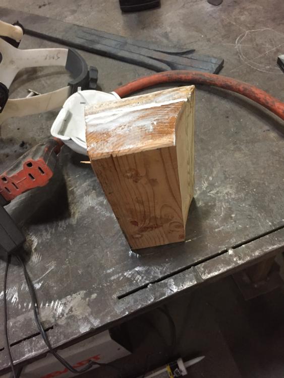

    Scrambler82- glad to help. To be clear, the inner steel shell is a mold for the casting which is not part of the finished forge. A steel liner on the inside would just burn up. But you could take Frosty's idea and use a sonotube or stove pipe for the inner mold and be on your way. Frosty- a longer floor has crossed my mind, but I worried about the temp differential/ heat sink causing potential problems. I usually go with an adjustable sliding stock rest built onto the stand. Just some square bars sliding in square tubing welded to the underside of the table. Also to be clear, the burner isn't exactly built in. I made a plywood blank- the "core" - that was a bit bigger than the burner and fit it to the inner arch form to create a void in the casting so I wouldn't need to break it out later to fit the burner in. The burner is independent and bolted to the stand. For that matter, the whole design is "modular" in the sense that the burner, arch, and floor are all independent and may be rebuilt/ recast separately at any time without disturbing the other parts other than to unstack the unit. The finished forge is dry-stacked and only the bolts through the flange of the outer shell to the stand hold everything in place. Anyway, good ideas all. I'm no expert I just wanted to share what has worked for me and encourage people to think at least as much about the box as we do about the burner. Think less about how fast your forge heats, and more about how fast your metal heats and maybe save yourself from breathing ceramic fibers and building disposable forges at the same time.
