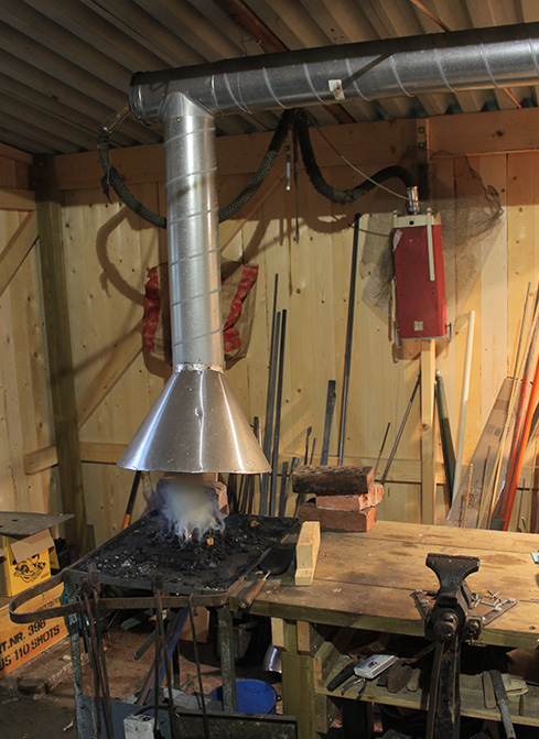

Has anyone successfully made a teliscopic hood?
setlab replied to setlab's topic in Chimneys, Hoods, and Stacks
A swinging design could work, I certainly have high enough ceilings for it to get out of the way. How well does that funnel hood work for you with a tall fresh pile of coal? Is something like that big enough for that amount of smoke all at once? -
Not sure if I'm using the term hood and stack right, in my mind the hood attaches to the stack; I want a hood that I can raise up out of the way. Here's a picture I came upon earlier I liked, I basically want a setup simmilar to this with a blower assist but I need it to raise up out of the way. -
setlab posted a topic in Chimneys, Hoods, and Stacks
When I was young I remember trying to cob one together with what I could find out of the metal pile and it worked horribly lol. Now that I'm older I'd like to try it one more time and am keeping my eyes open for ideas that work. My shop isn't 100% dedicated to blacksmith work and I try to keep everything on wheels to quickly move around as needed so I'm pretty sold on the idea, no talking me out of it I've never delt much with chimneys before so I really have no idea what kind of fancy products are avalable. I am working with the assumption that I will need some kind of helper fan to induce draft as my rooftop is pretty tall and the wind can get pretty nasty, a tall chimney is out of the equation unfortunately. What have you guys seen out there? Any suggestions? -
