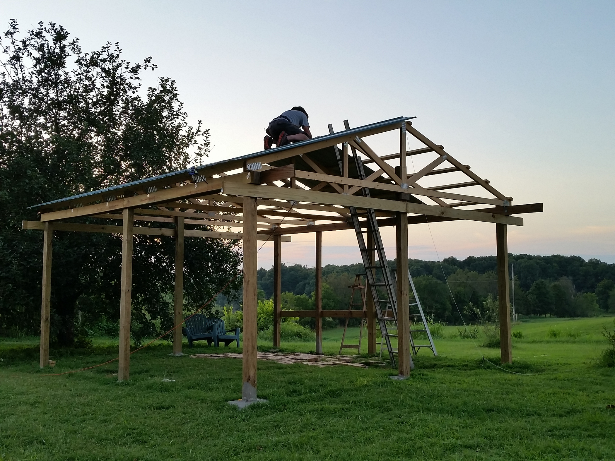

  6. Thanks guys, I appreciate the positive input. I've never built anything like this in my life and I did it without prints or anything. Just my tape measures, calculator and squares. Honestly I am grateful it is still standing.... oh and as you can see, my shop floor needs mowing....

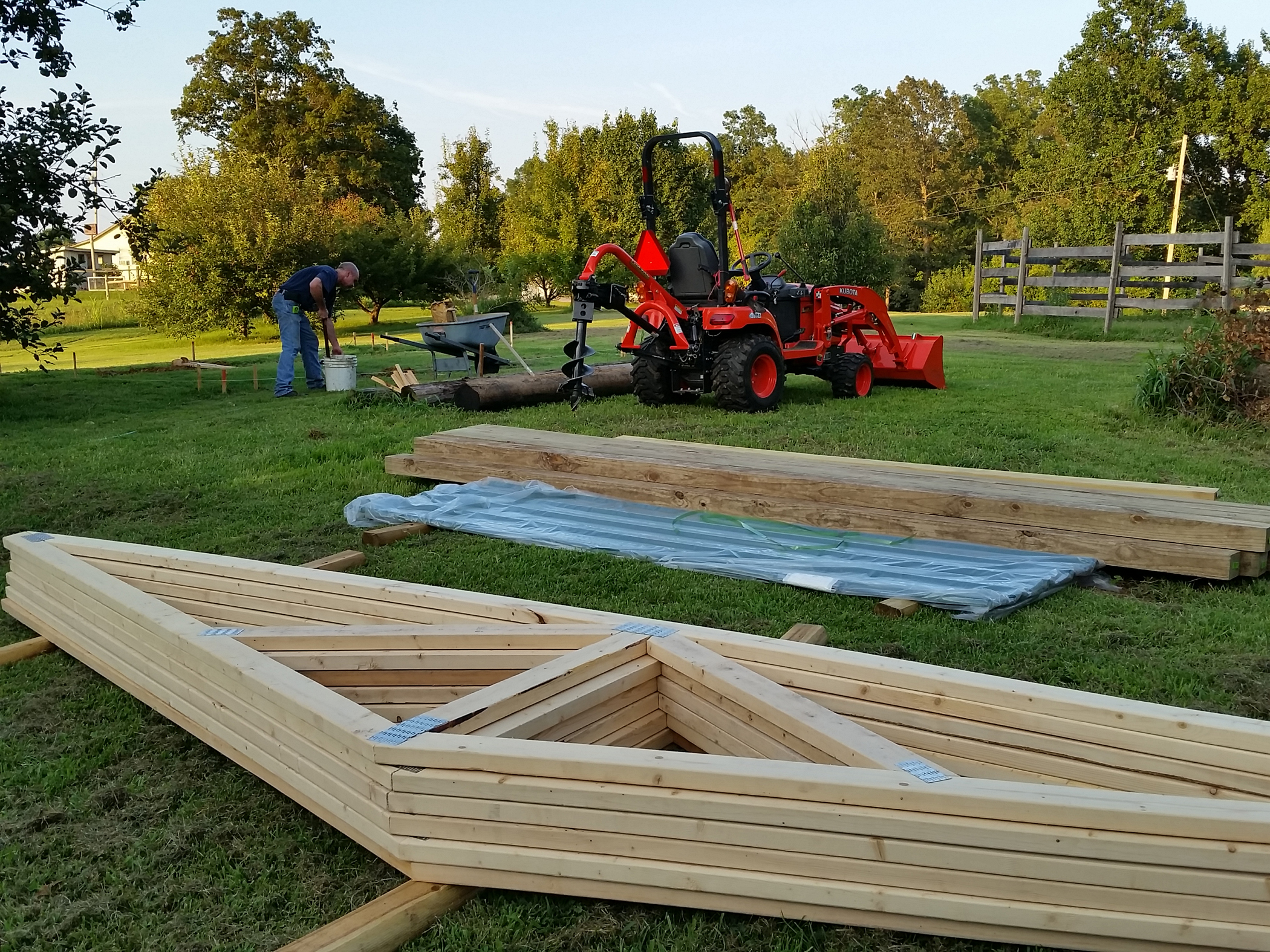

  12. So.... in the process collecting all my steel to move it over to my new shop..... I figure I have nearly 200lbs of S7 and D3 (punches and dies for tablet presses) I've been collecting this stuff for years and have never used any of it, I need to either learn this steel or scrap it. My question is; rather than annealing this stuff a few pieces at a time anyone reckon I can just build a large hardwood bonfire and cook the steel for x number of hours and achieve a suitable anneal?

  14. Honestly..... the auger is my favorite implement. I vowed never again to dig another post hole by hand.... we are overly blessed with rock strategically located in the exact places I have to sink a post. The bush hog is nice too.
  15. Thanks... I could have built a killer shop for what I am paying for the Kubota but I can't take care of the horse paddocks with a forge.

  17. I certainly believe you on the heat issue. The ridge cap will vent some, but I plan to place venting at each end to take advantage of our nearly constant easterly breeze, plus I should have a good cross draw with the shop doors open. Truthfully, we don't use air conditioning, we just acclimate each summer like our Amish & Mennonite neighbors so anything less than standing in direct sunlight is quite tolerable.
  18. I already have this fear that I don't have enough room....... I think the filling part is going to happen pretty quick.
  19. That's a great looking shop, brother.
  20. The following images are of my first shop space (build in progress). I first started smithing in '91 and this will be my first stand alone shop dedicated solely to metal working. I finally get my stuff out of the horse stall and I will no longer forge under an open sky. A little further along....

  24. Really great shop, outstanding job!
  25. If they hang your doors, then its a win..... and as we all know. A win is a win. If you still feel guilty after your shop is built you can always go back and forge replacements. Nice job on the shop.
