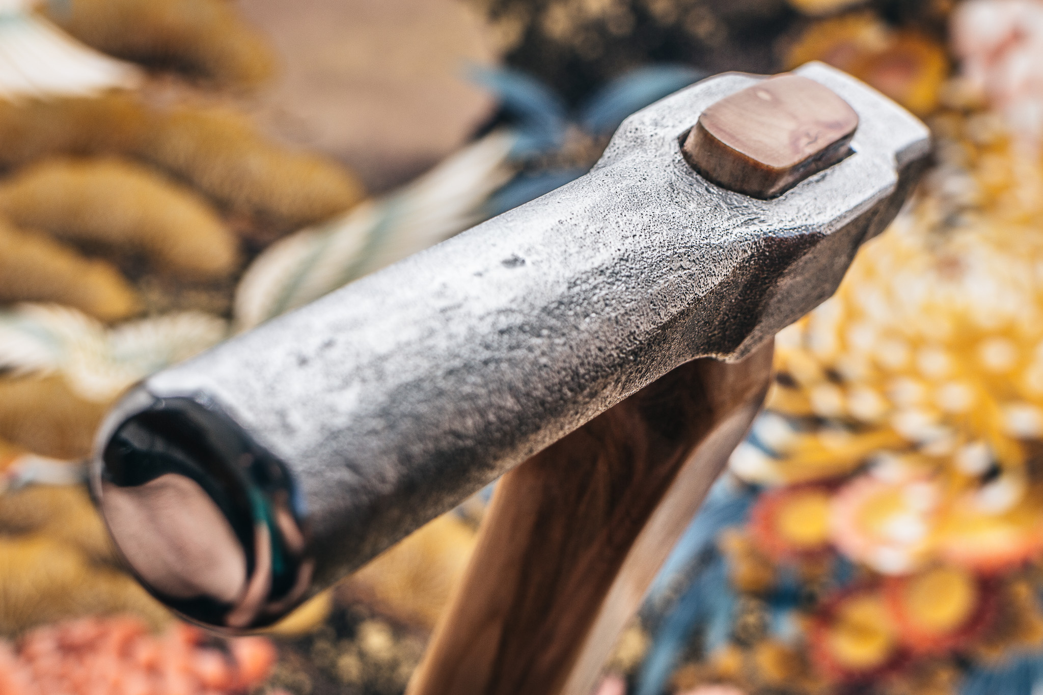

  6. No it's a standard hourglass shape. I figure that way metal wedges can be added or it can be re-handled in the usual way later on, plus once the glue dries it forms a mechanical lock as well as the adhesive one.
  7. I do it pretty much how Hofi does it here but I use shoe goo instead of sikaflex. After the glue has had a few days to dry I soak the end grain at the top of the handle in linseed oil.
  8. Thanks for the comments guys. It's not too pretty to use but so far I've been scared to throw it in the bucket with the rest of my hammers and scuff up the handle. I've done some test hammering with it but haven't used it extensively yet. I think 51200 will make a fine hammer as long as you get the temper right. I used a propane torch and drew the face to straw and the rest to blue but with a heavier hammer I would try to get the face a little softer.
  9. I recently found a roller bearing that I thought was the perfect size for a hammer for sheet metal work. A little slitting and drifting later and here it is. The head is a bit over 1 pound and I left the face fairly hard. The handle is apple which turned out to have some beautiful grain near the end, I'm hoping the knots won't weaken it too much. The head is attached with polyurethane glue. I don't use wedges anymore unless it's for aesthetic reasons and I have yet to have a glued head come loose. Thanks for looking.

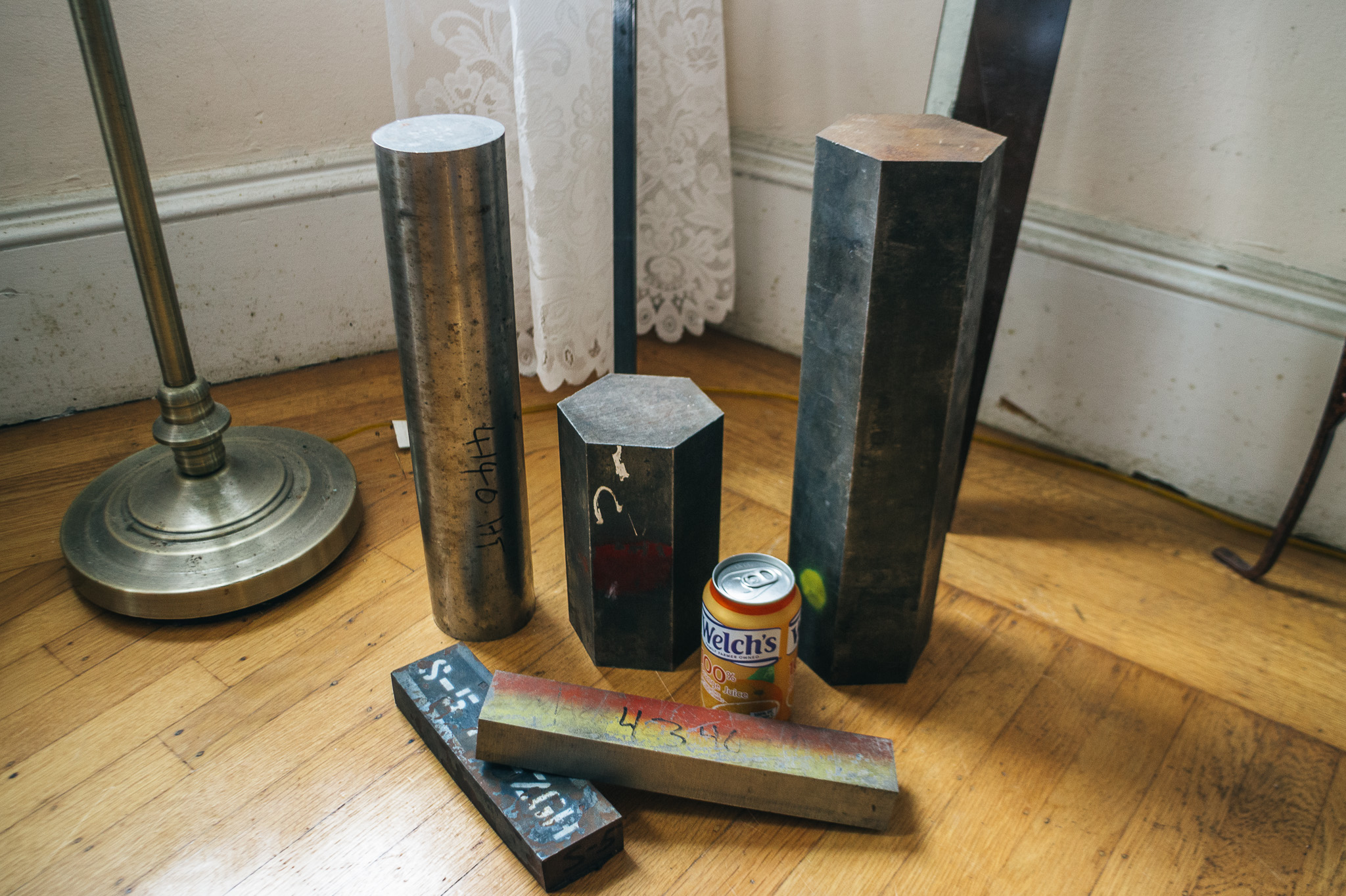

  10. Lol, I spark tested the Welch's but the orange liquidy sparks with no branching were inconclusive... I'm excited about the hex anvils, I want to make up some hexagonal wooden bases to match them.
  11. Here are some soon-to-be post anvils that I got from a machine shop estate sale. The round one is 4140, the hex pieces were unmarked but were in a big pile of tool steel. I also picked up a few random pieces of tool steel and some vintage paper micarta.
