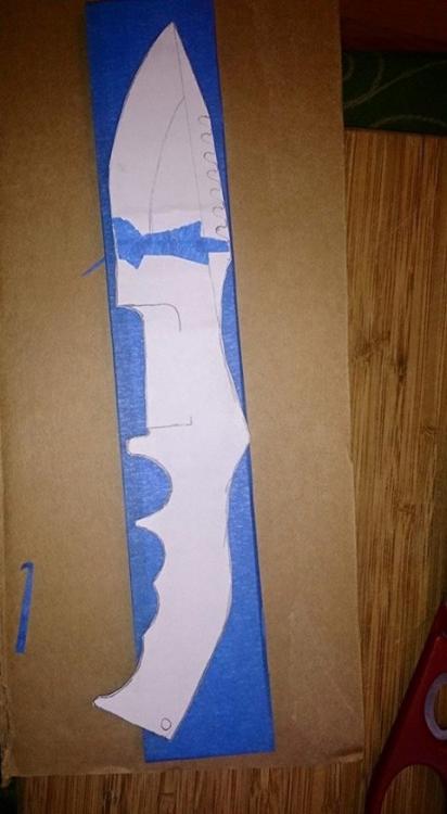

  5. ok thanks, i have the theroy down, but the main hands on not alot of it, this is the first complicated one im working on, my original plan was to cut the handle shape and then heat and simply bend it, would you suggest it, or should i hammer it abit to lengthen and then do the shaping?
  6. its for a trade, I can make knives, but its this handle i cant wrap my head around, and no worries about being rude, being blunt is the best way, im just trying to wrap my head around this style of tang
  7. ive never worked O1, its my first try for a customer, ive done only a eaf spring and smelted some ore i got from a mine car a feww years ago, small run LOL, some say its ok, while others swear against it. Malice, I believe I will do as you suggest, cut it out and do a bend, it will distort so should i elongate it a it before i cut it out, or cut it out then elongate?
  8. I'm working on a knife and the O1 steel is 2"x13" and I need it a little wider ir is 1/4 inch thick, the client wants it around that thickness if I heat and widen the steel alittle it will be ok, or should I get a wider piece of steel? Im a novice when it comes to a set pattern and bar steel lol, any advice would be greatly appreciated, it was mentioned to me that i should forge the first finger groove then start a bend like my template design, anyone have any tips and advice?
