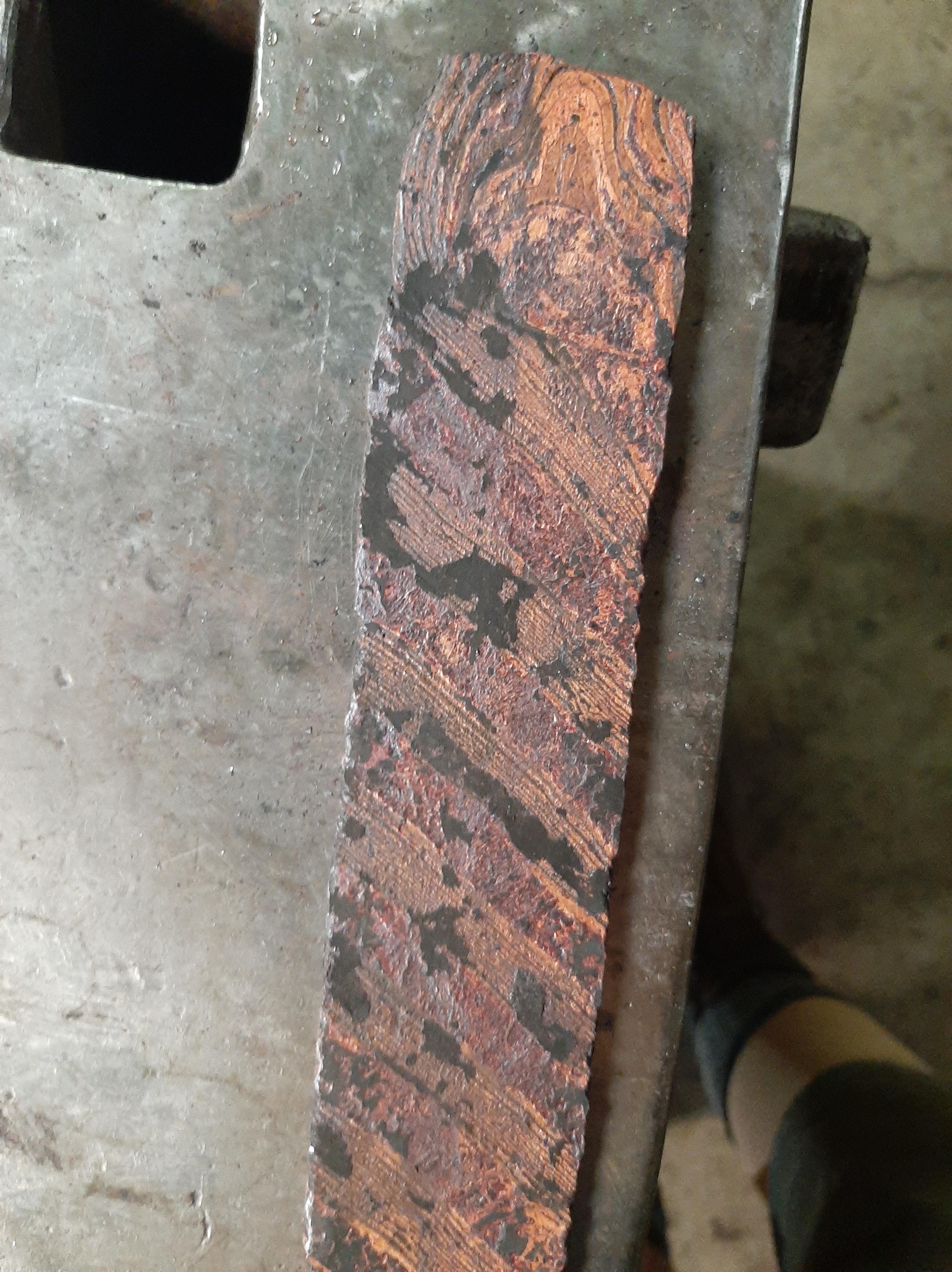

I have forged thousands of pounds of mokume in the last 15 years, usually starting with blocks much bigger than what you are working on. the key to successful mokume is keeping the surfaces clean prior to bonding. If you do that, then run a bonding cycle that is effective, meaning long enough and hot enough for the materials in your billet, you should have very good success. As you work the billet, take time to grind out layer separations and cracks. When twisting, I always forge to an octagon first, then twist, then forge to final size and shape. This minimizes the risk of getting corners that tear apart or form laps during later forging. I don't do much cold work. You can do a little bit, but brass and nickel silver (which are common elements in the billets I'm forging) do work harden fairly quickly so if you were going to do much cold work you'd need to anneal frequently.

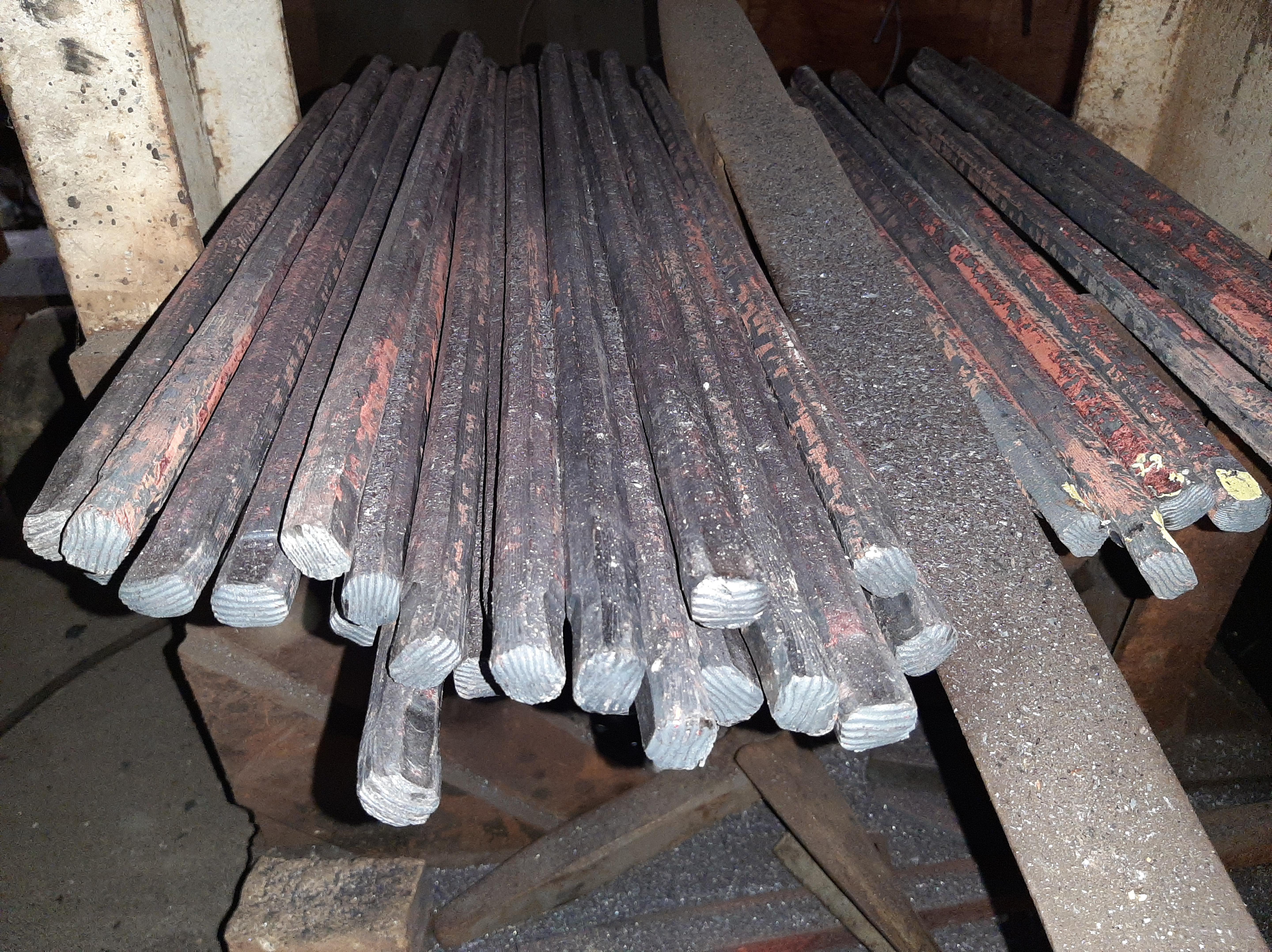

Frosty- The mokume I forge is all bonded by Mike Sakmar, who is using the methods described in the book "Mokume Gane in the small Shop" by Steve Midgett. A digital copy of that book is available free on Mr. Midgett's website. There are several methods used in the book. The method used for the billets I work with is to clean the pieces to be bonded in a strong acid, rinse in a solvent like acetone, then layer up the billet. From the point of cleaning onward the pieces are handled with gloves to avoid getting any finger print oils or other contamination on them. Once the stack is complete, it is wrapped in stainless heat treat foil. It is has been many years since I've visited the shop where this happens and I don't have pictures of this part of process, hence the reference to the book above. If I remember correctly, I think a small amount of charcoal may be added to the foil package to serve as an oxygen consumer, but I don't recall for sure. Once the billets are wrapped in stainless foil, they are clamped between flat steel plates with bolts at the corners. They are put into electric kilns and heated to the desired temperature for a time commensurate with the size of the billet, but usually an hour or two. Bonding temps are picked based on the alloys used, but will be a little bit below the melting temp of the alloy with the lowest melting temp in the billet. After the bonding cycle is done, the billets are removed, clamped in a vise and the bolts removed. The foil wrap is ground or machined away leaving the billet sides smooth. That is what I get. (picture below).
My forging is done almost exclusively with flat dies, and all under my 300 # Bradley. Sizes I make are dictated by my customer, (Mike Sakmar) who owns the material and pays me to covert it to his desired sizes. Common sizes are 0.230x01.675 flat (twist before flattening) and a variety of octagon sizes. Occasionally there will be some larger flat cross sections like 5/8 x 2 1/2. Most material is twisted to generate the pattern. When some other pattern like raindrop or ladder is desired, I forge to a specified flat bar size, send the metal back to Mike who machines in the desired pattern with a ball end mill, then it is sent back to me for forging to final thickness. I've been doing this work for probably 16 years or more and most of that time the twisting has been done by hand. A few years back I did add a twisting machine to the shop, which is simply a very old (line shaft driven) pipe threader modified to take the flattened end of an octagon in the "chuck end" of the machine.  Mike does sell his material to anyone, though many of his customers are from the knife making and fidget spinner community. You can google him to find his website.
Because these are copper alloys, there is no need for a hammer as big as mine, it's just what I have. I will say though that I much prefer a hammer to a press. Presses are much slower than hammers and though they'd work fine for the initial break down of the billets, they pull heat out of the work too fast for effective forging of the thin flat bar and plate often make and they are just too slow for drawing out small cross sections. The 0.230 x 1.375 flat size I usually forge to 3/4" octagon before twisting, but I do that using die bites that are about 1/2" long. That is  a LOT of strokes and most presses a just not that fast.
Most of the success or failure associated with forging mokume is not in the tooling but in how you USE the tooling. As mentioned, almost everything I'm doing is with flat dies, but how big a die bite you take and how hard you hit the metal changes as the job progresses and if you don't do that right you will end up splitting the billets apart. Describing that detail is pretty hard in text, but the approach is not that different from what you'd used when forging very slaggy wrought iron.
