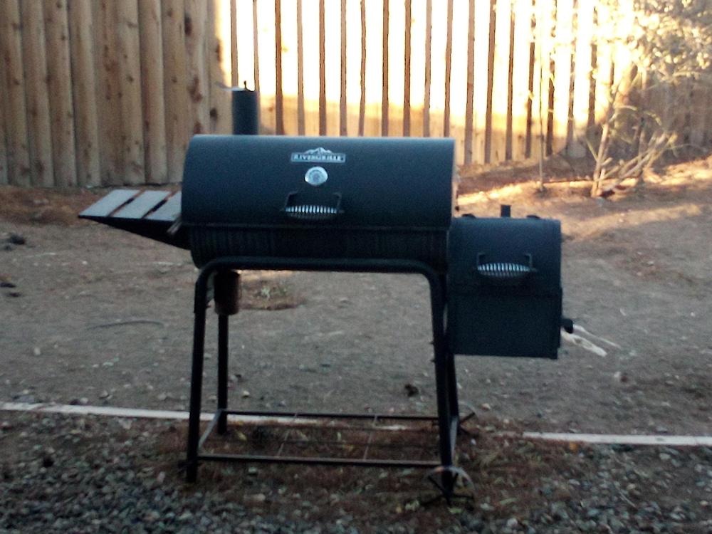

I have a smoker grill that I no longer use. Can anyone point me to a possible DIY coal forge tutorial or plans?

I took a 'Barbie', about the same size and made it into a 'Wood Burning Forge'. A family in Washington (the state) has been promoting their Wood Fueled Forges at quite a few North West Blacksmith Association Conferences (NWBA). They work well and you don't have to Coke the Wood, beforehand. It is a case of K.I.S.S. I love it!!

I didn't build a coal forge, but I did use a grill for a charcoal/wood forge. In addition to a JABOD (Just a Box of Dirt) forge thread here, Torbjörn Åhman builds one ion his youtube channel.
JABODs and JAGODs aren't hard to build, they really work, and you'll quickly learn what works for you and how to adjust the design for your process. Plus, if you decided blacksmithing just isn't your thing, you've spent next to nothing other than a bit of time.

A forge is literally a "fire place," all you need is something to hold enough dirt to protect the container from the heat and a length of black iron pipe to deliver the air blast. The rules of thumb are simple enough. What works well for dirt in a JABOD is 3+/- parts clayey soil, (NO rocks or large pebbles!) to 1 part sand or crushed ceramic "grog". The sand/grog provides passageways for steam to escape when you build a fire and it allows the clay room to expand and contract with thermal cycles without cracking and falling apart. Only make the mixture JUST damp enough to pack hard with a mallet, end of a 2 x 4, etc. Do NOT make mud, mud WILL check as it dries! Pack a minimum of 4" of dirt under the fire so the heat won't damage what you use for a stand or burn the box if you use a wood box.
Place the tuyere pipe (air pipe) horizontally through the box so it is 1" - 2" above the bottom of the trench. This is a "Side Blast" as opposed to a bottom blast, forge. Orient the tuyere 90* across the center of the trench aimed SLIGHTLY downwards. Some folk put a fire brick across from the tuyere as a fire back, some drill a hole in one to put the tuyere through. Don't get carried away, it's just a box of dirt and one of the really beautiful things about a JABOD being, when you're done for the day and the fire is out you can dump it into metal buckets so it's light enough to carry out of the weather. Hmmmmm?
No matter what you burn, wood, coal, moose poop,(don't laugh, it works) etc. it does NOT require much air blast in a JABOD, a shop vac is so completely, ridiculously too much air it'd be silly if you were running 5 forges off one. So are mattress inflaters but those CAN be made to work by aiming the output away from the end of the air supply so a small fraction provides the air blast. The hand pump mattress inflaters work well and a box bellows is really simple, a box knife, some tape and an old vacuum cleaner hose is plenty.
Anyway, your old BBQ will make a Cadillac of a forge, wood or coal and it'll have plenty of space on the forge table to hold and coke coal. Charcoal is a little trickier as if it gets burning you have to douse in in water or it WILL burn until it's all ash. How likely is it to get a spark or burning coal into your ready pile of charcoal? Seriously really likely, a little too much air blast and charcoal sparks and pops vigorously. We call those "fire fleas" and they love getting into things they shouldn't. Putting an airtight lid on your charcoal stash is always a GOOD idea, it will keep it dry too and charcoal CAN suffer compost decomposition, generate heat and spontaneously combust. Fireproof, airtight storage is best but dry and away from structures works.
By charcoal I'm not talking about briquettes, those are compressed cakes of powdered charcoal and ae made to produce low heat for the BBQ. What you want is plain wood charcoal, you can buy it or make it. Making it is easy and there are threads devoted to making charcoal.

For first projects I show folks how to make a wall mount coat hook. Unless, like you, they want to build a forge. Then I start them out with a set of basic forge tools, poker, rake, shovel. Tongs can come later. Also, hand forged fire tools sell, especially when the blacksmith can custom make a set to match the customer's fireplace, fire doors, etc.

whittler The charcoal Frosty mentions is the real stuff. You can make a charcoal kiln (I have a thread about how I made mine, nihittlercknamed Burnie) or you can get 20# bags at your local grocery store that will work well enough for you to find out if you want to try it. What a JABOD/JAGOD is good for is you can make it quickly, fire it up, and see if blacksmithing makes you happy.
Whatever you do, have fun and good luck.

I like what you said about using the smoker as a forge because it has extra room for tools, etc. It's funny how everybody wants to make the entire container a forge instead of separating it into workspaces. The forge doesn't need to be big (usually) but it needs to be controllable so it can get to heat and use fuel efficiently. Solid-fuel forges are fun but only if you can get to heat quickly enough to get work done.
