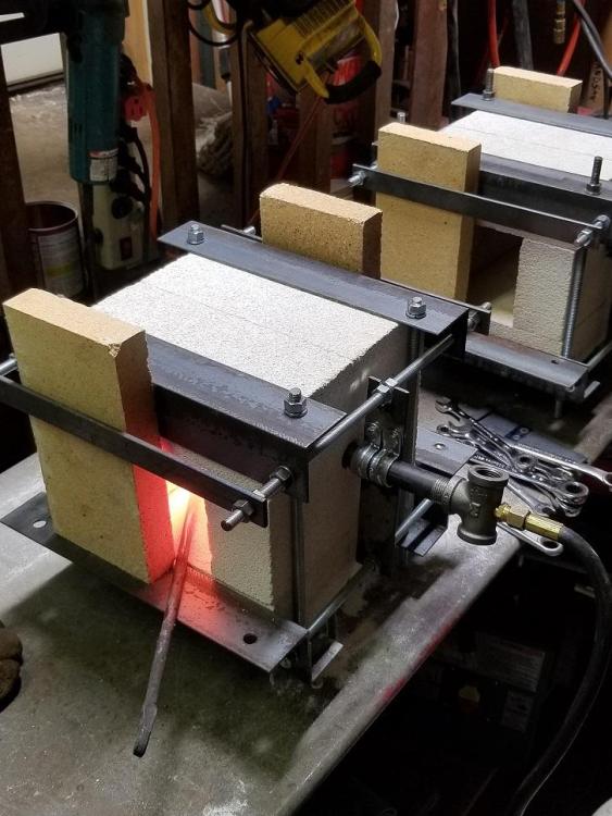

Mikey98118 Posted December 20, 2024 Share Posted December 20, 2024 On 12/18/2024 at 5:50 AM, Latticino said: I have had problems with even the better K26 insulating fire bricks (light brick) cracking under repeated thermal cycling. I feel you need to allow for this and to put the bricks under some compression with the external frame. Make sure this frame is protected from the combustion exhaust from the forge (dragon's breath) or it will heat, expand and be less effective. I have worried over this for some years, and decided that the addition of small springs at one end of the threaded rods, trapped between the angle irons and a flat washer would make a valuable addition to this forge design. One aspect of this idea that is pleasant,is that,, so long as additional length for the springs is included in the threaded rod, they can be added at any time. Quote Link to comment Share on other sites More sharing options...
Frosty Posted December 21, 2024 Share Posted December 21, 2024 The brick pile forges we made at a club forge and burner clinic are all going strong only needing repairs from drops and getting banged around. The K 26 IFBs haven't suffered from thermal cycle damage. The below pic is from the day of the clinic and I didn't make one for myself but they're all the same. The allthread, nuts, bolts, etc. aren't "tight" but there is no slack. 1/2" T burner brought this one to welding temp in under 4 minutes. Pretty typical for the clinic's 21 forge run. Frosty The Lucky. Quote Link to comment Share on other sites More sharing options...
Latticino Posted December 21, 2024 Share Posted December 21, 2024 Frosty, I assumed that by design someone cleverly kept the tensioning members on those forges out of the direct path of the flue gasses. Yours is exactly the design I would have used if I needed to make another small forge. Pretty clearly the tension on the bricks is enough to hold them together without crushing and the mobile ones are hardbrick. Likely not an absolutely optimal design, thermal efficiency wise, but certainly more than adequate for most users - and you can't beat the price or ease of assembly. If you can source Z channel you don't even need a welder. Quote Link to comment Share on other sites More sharing options...
Frosty Posted December 21, 2024 Share Posted December 21, 2024 Why thank you. The only thing I put into the plans they changed is flipping the angle iron the door baffles ride on upside down. It was supposed to let the baffle ride lower and further block the angle iron from the heat. Turned out not to be an issue, the door baffle track(?) hasn't warped from what I've heard. Frosty The Lucky. Quote Link to comment Share on other sites More sharing options...
