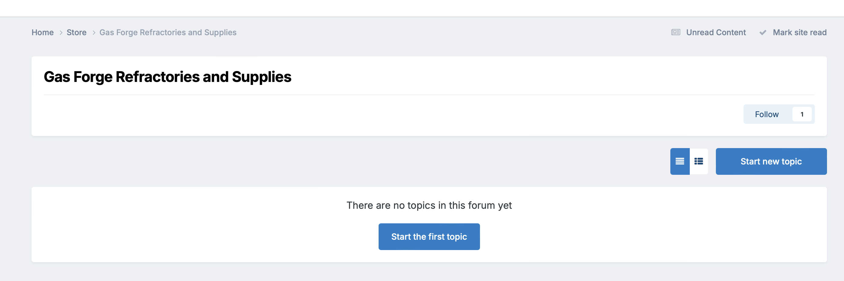

  4. Hey Frosty, I did actually click on the Gas Forge Supplies tab like you said prior to posting, but all I see is an empty forum. I'm guessing you see something I don't? Re Google: Sometimes, knowing the right keyword makes all the difference. I now see several options near(ish) to me. Thanks for that.
