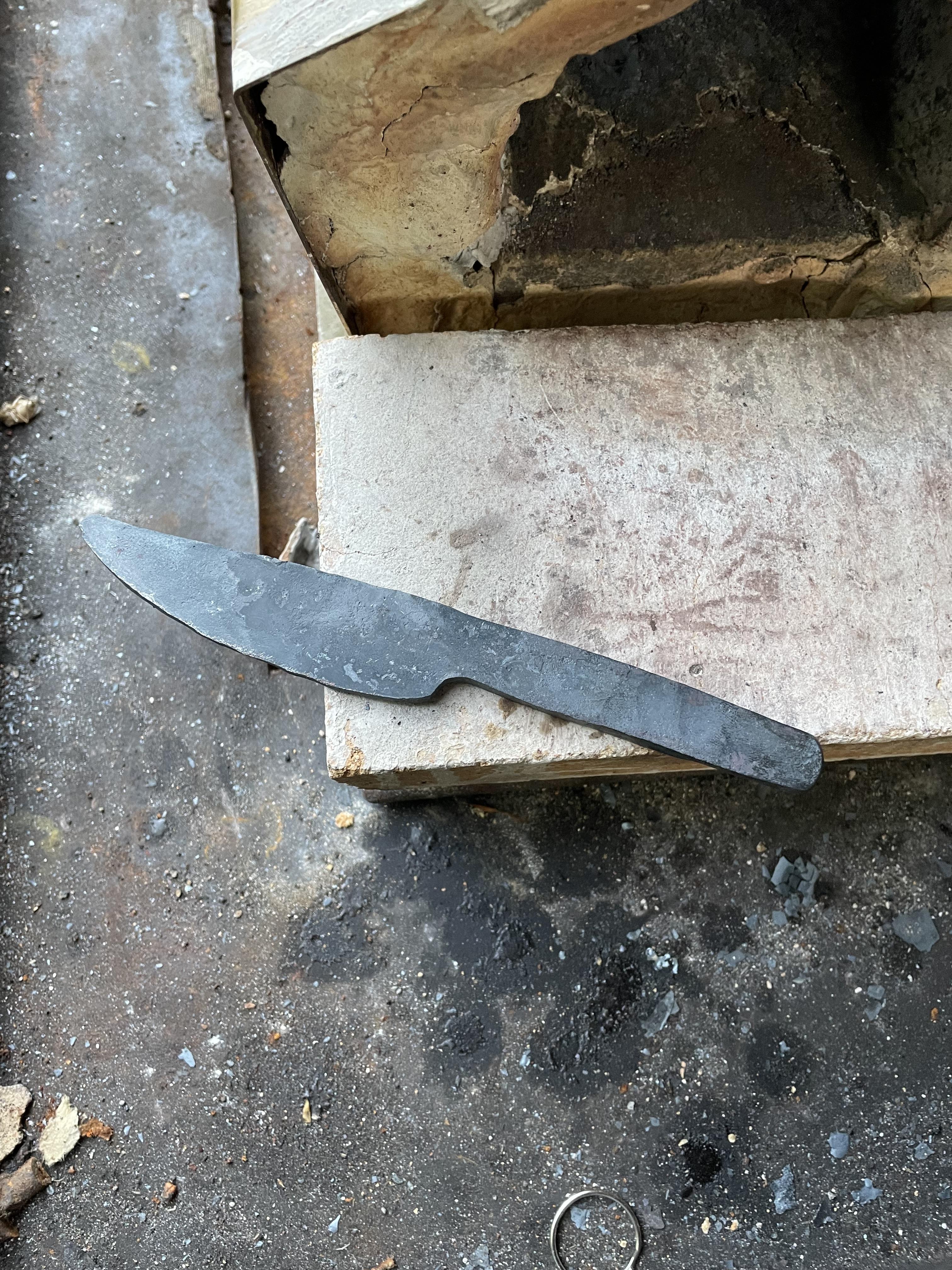

I will be the first to admit that I am not a bladesmith. I am a blacksmith, but I wanted to make a vegetable knife for a travel kit.
now, having never made a knife, I come upon the question of finishing the handle. I have searched without luck to understand precisely how to cut handle scales from raw seasoned lumber, and once cut, how to pin and finish without epoxy.
i would like to do this all without “modern” adhesives, if possible.
my thought is simply to take a length of seasoned locust, cut it into rectangles, then drill and use a small diameter copper rod/rivet to attach the scales together, then sand and shape and finish with mineral oil.
is this a recipe for splitting/cracking?
here is the knife:
the tang is about 4 inches or so

Your general strategy should work fine, and is a fairly traditional method for handling a "patch knife".  A few things to consider:
  1. Drill pin holes in the tang before heat treatment
  2. Don't forget to anneal your rivet material.
  3. Make tang as flat as possible to mate up cleanly with the wood scales (sand those flat on a surface plate or piece of tempered glass as well)
  4. Consider use of a period adhesive if possible (i.e. rabbit skin or horse hide glue).  If you do a nice sequence is:  drill pin holes in tang (I like three 1/8" diameter, but you go with your preference), glue one side scale on and drill through the scale using the tang holes as a template, glue the other side on and drill holes through the second side from the holes already drilled in the first side
  5. Take care riveting the pins in place to avoid too much stress on the wood from expansion.  If you go the period glue route, you might be able to shape the scales in place first, then rivet.  If you do that a nice enhancement that is very period is to add a washer (brass or copper) on each side of the rivet which can be hammered to a slight dome shape.

Thank you for this: this is the guide I needed. Most that I was finding were for 'bladesmiths' already familiar with the process of making handles.
As far as wood goes, I have some well seasoned locust: I was planning on cutting it down to 1/2" thick or so for each of the scales, trying to use the best grain I can find.
Is there anything I should do to the wood before I follow those steps?
As long as the wood is well-seasoned, you should be okay. I would only add two suggestions to Latticino's:
  1. Another period-correct adhesive would be cutler's pitch, which is a mixture of pine resin and filler. This is applied hot to the two pieces, which are then put together and allowed to cool. Two old recipes are:
    1. One part resin to one part brick dust.
    2. Four parts resin to one part beeswax to one part brick dust.
  2. Don't use mineral oil; it doesn't dry. Use linseed oil instead.

We need to distinguish between finishing and stabilizing the wood. Stabilizing is when you completely fill all of the pores of the wood with a rigid material, often using a vacuum chamber to get the stuff all the way in. (For example, "Cactus Juice" is a popular brand of polyester resin that is cured in an oven; there are also low-viscosity epoxies that cure by chemical reaction.) Finishing, on the other hand, is applied only to the surface, and while it does inhibit changes in the moisture content of the wood, it doesn't stop it entirely. Some finishes do penetrate some way into the piece, but they don't fill up the pores all the way through. Thus, a stabilized piece will be dimensionally stable and unaffected by moisture, while a finished piece can still expand and contract with changes in atmospheric humidity or through getting wet while washing.
Also, oil finishes cure by oxidation, not by heat. Soaking a piece of wood in oil and baking it might speed up the oxidation slightly, but only on the surface.
In short, unless you are willing to invest in a vacuum rig and the appropriate resins, your best bet is to make sure the scales are thoroughly seasoned and properly finished, and then take good care to keep the knife clean and dry when not in use. Either that, or invest in some pre-stabilized knife scales from a knifemaker's supply house or use a more stable material such as bone.
