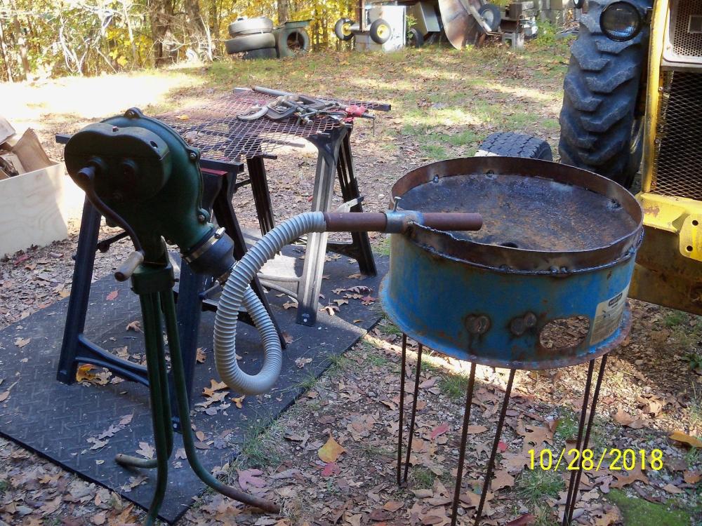

I made this side blast out of the base of a water pressure tank back in 2018 it worked like a champ with the Champion 140 blower. I emptied the dirt out of it, planning to reline it with some fire clay for a more permanent table & fire pot. Sad to say I have not gotten around to that yet.

A 55 talon drum layed on its side and cut in 1/2 for 2/3 of its length, and the cut off used to make the beginnings of a side draft hood works very well, as dose a drum set up on 24” legs (4 deep cement blocks) with this you cut out the side , to leave an 8” deep fire pan and a fire place looking opening that goes just a bit past 1/2 way around (let’s you put long stock all the way threw the fire) and swept in a bit of a curve.
tho lots of things work, anything deep enough you can get enough insulation (dirt) to keep from burning out the bottom and large enough to hold the work and a few tools.
Fit, I put the blower on the right and reach over it, so I can crank wile manipulating my tongs. Most blowers were for ricotta forges, were you threw the rivet to the riveters to catch in a bucket with your tongs in the right hand
