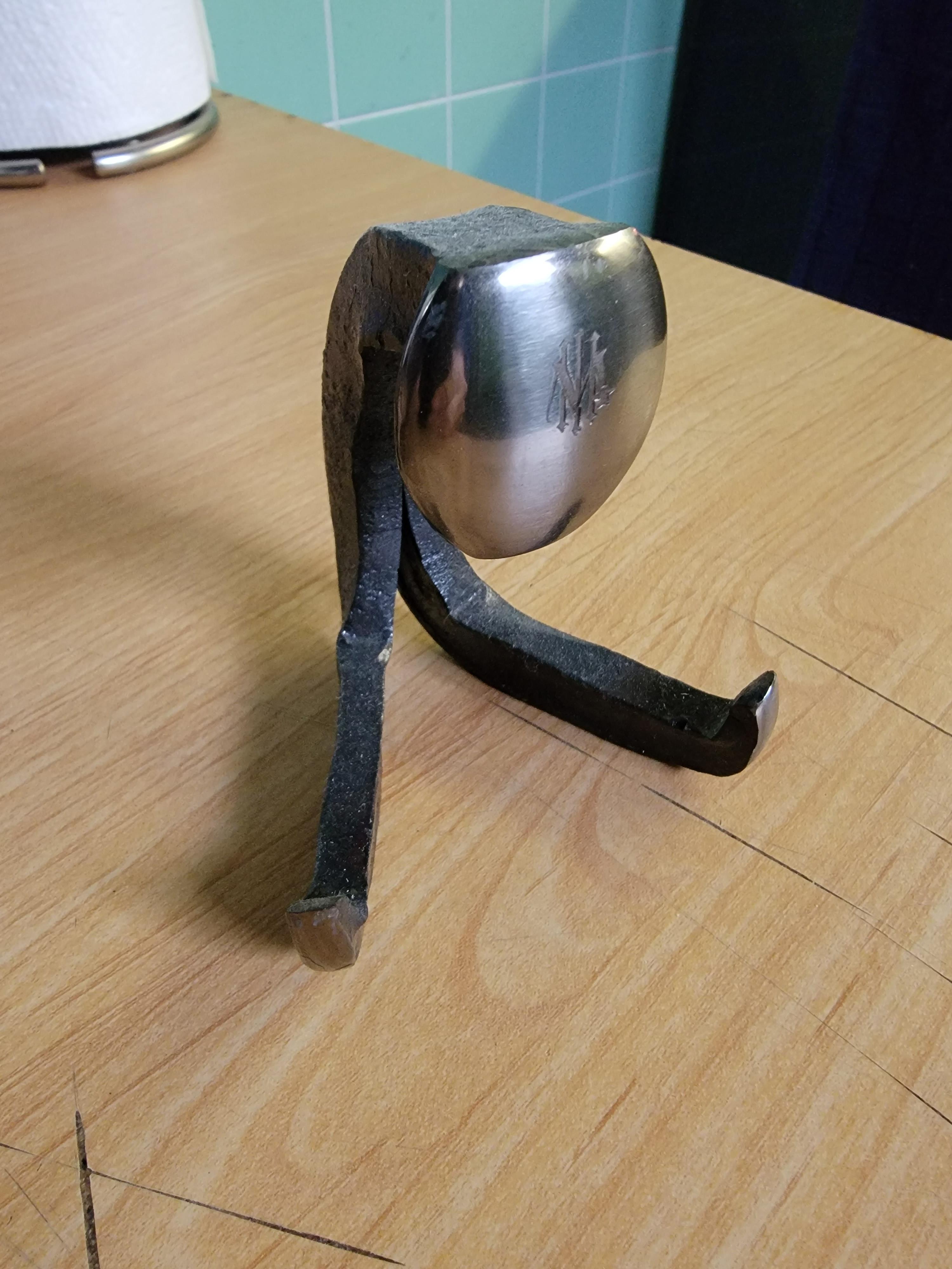

M3F Posted November 6, 2023 Share Posted November 6, 2023 If it were me I'd go with a theme. BBQ tools all made from RR spikes. Find a source for those and get down every blacksmiths twist you can for the handles. I would BLO all BUT the parts that contact food, for that just a super light coat of olive oil or the like. I would also get a bunch of corks like from an antique shop and cork all the pointy ends. (Meat turners, 2 pronged forks) figure out a price per and offer 3 for a bit less. Since they'd all be RR spikes the customer could mix and match whatever 3 tools they wanted. For Meat turners they're left or right handed depending on the way the hook points so you'd have to label them. Id also put a print out of care instructions for the tools. Hand wash only, hand dry and coat with food safe oil. Other than that I have a business card holder I made from a RR spike awhile ago that would also fit the theme I'll take a pic later. If there's still space you can't go wrong with plain old S hooks. Oh and a hole with a leather strap at the end is a nice touch too. Quote Link to comment Share on other sites More sharing options...

M3F Posted November 6, 2023 Share Posted November 6, 2023 It's just split down the middle for the legs. Only tricky part really is to bend the head so the thing sits level without toppling over. Quote Link to comment Share on other sites More sharing options...
