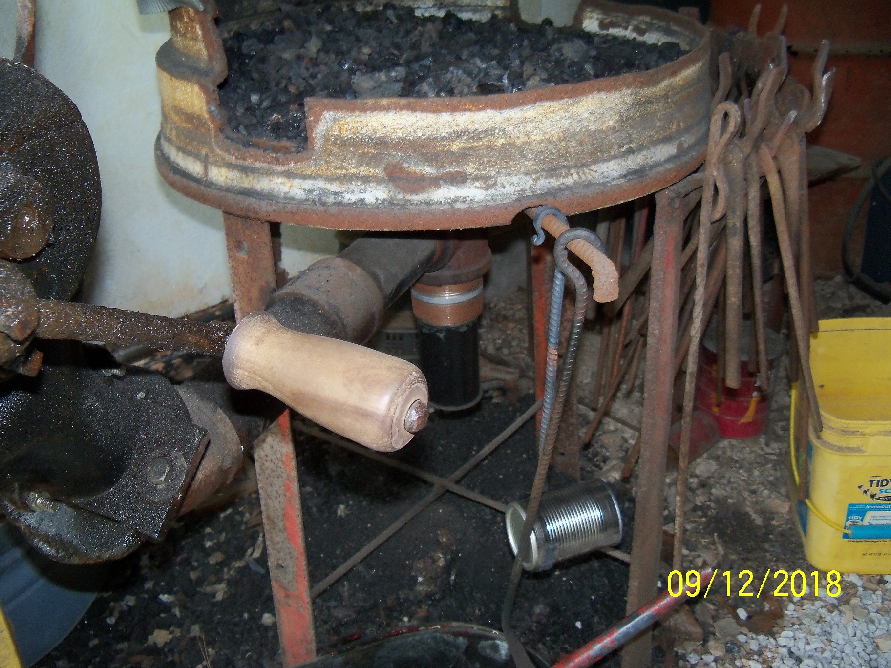

18 hours ago, Caballo bueno said:
It's for a blast forge
side blast or bottom blast?
19 hours ago, Caballo bueno said:
sometimes there is coke other coal
What kind of coal? coking coal(blacksmith/metallurgical) or anthracite.
To create a neutral/reducing heat, ~4" of coke under your work and 2" above will work, no matter what kind of forge you have. If you use coking coal, you should only have coke in your firepot, not uncoked coal.
