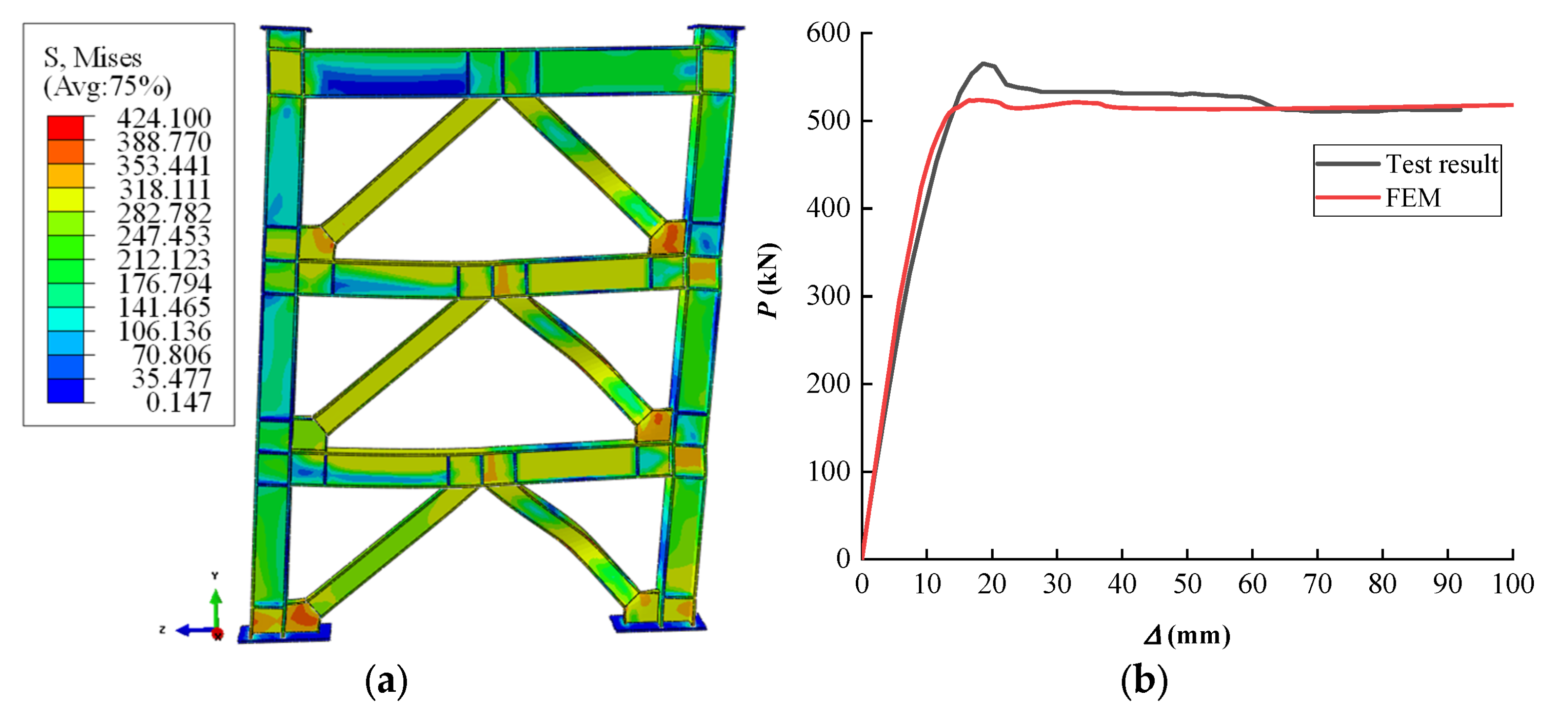

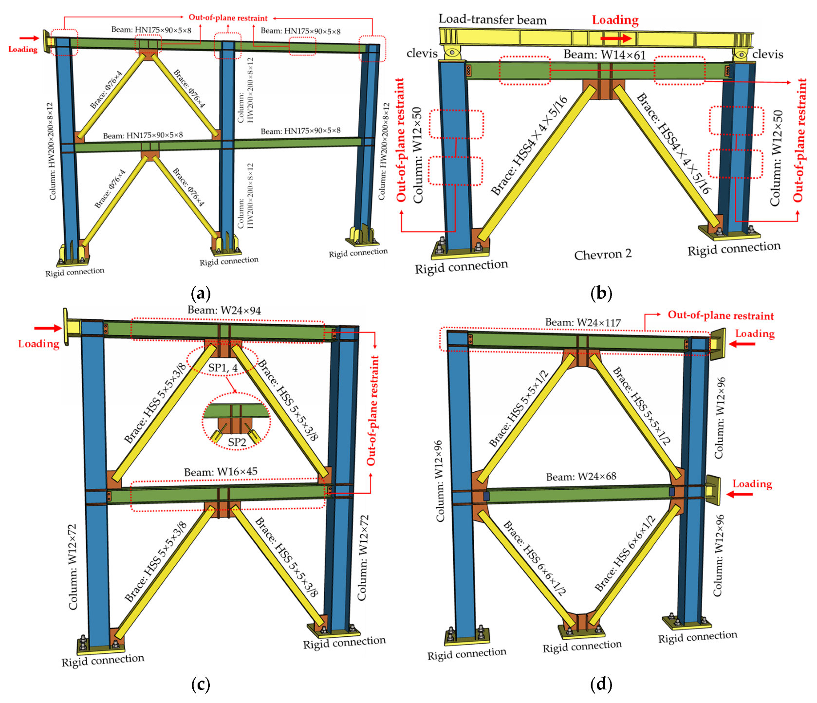

hi, sorry for the bizarre and bizarre question, could some kind user with notions of engineering and physics kindly explain the chevron beams, in Italy I think they are the diagonals or the arrows or braces, I think they are used to strengthen the portals or the connection between the column and the crossbar to avoid that the angle closes, to reduce the light the span of the bridges am I right? are coupled by welded plates right? on wikipedia or other search engines I have not found any feedback, thanks and sorry for the bizarre and bizarre question, thanks again greetings.

Nothing bizarre about the question Angiolino. The diagonal members prevent the structure hinging at the corners and collapsing. If you built with just vertical posts and horizontals top and bottom, any lateral force will cause it to move, the connections acting as hinges. Add a diagonal (cross brace) and the structure can NOT deflect without crushing or tearing the diagonal. These are good experiments to model with "popsicle" sticks and tacks or an erector set.
It makes a simple square or box into a number of triangles and triangles are as strong a structure as can reasonably be made.
