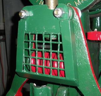

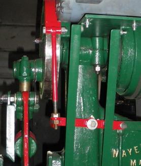

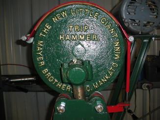

This is what I was doing. Brake and scatter shield for the spring. The shield is grizzly screen so I can see the spring. If crack develops the paint will peal providing advanced warning. I needed to make the brake band longer, I might extend it one of these days but this one works okay.
