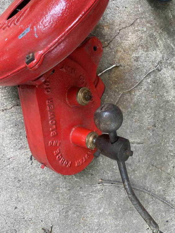

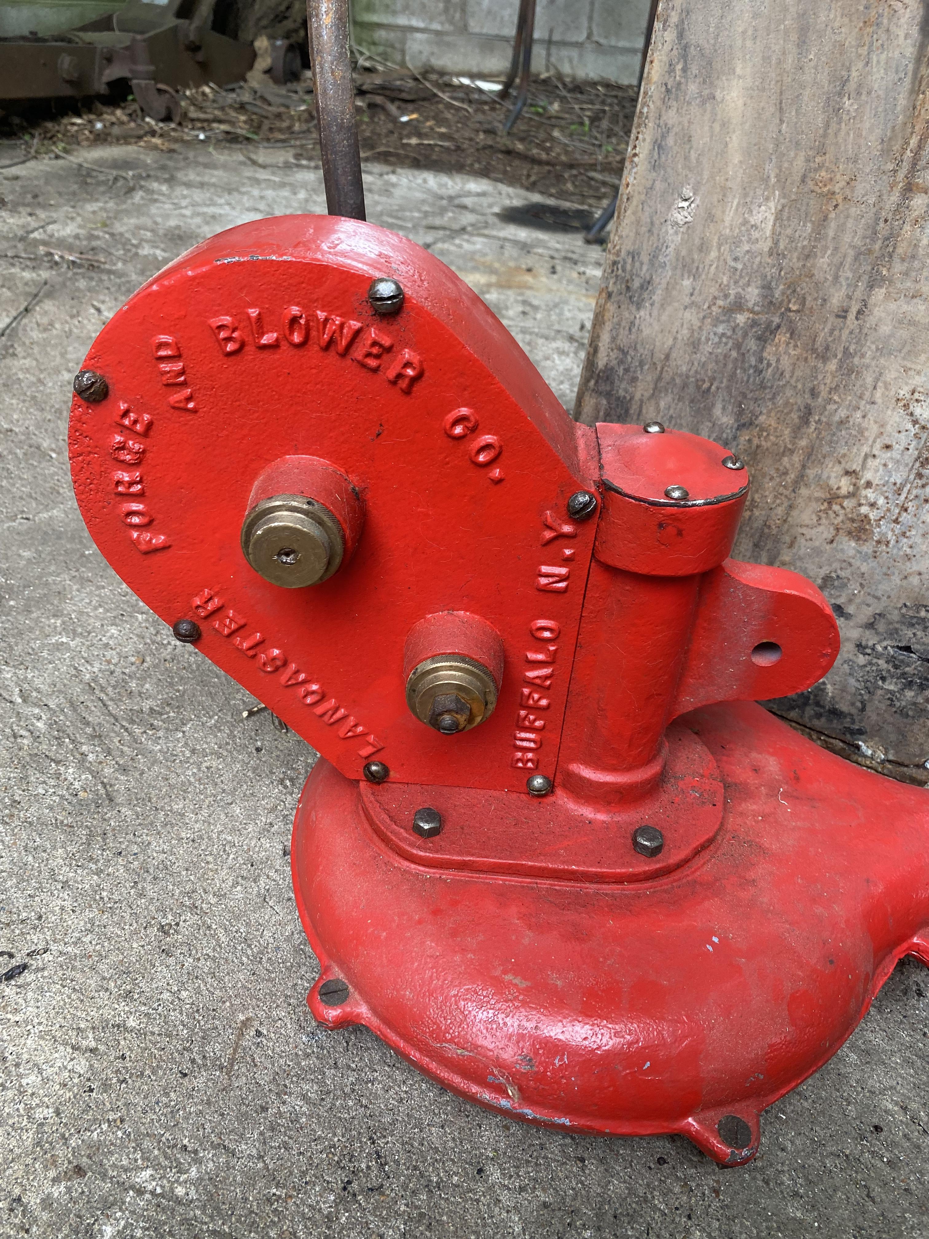

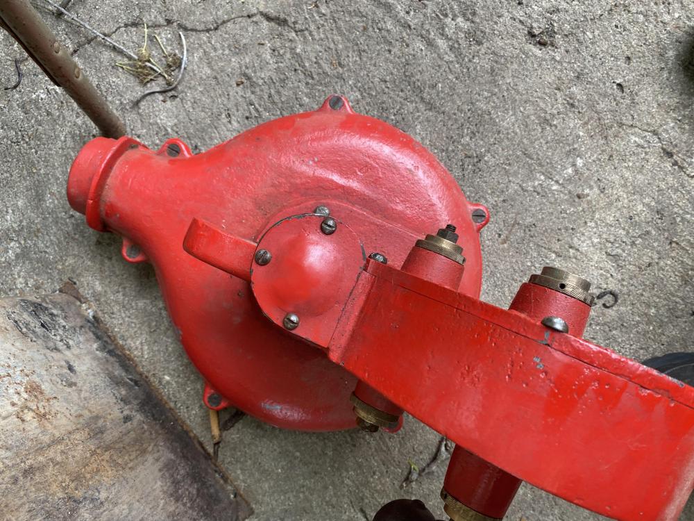

I got this in a trade today, and I’ve never seen another like it,
it’s a “Lancaster forge an blower company”401 model made in Buffalo New York,
(NOTE) every champion I’ve ever seen, found, had or have had, says the words blower and forge company
NOT forge and blower company,
it’s overall shape resembles a champion 400 but it’s most definitely not a 400 by a long shot!
it’s has bolted on access plates, one on the back and one on the side,
brass holders for the shafts,
and a completely different mount than a 400,
has anyone ever came across one of these? Are they some sort of copy on champions design from the competition?

Randy,
I’ve seen that one when I was looking for it, if you zoom in an the picture that’s actually a champion 400 blower on that forge 401 forge,
Yeah when I tried every search term I could think of I came across a couple pictures of those,
if you look at that one you can see the two screw access cap on top with all the writing, and the grease caps,
and it’s got that 400 style that’s got the two ribbed shaft that slides into different champion mounts,

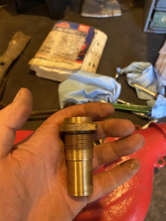

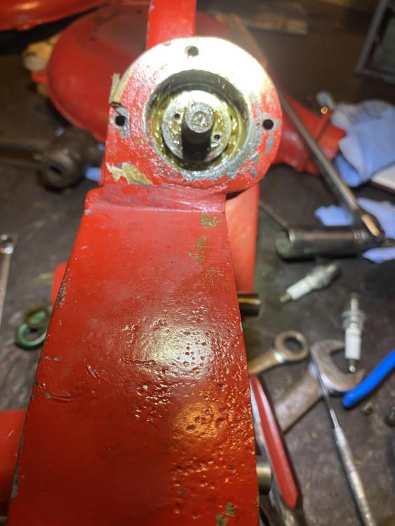

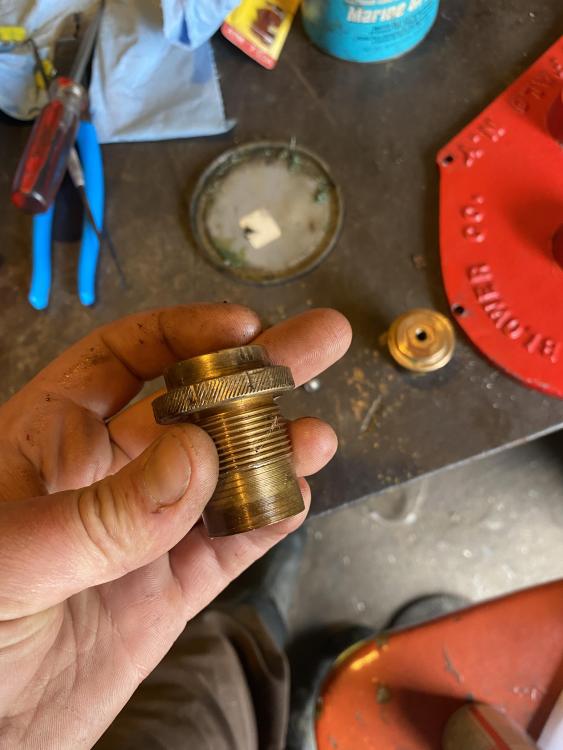

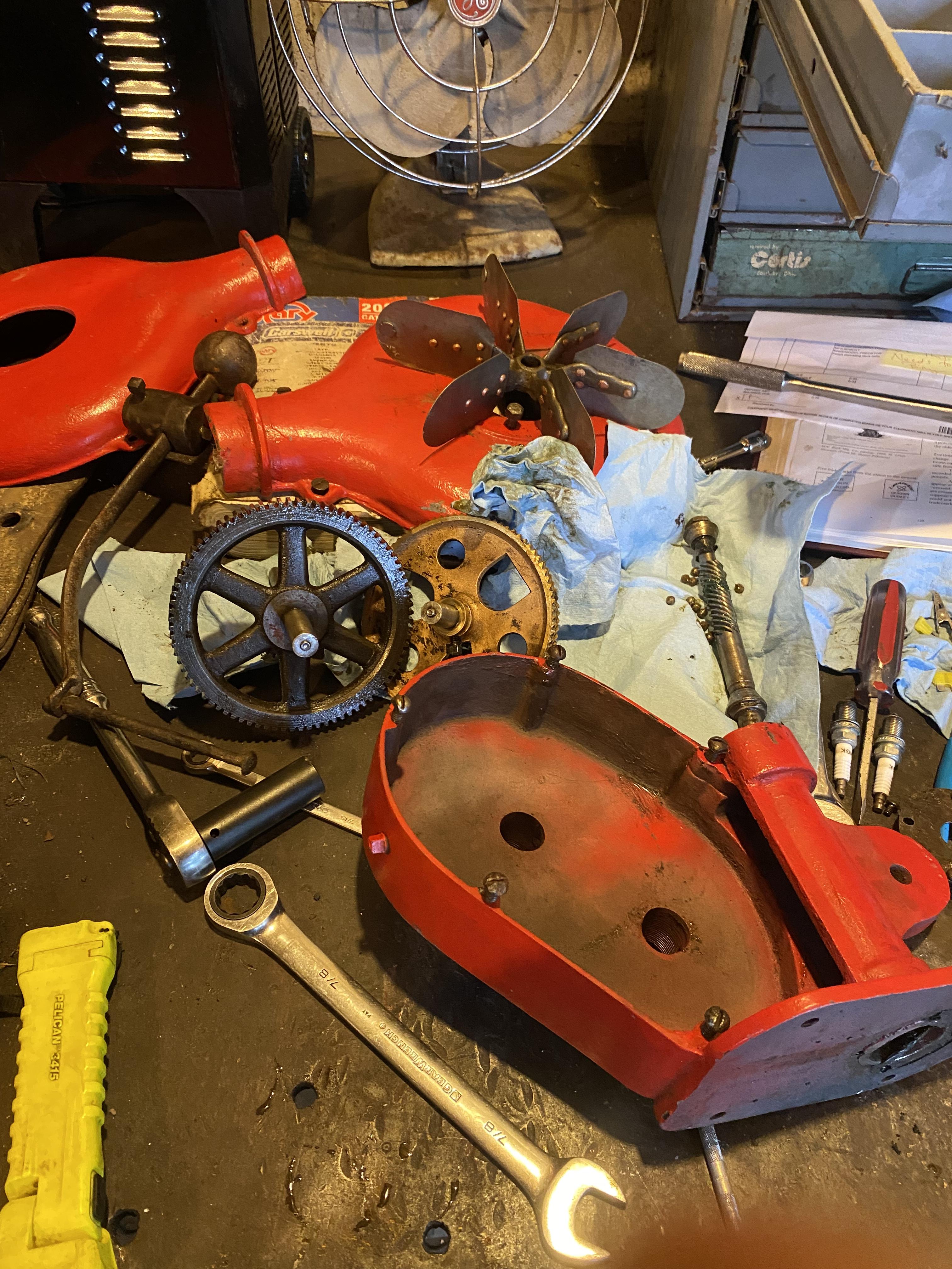

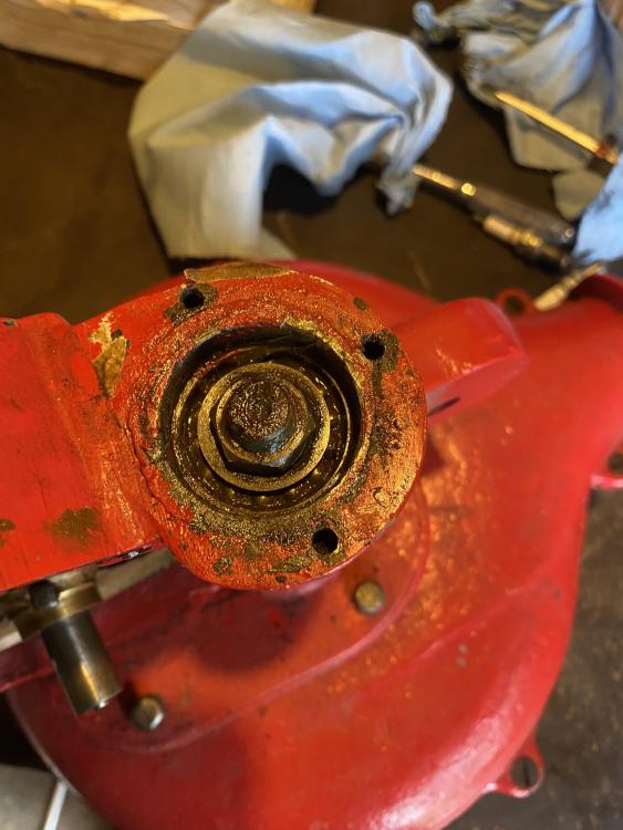

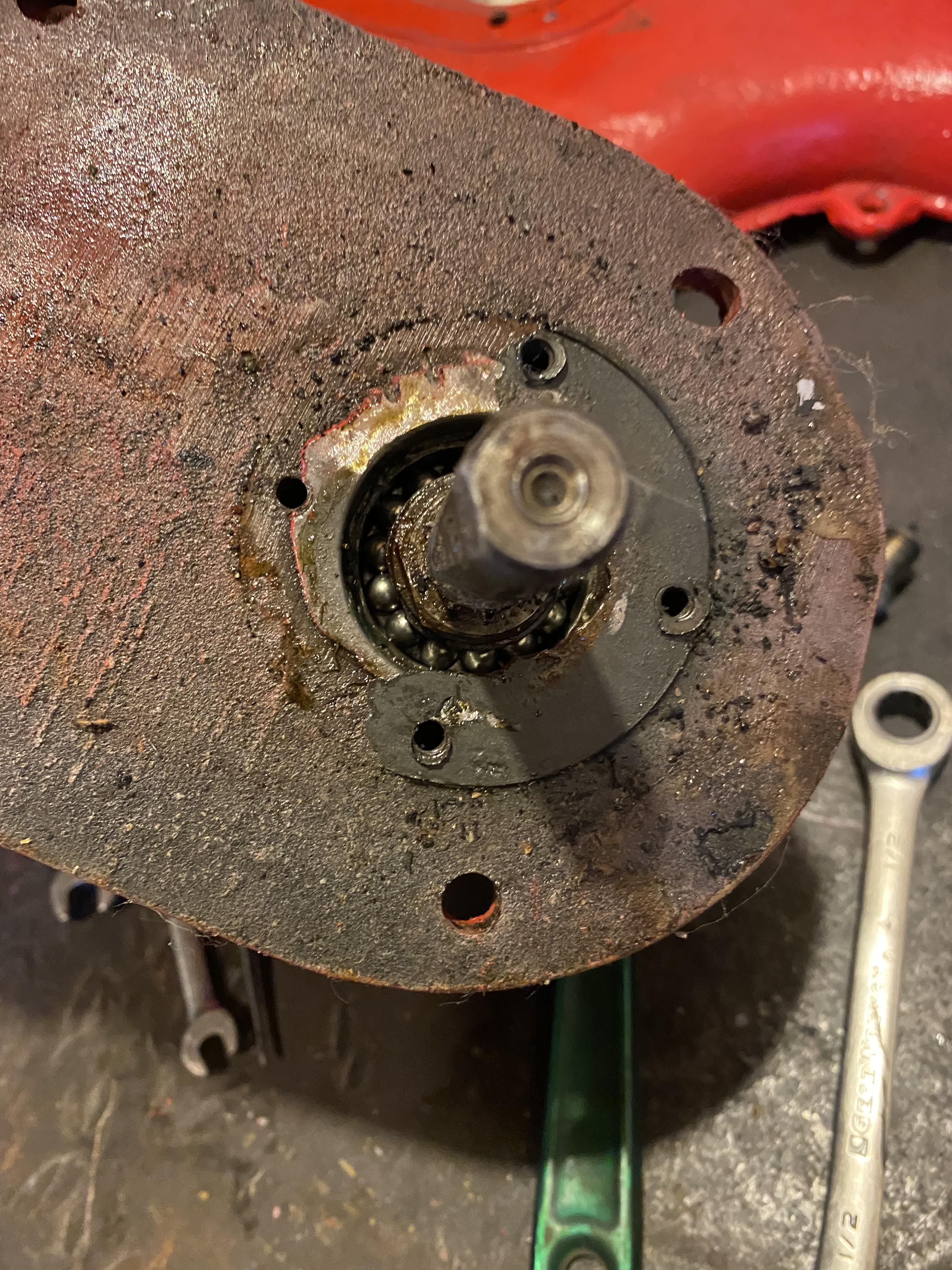

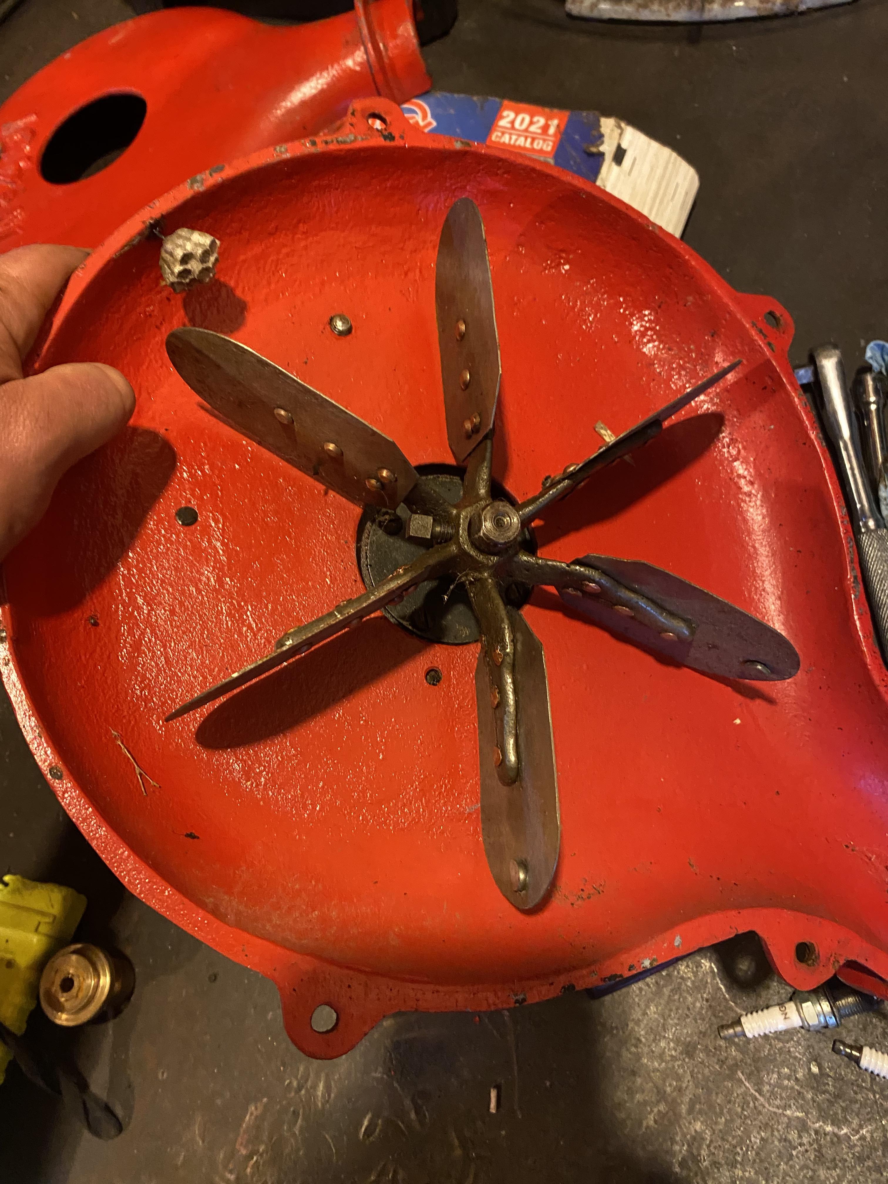

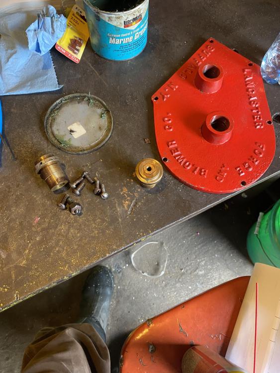

so this Lancaster 401 blower looked pretty on the outside but it growls worse than a junkyard dog,
so I decided to tear it down an take a look at the bearings!…. Well that an i was super curious to see the guts! Lol

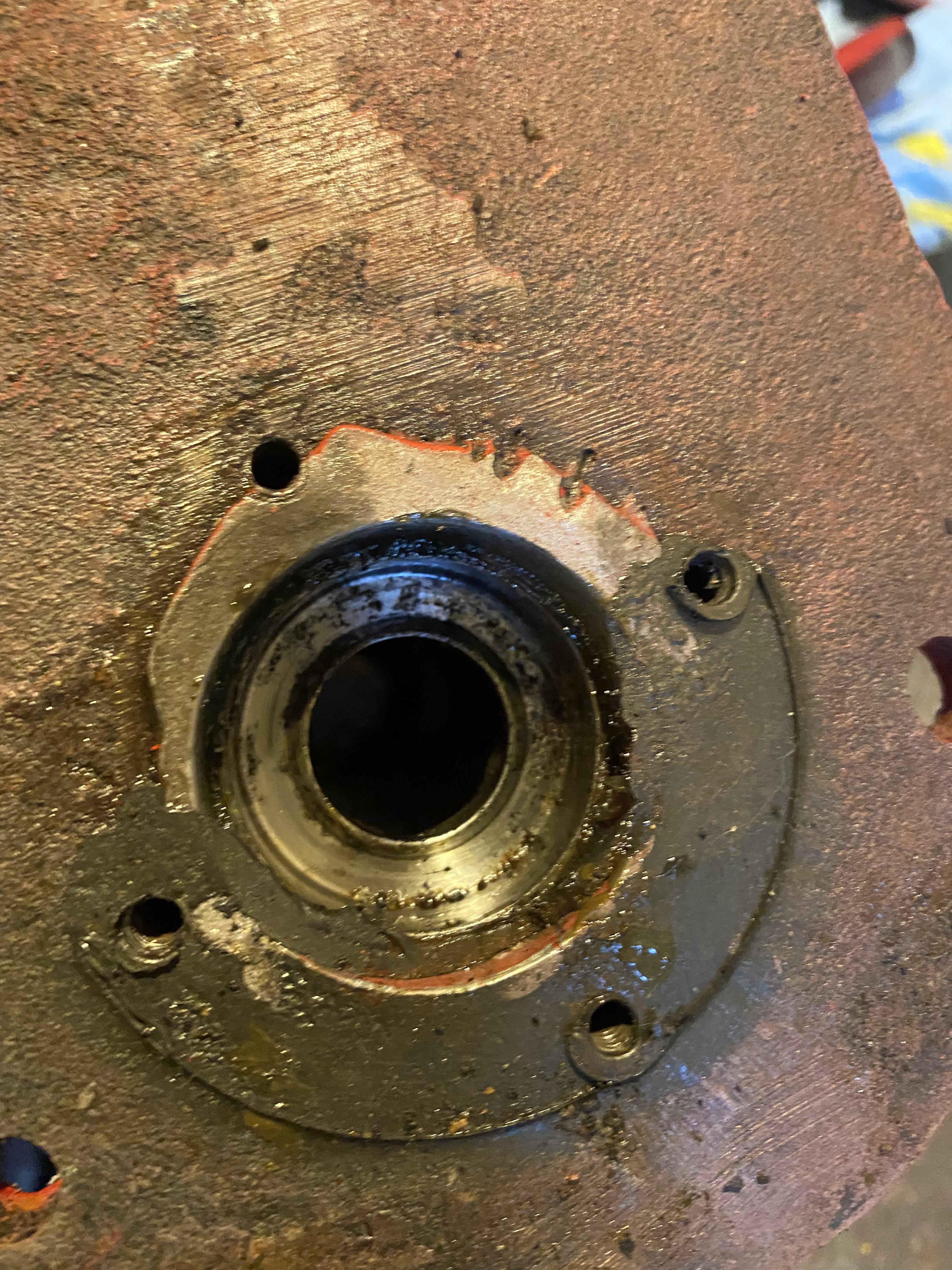

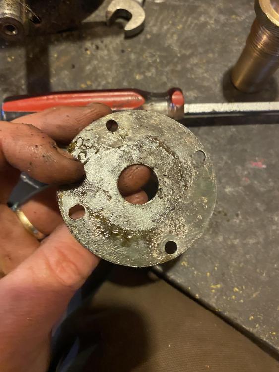

turns out one of the bearing cups/races has some pitting in it,
Ended up having 14 ball bearings per side
ill have to do figure out how to get the cups out without breaking them, so I can measure an find some replacements,
If I can’t find anything to replace them then I’ll just re assemble it and add a little grease to quiet them down
The gears look pretty good especially the bronze one, which are bad to wear out. I have smoothed out bearings by packing them with grease that I added powdered graphite to. Still need a little oil for the gears though.

I wasn’t timing myself but just guessin I’d say maybe 20-30 minutes to tear it down?

but I know what you mean, I recently took a champion 400 in on a trade, that someone had completely dissembled and threw all the parts in a bucket an never got around to rebuilding it…<_<
I’ve torn down blowers before to clean them out and get ‘em movin again,
it takes a lot longer to clean one out then it does to take em apart an reassemble,
if I ever have to pull a gear off a shaft I always mark it before removal so I can put it right back where it came from,
I found out long ago slow is fast an fast is slow,
if you get those gears outta wack you’ll be there half a day adjusting them back an forth till you get them right again,
And I rebuild stuff for a living with years of experience!
even I have got over my head on occasion with workin on old an unfamiliar machines,
so I wouldn’t suggest that most folks attempt to tear down old machinery,
if someone don’t feel comfortable rebuilding, just flush it out instead an keep it oiled,

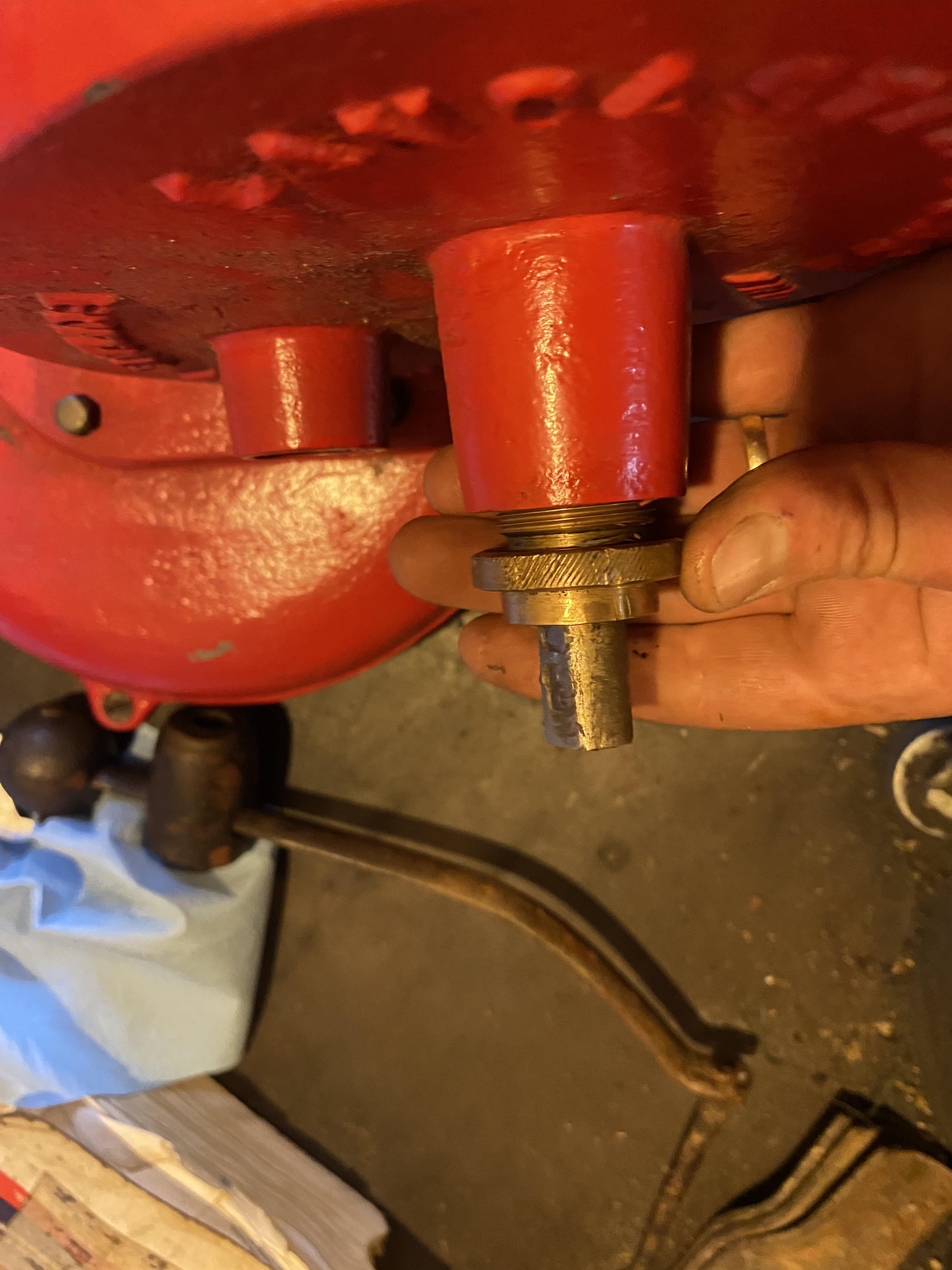

now on another note, I really like the brass carriers an the shaft adjustment screws on this one! It’s a good design!

I've acquired a similarly-marked Lancaster blower.  Mounted on a tripod stand.  Just the stand and the blower, nothing else attached.
My unit has some differences from the one described here.  The ends of my blower shaft are covered by screw-in brass caps.  The blower wheel blades and spider are a sheet metal assemblage welded to a hub.
It is missing the brass bushing on the crank shaft, the non-handle side.  That bushing seems common design with those on the secondary gear.  I jammed a PVC pipe fitting in there for the moment.
The blower shaft turns, but rumbles like crazy.  And occasionally it jams.  I'm guessing flat spots on one or more bearing balls.
The crankshaft and secondary shaft bushings are very loose.  Assuming this is wear.  I set their adjustment screws snug.  Gears feel ok, look ok.  I've had the gear box open, inspected, not cleaning it yet.
What might my luck be were I to replace only the bearing balls?
