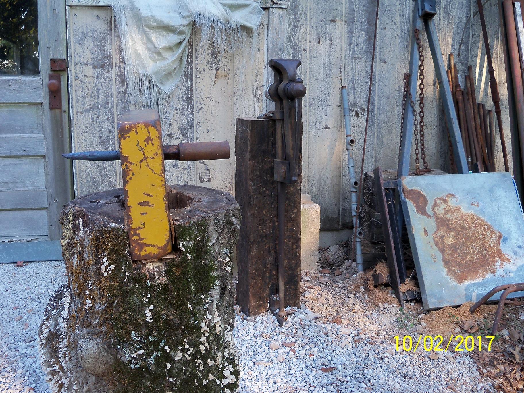

The real thing in anvils has been around for over 3,000 years, loooong before the advent of London pattern anvils. Japanese master sword makers used a block of steel as well as the Vikings. This is an improvised 110 pound anvil I picked up for $30 U.S. and I can do anything on it that I can on my 3 other London pattern anvils. Think bulldozer they are made from anvils.
What he said, the London Pattern Anvil is only around 300 years old and was used in a relatively small area of the world.  The "block of steel anvil" is about 3000 years old and was used everywhere.  Which one is "real"? Note; if you don't like it, you are not out much money---and will get some back when you scrap it!)
