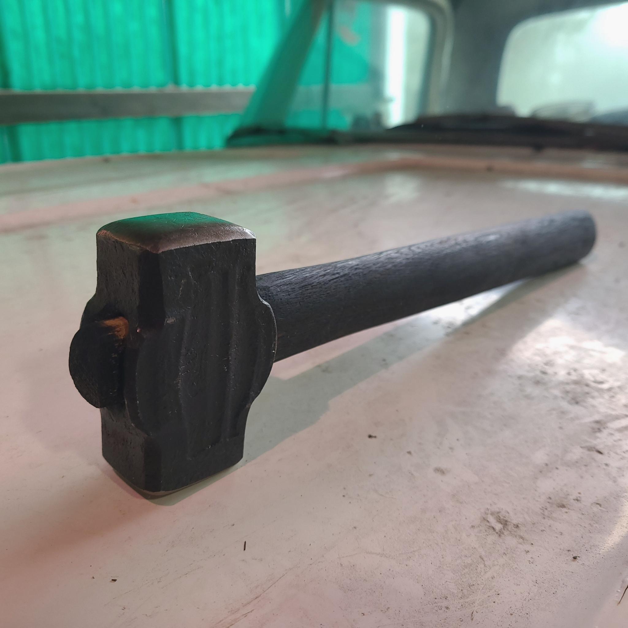

Yesterday I ventured up to Portland to visit Andrew of Portland Ironworks at his shop for a private lesson on tool making. Where he shared some insights to his process and techniques on some of the machines.
We set out to make the hand tools necessary for making hand tools for use at the anvil independently and with a striker. We decided to start with the tools for making handled top tools and hammers.

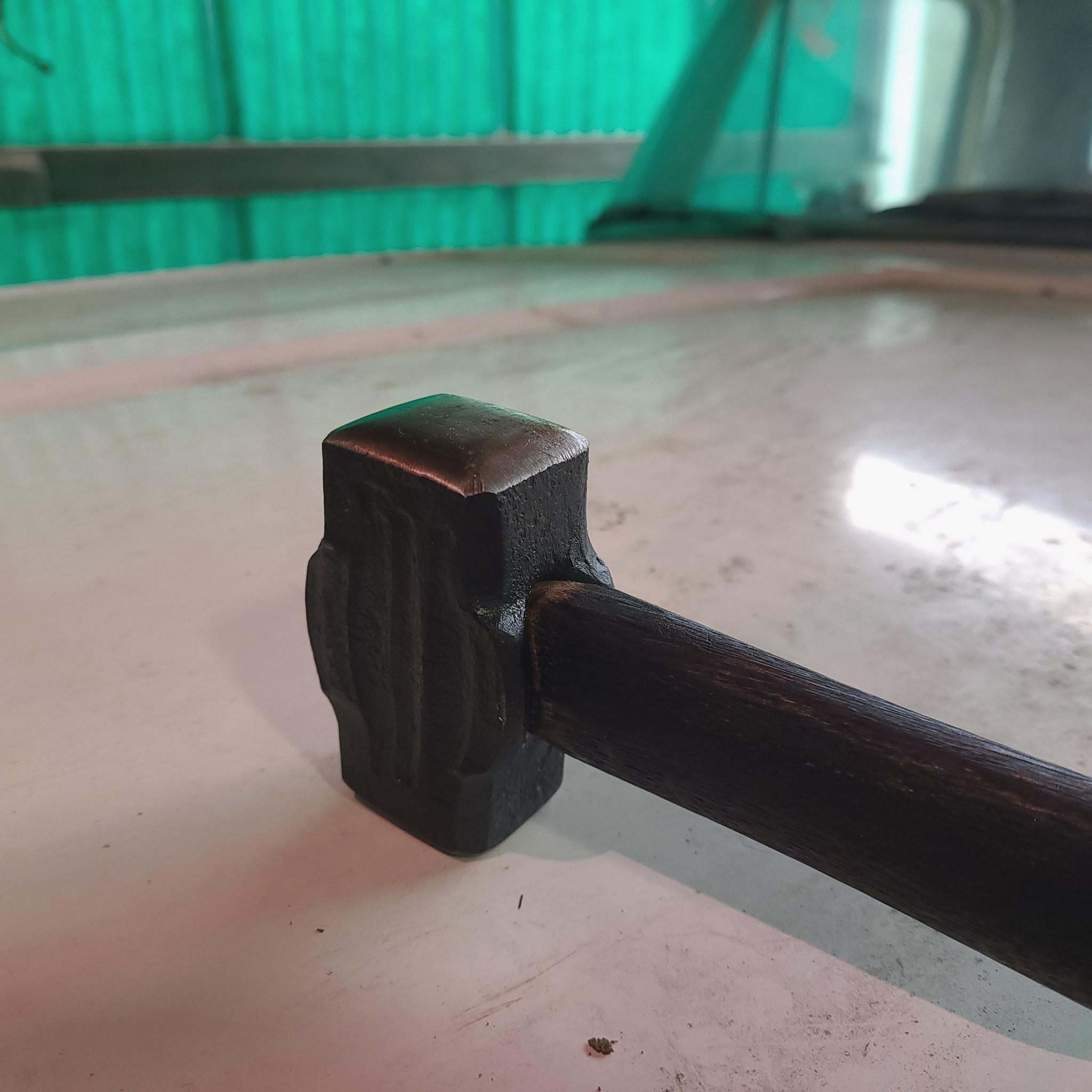

After running through the processes a handful of times on the machines, and after a quick BBQ lunch break Andrew handed me a piece of 40140  4140 and with a little bit of guidance and a watchful eye cut me loose on the Coal Ironwors 25ton forging press and the air driven 55lb powerhammer. Time to make a top tool. I decided to keep it simple and make a set hammer.
Used the press to punch the eye, and fuller the cheeks. The powerhammer to form the striking and struck ends. And the drifting of the eye was done at the anvil.
At the end of the day we had filled out my tool collection with a set of top fullers with opposing orientation, a bottom fuller to match all from 4140. A handled hotpunch made from H13. A hammer eye drift. And a set hammer.
It was a super awesome experience,  and really nice to be back in a workshop making things.

IronDragon, just to be clarify, the only tool I made from start to finish was the set hammer. Although I did get to work in on a few of the processes on the other tooling as well.
The amount of experience was worth it alone, the tools are the bonus as i see it.
Ps. Having all those nice machines sure helps speed up the process of tooling up.
