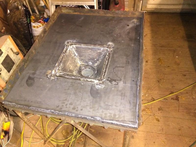

Replace top on forge table, then the "Might as well"......
The "might as wells";  you know, when you start a project, and once started, while your there you "might as well" go ahead and....
Well my forge table was getting in rough shape, it's just sheet metal salvaged from an old water heater tank.  So I asked around, and got a piece of sheet stock, 5/16" thick.  It was free, so that's what I used for the table.  Well, there was enough left over to make a new fire pot as well.  It's quite a bit thicker than my old fire pot, which was 3/16" thick.  I didn't really need a new fire pot, but while I was there ......
  I decided to keep the size of 8"x 8"x 4" deep. But changed the slope of the sides, by changing the bottom from 4.5" square, to 3.5" square, (it came out closer to 3") with a 2.5" tyure.   This will be my third fire pot.
First 3 pics are the new table, with fire pot bits cut, and ready to weld up, top done, and tyure.   Next pic #4 is my first ever firepot for coal,  then last pic #5 is the second fire pot.

Nice! If you added a clinker ball to your design, you'd think you died and went to heaven.
Mabe, one day when I get rich enough to afford one. ;)
You don’t have to buy it, take your scrap and make it
