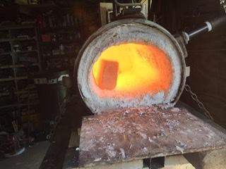

I used the Hellcote on my current forge and it worked real well. My ribbon burner set up has two layers of 1” Morgan Ceramics, Hellcote in between and on the inside. I have been hitting welding temp with about 5-7# on my propane regulator with no problem. The picture is before I put the door on. 871013FE-DE47-4210-A9D4-FAC43BEAEA00.jpeg.085f88d244a929fa798036f0721c1fb2.jpeg
