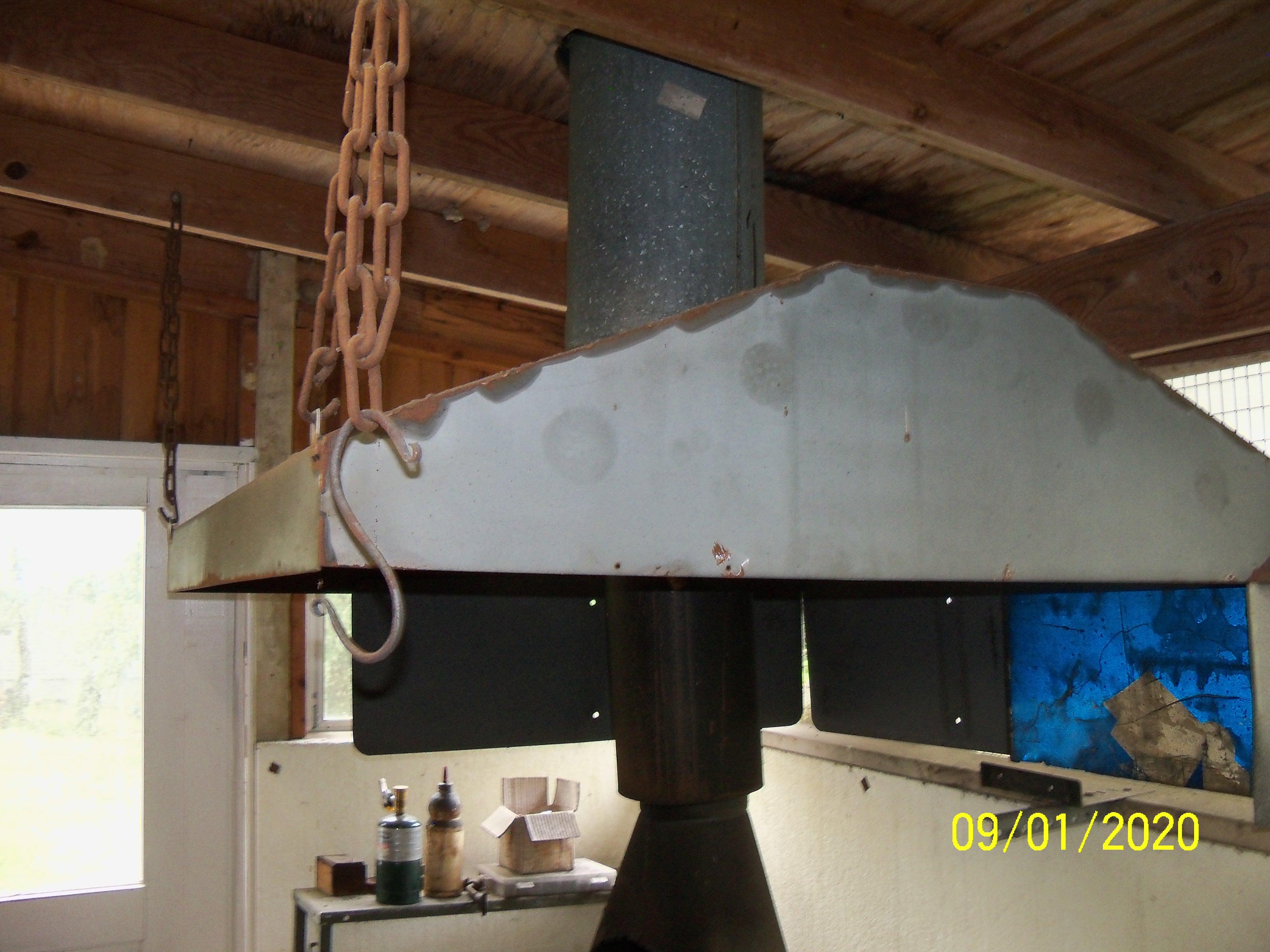

My chimney does go from 8in to 10 double wall then up through the roof and it works well for me.
I just found a thread about the stack size and I have my pipe sizes here wrong. It's 6 in from the hood to 8in. This may help.

add picture and thought
I agree with Glenn. You wont get the full performance of a 10 inch stack no matter what you do. However, if you go this route, make sure the opening on your side draft is sized for the smallest diameter of pipe in your stack.
