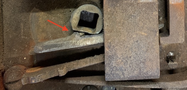

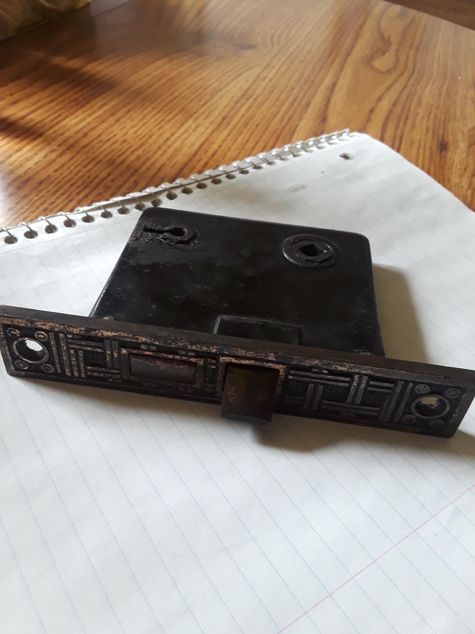

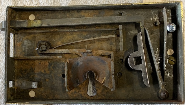

I'm aspiring to repair an old broken rim lock in our house. The internal part that turns when one twists the doorknob has broken in two:

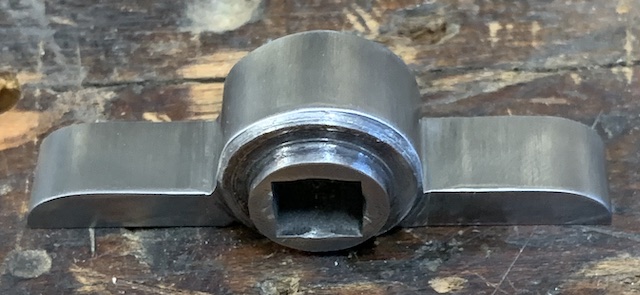

That lever is supposed to be attached to the hub at the arrow. Here's what the part looks like in a good lock:
The part is firmly fixed to the lock's base plate, although it rotates - there are no other parts holding it in place. On the outside of the lock you just see a rotating ring, flush with the face of the lock:

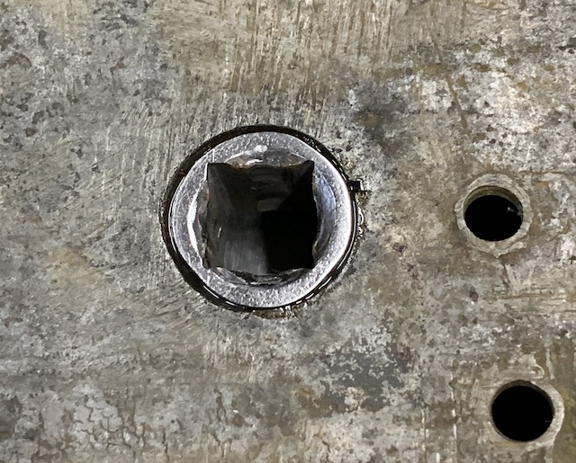

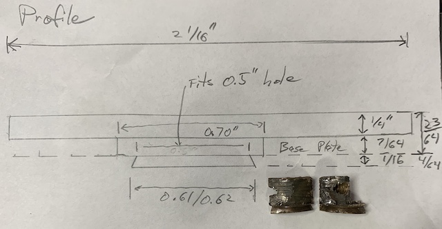

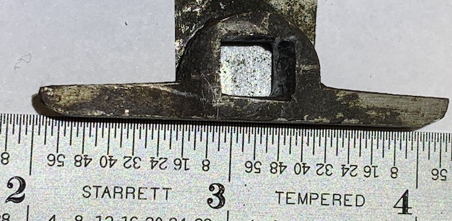

Dissection was required. I cut the broken hub in half to figure out what held it in. Turns out it's a glorified rivet:

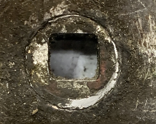

The hole in the lock base plate is chamfered: it's 0.5 inches on the inside and 0.6 inches on the outside. Obviously the half-inch part was inserted, peened to the shape of the chamfer, then ground flat. I haven't done this before, but probably can figure it out.
But the question remains: How do I make sure the riveting job rotates when I'm finished with it? It does me no good if I peen it so tightly you can't turn the doorknob...

The overall mechanism is both. The part in question belongs to the latch side of the contraption. Doorknobs are attached to a square shaft which passes through the middle of the part. The part's arms push on the actual latch to move it.

There is a circular indentation around the edge of the rivet end.  I would guess some sort of rivet header was used. Maybe one with a square tenon to fit the square hole to keep from deforming it when struck and to be used as a handle to free the rivet so it spins?

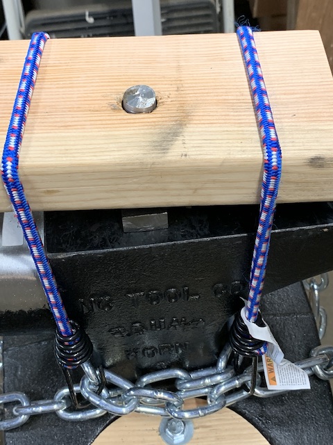

I decided experimenting on something other than the real lock might be bright idea. Steel cover plates for electrical boxes are the right thickness, so I drilled and chamfered holes in a few. The stunt double for the lock part was some 3/4-inch rod on which I turned a 1/2-inch end and drilled end-to-end the same size as the doorknob shaft hole.
Then I started hammering. Peening worked, but it was pretty ugly. What worked best was a mandrel with a short taper to expand the "rivet" from the inside. It's the mandrel on the left:
Crafting the part involved a bit of cutting, turning, broaching and filing, but no hammers. Sorry.
So the part goes in the lock shell, poking through its hole. A piece of bar acts as a backing plate as there are other parts attached to the shell that need to clear the anvil. A block of wood with a hole keeps the mandrel vertically aligned. And bungee cords keep the whole assembly from wandering around the shop. (I knew I put those chains around the anvil for a reason!)
A single, healthy wack with a 3-pound hammer did the trick:
