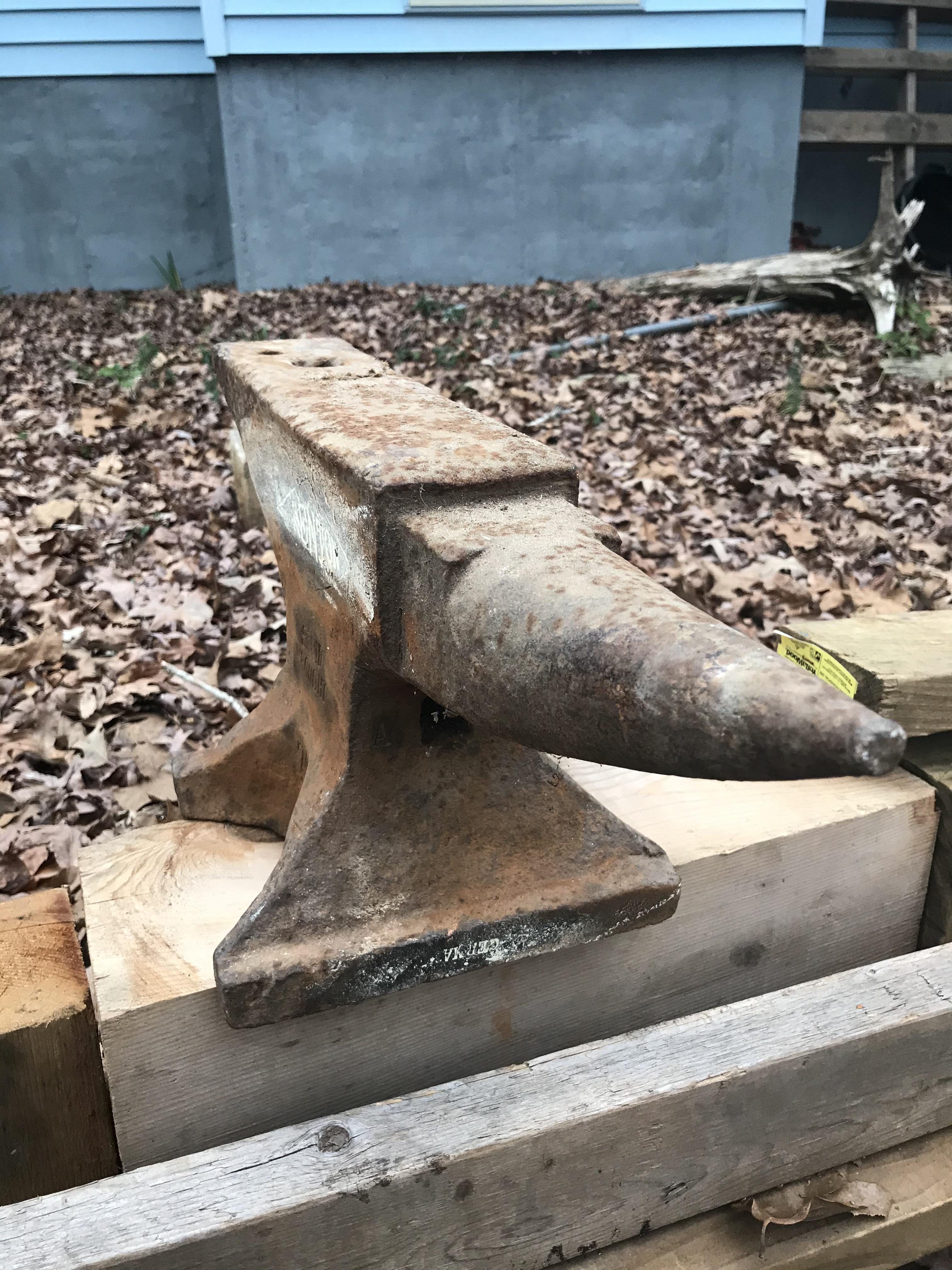

WeGone Posted February 4, 2020 Share Posted February 4, 2020 (edited) Dug this out of my barn, Any help to find out its age. Thanks Edited February 7, 2020 by Mod30 Resize large pgotos. Quote Link to comment Share on other sites More sharing options...

CtG Posted February 4, 2020 Share Posted February 4, 2020 That is fantastic! Family heritage is always intriguing. Any evidence of what looks like a serial number? Quote Link to comment Share on other sites More sharing options...
WeGone Posted February 4, 2020 Author Share Posted February 4, 2020 I'm a complete newb here so what end or were would I need to clean to find this. Quote Link to comment Share on other sites More sharing options...
ThomasPowers Posted February 4, 2020 Share Posted February 4, 2020 Usually on the front of the foot underneath the horn. I don't remember if the German Trenton's had them though. I can check "Anvils in America" tonight. Quote Link to comment Share on other sites More sharing options...
WeGone Posted February 4, 2020 Author Share Posted February 4, 2020 I have cleaned the base with a wire brush and the only markings I can find are pictured, as you can tell it was well used. My son and i would like the start forging small knifes with it hopefully. Quote Link to comment Share on other sites More sharing options...
ThomasPowers Posted February 4, 2020 Share Posted February 4, 2020 Remember, while it's ok to wire brush the face of an anvil; any grinding or milling on it is considered extreme abuse! Pounding hot steel on it will polish the face after the loose rust if brushed off. Quote Link to comment Share on other sites More sharing options...
WeGone Posted February 5, 2020 Author Share Posted February 5, 2020 Thank you, no grinding or filing will be done. The rust is all very light, surface only. looking forward to the 3rd and 4th generation to pound on it. Quote Link to comment Share on other sites More sharing options...
WeGone Posted February 5, 2020 Author Share Posted February 5, 2020 So did some more clean-up with a wire brush. did not find any new markings, but it does have a nice black look now. I did a lot of research on the web could not find any information or pics of the Germany stamping on the front? Any ideas? Also have not found anything leading to it's age. late 1800's to early 1900's ?? Quote Link to comment Share on other sites More sharing options...
ThomasPowers Posted February 5, 2020 Share Posted February 5, 2020 Is your local public library able to ILL a copy of "Anvils in America" by Richard Postman? If so you will find it contains pretty much all the known info on Trentons currently available. Quote Link to comment Share on other sites More sharing options...
WeGone Posted February 5, 2020 Author Share Posted February 5, 2020 I'll check at our local library. and thanks again for all in help you have been providing. Should I try to address the top edges as the have a bit of roll? If so how? All I plan on using it for is knife making. Quote Link to comment Share on other sites More sharing options...
CtG Posted February 5, 2020 Share Posted February 5, 2020 Try using it as-is for a while, see what gets in your way. Super crisp edges can be problematic. That's a good looking piece to be sure. Quote Link to comment Share on other sites More sharing options...
ThomasPowers Posted February 5, 2020 Share Posted February 5, 2020 Sharp edges will definitely be a problem for knifemaking as they create cold shuts in the material as it's forged. If you need a sharper edge for a specific task it's easy to make a tool for the hardy hole that has the edge needed. (In fact with a bit of care you can make a tool that has 4 different edge geometries and can be placed in the hardy hole so that the one needed is to hand.) I have a 139 year old book that states that anyone thinking they should have sharp edges on their anvil just doesn't understand how blacksmithing works. PLEASE DON'T mess with your anvil's face until you understand how blacksmithing works! Quote Link to comment Share on other sites More sharing options...
