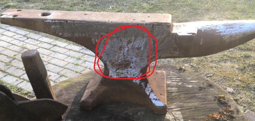

I just purchased a 175 pound anvil it has a sharp notch on the side of the horn and two Pritchett holes it’s 33 inches long someone said there was a hay Budden anvil made like this on the base there are the numbers 175 space then 133801ill send a picture of the numbers and anvil this is welding rod
Farrier's anvil. The bit on the side of the horn is for hammering clips into horseshoes.
This is not a HB, this is a Trenton (Columbus Forge & Iron).
Please post a closeup picture of the side of the anvil, horn facing right.
Here’s the picture I’m not sure if this is the one you need
thanks, a closeup of the logo stamp area would be great to see if there are any remnants of the original stamp visible.  This area:
There is a definite 0 stamped in the side just right of center you can see it in the picture if you zoom in thanks black frog for the reply
