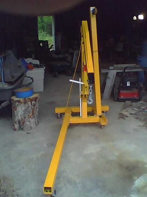

The first picture is mine from the front, one leg is folded up, both fold up to store and pin down for use. As you can see it has very small wheels and is hard to roll unless the floor is swept clean. It was made this way so it will fit under an automobile, some of ours are close to the ground. Every time I've rolled it in the shop I've considered buying larger rubber wheels for it.

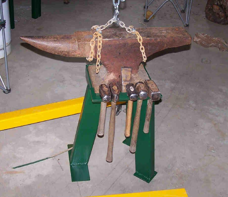

The second picture is my anvil rigged to lift into the back of my pickup truck with the engine hoist. I don't have a picture of the whole hoist from the side that I know of. I included this one to show where the load hangs from the boom when the boom is extended full length. The first picture shows the boom at it's shortest, in the short position it will safely lift 2 tons or 1,818 kg. Fully extended it will safely lift 500lbs. or 227 kg. The load is centered about half way down the legs with the boom in the short position.
I bought this at a garage sale for about 1/4 the new price and it'd only been used once. One of my favorite garage sale purchases ever. If you get one you'll never know how you lived without it!
