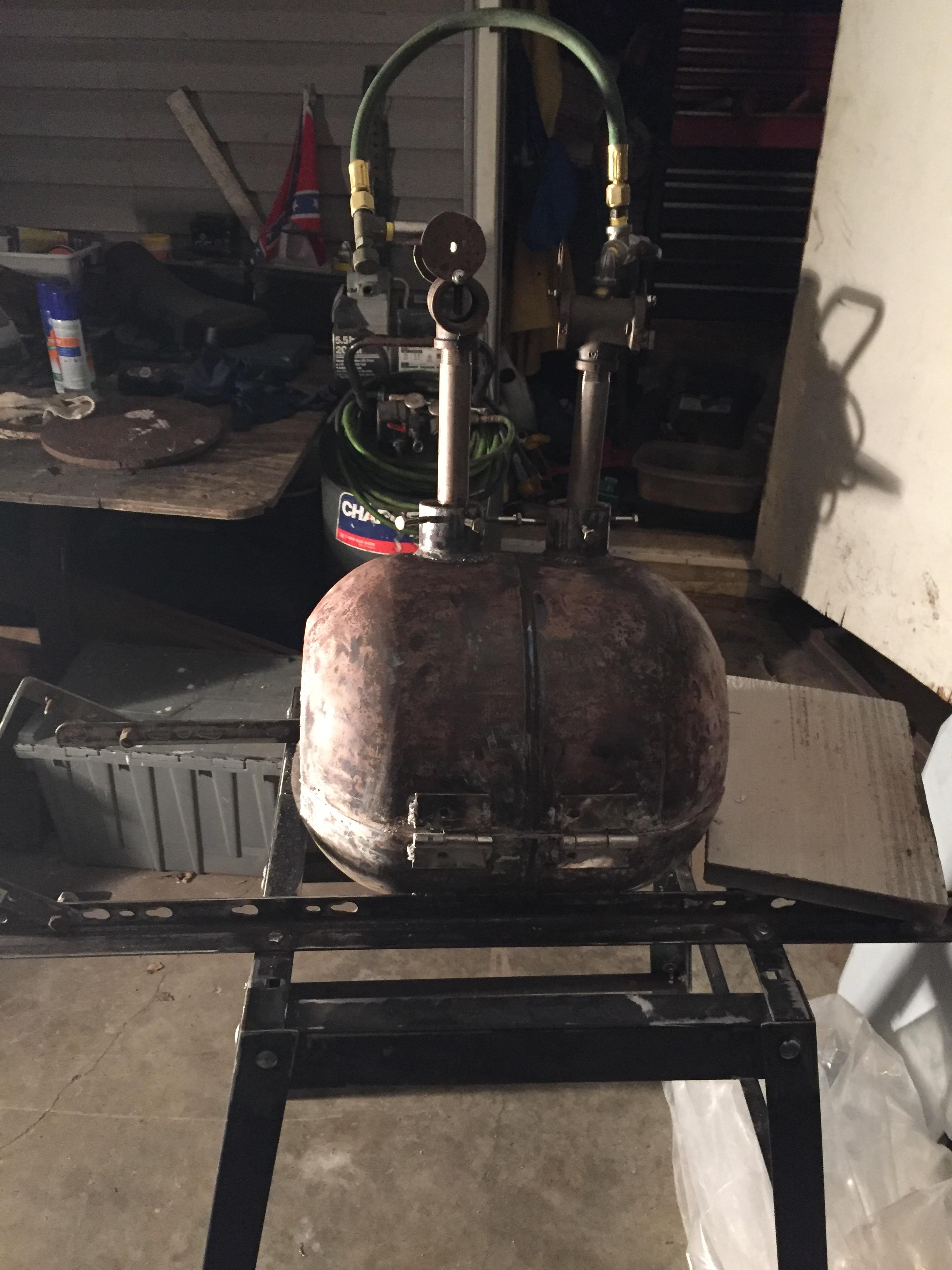

First propane forge
Finished my first propane forge today. Followed Mr. Wayne Coe forge plans and supplies. Kao wool, Kast-O-lite 3000 and plistix. Also followed Frostys t-burner plans.  Two 3/4” T-burners. What do y’all think?  Please critique and tell if I am missing anything. A 1” piece of square stock got to a good working temp (glowing orange) in around 7 minutes. Propane regulator was set at 6 psi.  Will post pictures of the flame as soon as I can.

They are both showing up just fine. I just didn't scroll down my screen far enough to see the action the first time. If you are wondering about the lack of replies, The equipment photos are too dark to see much detail, and the flame photo and video show really hot forges, so there isn't much for people to comment on, accept to congratulate you for a good job the with your first try :)
Sorry been a little while since I have been able to get back to the forge.  Here are some pics of the flames and the forge once up to temp about 6 minutes into the session. Very nice Aubrey good job I am also just starting out also.

Aubry your forge looks good. My suggestion is to move it outside when running, especially if the garage is attached to the house. Propane forges emit CO which is odorless & tasteless and deadly. CO will infiltrate the house and CO poisoning is nothing to take a chance with. Make sure you have CO detectors working.
These further photos only confirm that there isn't anything with the flame, or insulation of the forge to be improved, However, you need to address the lack of a hard refractory or kiln shelf floor, or you're going to have damage pretty soon. At this jpoint, your best choice would be including a cast refractory floor of Kast-O-lite 30. You can buy a small bag for the purpose from Wayne, a member of this group. You should also get some Plistix from him at the same time, to protect the the rest of the insulation from impingement from forge atmosphere.

You need working CO detectors  If the forge is in an unattached garage. The cylinder belongs outside such a garage, and all other fire safety procedures should be follows as well.
Thank you for replying.  I wasn’t sure if the flame was correct are not.
That flame is "a thing of beauty, and a joy forever." It is a little embarrassing to confess that we on IFI are not used to dealing with such a great first effort. If you had only posted the typical mess for us to sort out, you'd have gotten a stronger response :)
