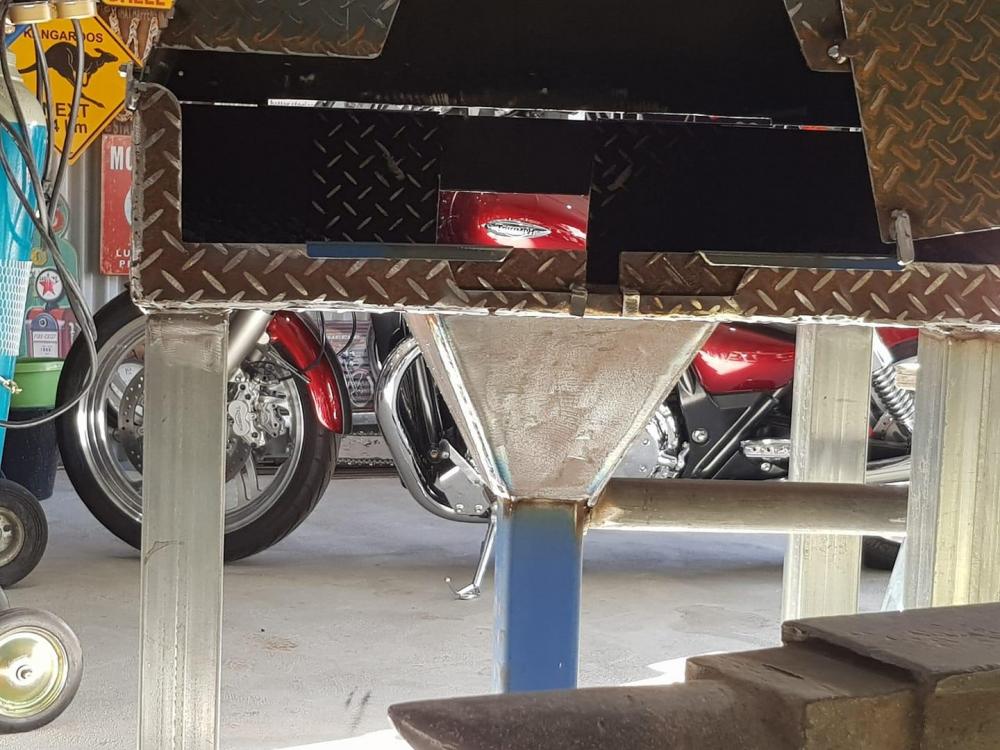

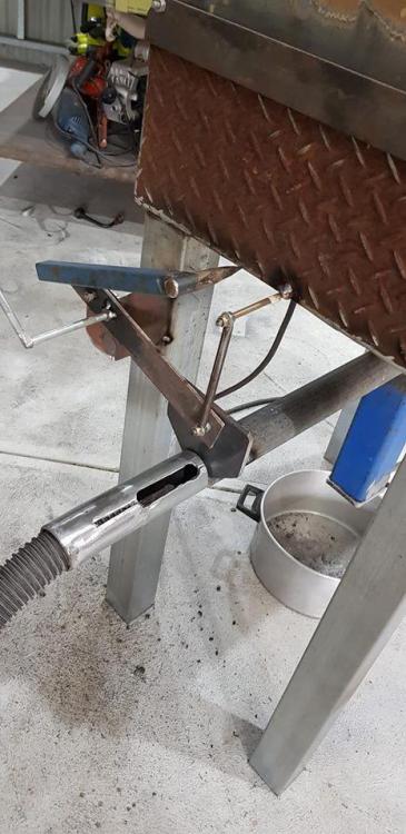

A good way to think of it is a pipe cap, threaded side down, with a hole drilled in the top.  The hole is for the air to pass through.  The dome shape of the cap then encourages ash and solid impurities (clinker) to form in a doughnut shape around the cap while leaving the air outlet open.  Periodically the doughnut shaped clinker mass can be relatively easily fished out with your fire rake or other such tool and discarded.
