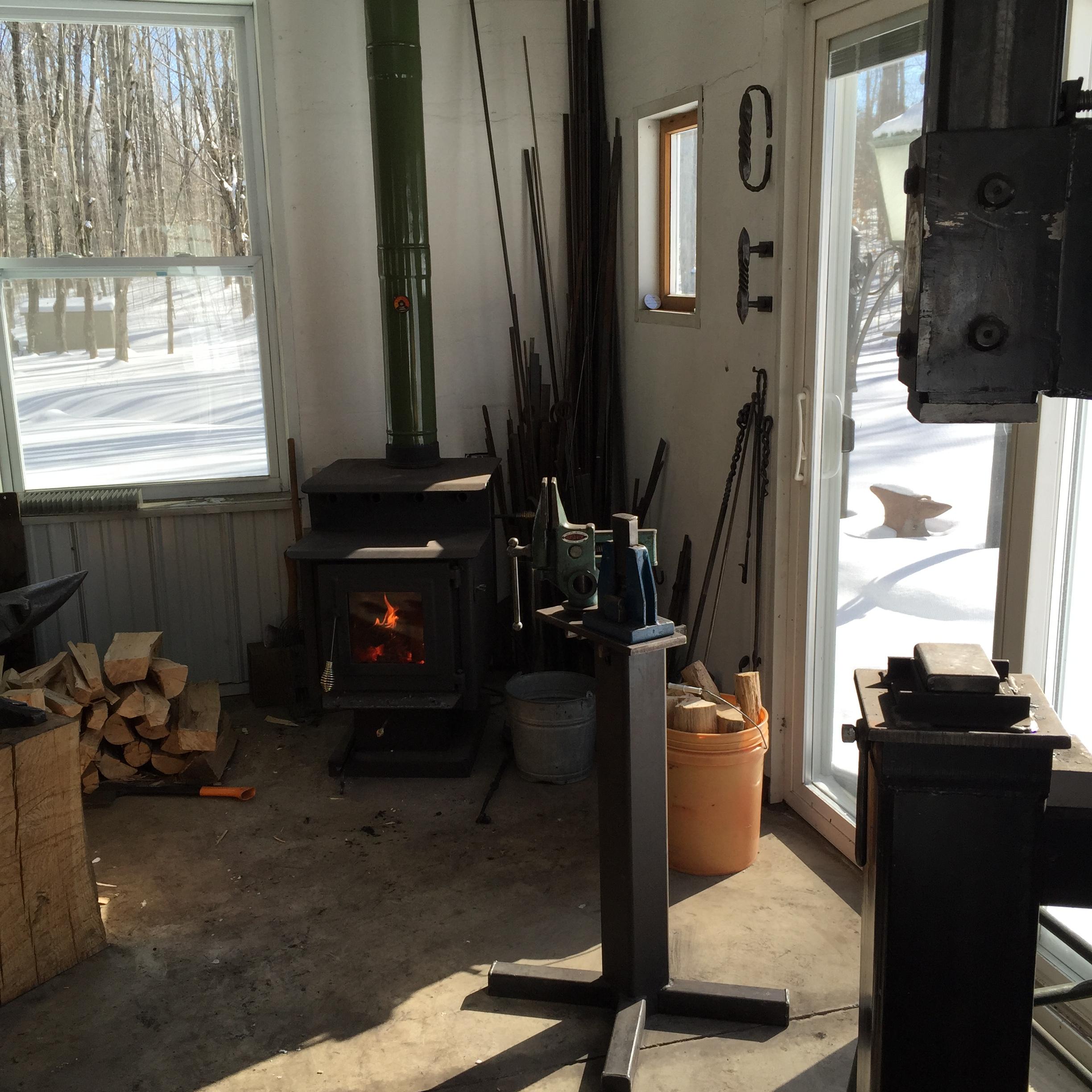

     ( IMHO )  I think it would be best to find that chunk of RR track than use your welding skills to fab up a free standing stand for hardy tooling ... Lots of scraps available... You can also make up a vice block for some hardy tools...   Most of us let’s say older more seasoned smiths would agree with that combination of equipment we could get along just fine..
