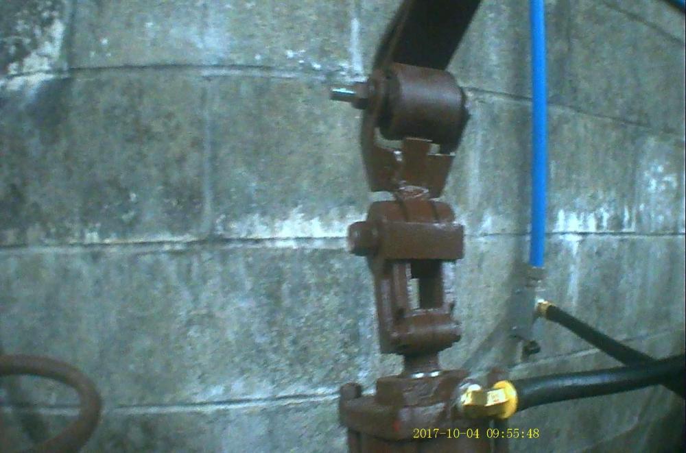

So the air piping from Northern is installed, and the parts I ordered from mcMaster-carr came as well. I opted to get a dual air solenoid operated main valve, Norgren MN01CGA23A000, actuated by two Mead Fluid Dynamics LTV-20 mechanical air solenoid valves. I looked for some simpler solenoids, but couldn't find what I was looking for. The LTV-20 has 5 ports, so i am a bit confused as to how to plumb in the valve. As far as i can tell, port 1 is for the air supply from the compressor; 2 and 4 are for supply from the solenoid to the cylinder; and 3 and 5 are exhaust ports. The LTV-20 is actuated mechanically in only 1 direction, as it has a flipper lever that allows the ramp to bypass it without actuating it in one direction.  It may be simpler to run the hammer with only one solenoid valve, and fix the lever to actuate in both directions. otherwise, I will need to figure out the plumbing arrangement for two of them.
I did some testing today with the main valve hooked to the cylinder and saw an issue with the linkage between the cylinder and the leaf spring; I need to make another linkage that will not toggle so far.
This link allows the ram to travel up farther than the spring eye, and whips back when the cylinder retracts. I am going to make another piece with "ears" that will wrap around the yoke of the rod end to limit the movement; the effect may be due to the testt lacking the solenoids to control the  extent of travel, but it seems a prudent fix to make.JPG00003.JPG
Rather than make a whole new piece, i welded on a strap on the back of the existing toggle, which solved the over extension and whipping issue.

As to the cycle rate, i do not know; maybe 120 bpm? I have not seen any home made mechanical hammers that match what air hammers with appropriately sized cylinders do; also some tend to be a bit unstable due to the eccentric motion. The air hammer arrangements tend to be linear in 2 directions; also it seems they hit harder than just the falling weight and speed of the ram generates. I chose the helve style for ease of build since i am using scrap iron; also i have limited overhead room. These are just opinions, backed by experience with a 100 Little Giant mechanical hammer, a Bull air hammer and a Phoenix air hammer, plus watching other builds on video.
In this orientation of the spring, there is a tendency for the ends or eyes to get a little more separated by the extra pivoting or slop from the flex. you could shrink a collar onto the whole bundle ends or feather them out with lock collars..  Or use it and see if any of it needs to be done.
