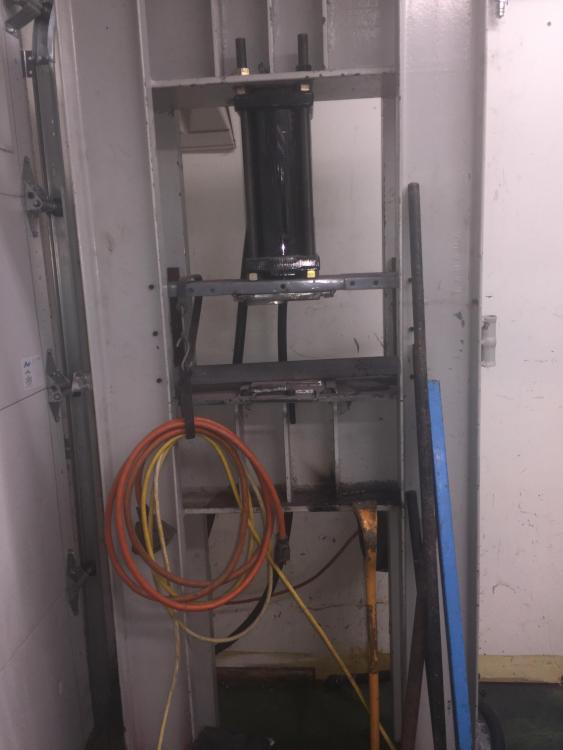

Jspool Posted June 13, 2018 Share Posted June 13, 2018 Heres a poor pic of my 20 ton press. Kind of a split H frame as I can also feed from the side. Top and bottom I beams run to the outside and are just welded to the verticals. Been in use for 25 yrs., mostly in a factory for cold punching before I picked it up. Not complicated. Link to comment Share on other sites More sharing options...
