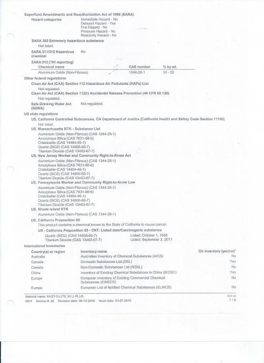

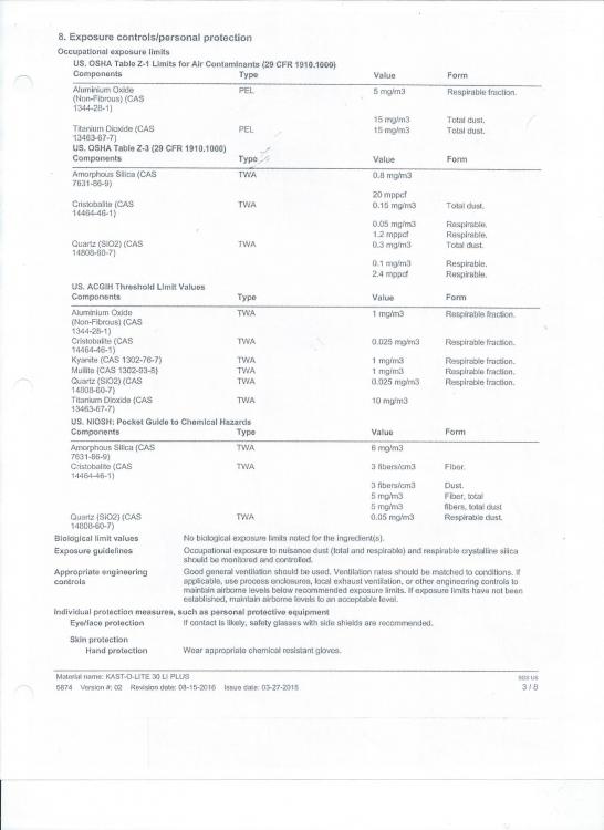

paulgatx Posted May 23, 2018 Share Posted May 23, 2018 Hi all, next step in my forge setup is to apply Kast-O-Lite 30 on top of my rigidized Kaowool. Question: Is there any concern (outgassing or otherwise) with doing the initial heat treat of the Kast-O-Lite 30 up to 500deg in a kitchen oven? I've seen various methods (kiln, dedicated shop oven, bulb, fire, low flow burner, etc.) that people have published, but I was thinking to do the initial cure very controlled in the kitchen oven and then do it the rest of the way with the propane burner. Am I crazy, because I haven't seen anyone else post about doing this (perhaps there is a good reason)? And yes, it will fit as it is a very small single burner forge. Thanks in advance. Quote Link to comment Share on other sites More sharing options...
Idk Posted May 23, 2018 Share Posted May 23, 2018 Is this "Kitchen Oven" inside your house and the very same oven you use to cook with? If so, DON'T DO THAT!!! Any idea what's in KOL30? Ever heard of a MSDS? Not jumping down your throat but people need to research topics before asking questions they already have access to the answers. Bottom of page for Manufacturer curing instructions. https://www.iforgeiron.com/topic/52885-another-newbie-forge-build/?page=2&tab=comments#comment-598276 Quote Link to comment Share on other sites More sharing options...
Idk Posted May 23, 2018 Share Posted May 23, 2018 Here's your 1 freebrie. Curing Instructions. Kast-o-Lite 30 Plus MSDS Quote Link to comment Share on other sites More sharing options...
paulgatx Posted May 23, 2018 Author Share Posted May 23, 2018 Hi idk, thanks for the quick feedback. No worries on the perceived tone of the feedback, I'm learning to grow a thick skin on here. :). I did do some research but didn't feel as if I found a satisfactory answer, so I thought I'd pose the question to the experts (materials and smithing) to get more clarity. I do have the manufacturer's curing instructions, which is why I thought of the controlled 100deg/hr capability of an oven as opposed to the less controlled other methods I read about. I had seen this method mentioned in two other places (see attached), including one of the experts here posing it as a hypothetical question (though I can't find that post again). Other than that, I never saw anything saying it's an absolute no-no, so I figure it doesn't hurt to sound stupid and ask again. Glad to did. I did look at the MSDS, though I'm not an expert in reading them so I didn't see anything as outgassing hazards. But again, I very much appreciate the feedback. Quote Link to comment Share on other sites More sharing options...
Lou L Posted May 23, 2018 Share Posted May 23, 2018 The only thing I could find on the MSDS was a vague mention of a cancer risk associated with long term exposure. I don’t remember if it was on the document or somewhere else but it seemed to be specifically about people working around furnaces and kilns using the stuff at the industrial level. I was assuming it was the dust from created by daily use over years. Personally, when I do it, I’m following the advice mentioned by the big dogs and starting it off with a bulb for a few days or more. Quote Link to comment Share on other sites More sharing options...

Frosty Posted May 23, 2018 Share Posted May 23, 2018 When you say cure, what exactly do you mean? Kastolite products undergo TWO cure cycles. The first one is when you mix it with water, first it sets by hydrating. It does NOT dry, it sets like portland cement concrete and then it should go through a proper cure at 100% humidity and room temperature for at least 24 hrs. 7 days is better. Once it's set and cured heat curing isn't a bad idea but 500 f. isn't going to do it. Cure is 900 f. - 1,000 f. A prolonged 1,300 f. cure is desirable in some applications. For what we do cure it at 100% humidity for 24 + hrs. Allow to dry fire the burner for a couple minutes to drive off residual moisture from cure cycle. Bring it to dull red heat and let it cool. Then put it to work. The cancer warning is because some of the aggregate used may contain silicates and all their aggregates are crusher run. Sharp silicates are a known carcinogen so they warn you according to Gvt. regs. Don't eat it and it's kind of base so it can irritate your skin, eyes and such. Frosty The Lucky. Quote Link to comment Share on other sites More sharing options...
